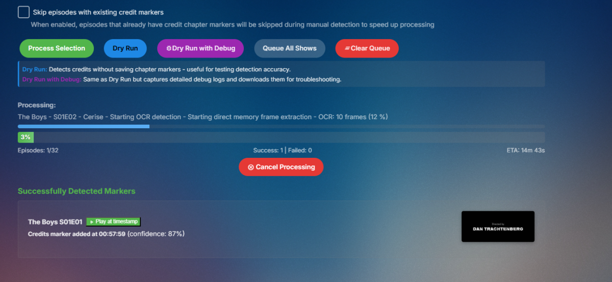

Rykalout 5 Posted January 31 Posted January 31 14 minutes ago, yocker said: @Rykalout This might fix it. I noticed you had spaces in the file paths so might have been the reason. EmbyCredits.dll 682 kB · 14 downloads Thank you for the speed and your help, but however, it did not work, I still have the same problem, I tested with Cyberpunk again, the series The Boys (the one with the logs). embyserver (9).txt credits-detection-debug-2026-01-31T15-39-52.log

yocker 1328 Posted January 31 Author Posted January 31 3 minutes ago, Rykalout said: Thank you for the speed and your help, but however, it did not work, I still have the same problem, I tested with Cyberpunk again, the series The Boys (the one with the logs). embyserver (9).txt 287.75 kB · 0 downloads credits-detection-debug-2026-01-31T15-39-52.log 90.29 kB · 0 downloads Does it work with OCR detection? No need for log, i just need to know if ffmpeg extracts the frames as it should.
Rykalout 5 Posted January 31 Posted January 31 3 minutes ago, yocker said: Does it work with OCR detection? No need for log, i just need to know if ffmpeg extracts the frames as it should. Yep it works with OCR, which is what I prefer rather than using audio etc. like Emby currently does for intro detection, because for Anime there isn't always text etc. at the beginning of the intro, and OCR struggles (at least from what I've tested) with anime.

yocker 1328 Posted January 31 Author Posted January 31 1 minute ago, adamzetpl said: For me this version is the same, what I did notice is Hash detection is to fast (1s per episode) I have not so performant server intel N100. Yes, i think i'm having problems with peoples locales. I can replicate the problem by switching to for example danish in Emby. Using English works. Trying to get ffmpeg to do what i want atm.. Working hard on it.
yocker 1328 Posted January 31 Author Posted January 31 New version up (v1.8.5.0) on yocksers/EmbyCredits Github. Fixed: Hash detection now works with people using other locale than english. Files on Samba shares now work correctly when doing detection. This should fix the problems some people were having. 2
