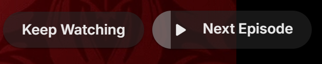

yocker 1328 Posted December 24, 2025 Posted December 24, 2025 (edited) Tired of seeing end credits before Emby loads the next episode of your favorite TV show? Now you can remove that iritation! EmbyCredits detects those end credits and add a marker for Emby to use so end credits can be skipped. https://github.com/yocksers/EmbyCredits This is either by done chroma fingerprinting and comparing the episodes or by the plugin extracting png/jpg images of the TV show, sending them to a tesseract docker container, the tesseract finds a match and reports that back to the plugin that then adds the skip to Embys database. Emby then shows a "Keep Watching | Next Episode" when it sees the marker. Requirements: yock1/embycreditocr installed if OCR detection is wanted (recommended method). In the plugin you add the Tesseract server IP: IMPORTANT!!!!! As the plugin extracts a lot of images it needs a custom folder to do this as to not fill up Emby docker disk images so set this setting: Then add some keywords to search for (i have added a few but for more precise detection you should add some more that are fitting to your library). Choose a library or a single episode and press process. The plugin can also be set to run as a scheduled task or auto detection for when new shows or episodes have been added to Emby. Speciel thanks to friends who helped developing and @Neminemfor help with testing! If you like this plugin then please consider donating at https://buymeacoffee.com/yockser so i can sit back and relax once in a while with a nice coffee. Disclaimer: Use at your own risk! The plugin has been tested and re-tested but bugs are devious little things that can creep in unnoticed. Do with the plugin what ever you want, change the code, call it your own creation or even take money for it.. I don't care. The original will be here for free! Edited February 21 by yocker 6 3

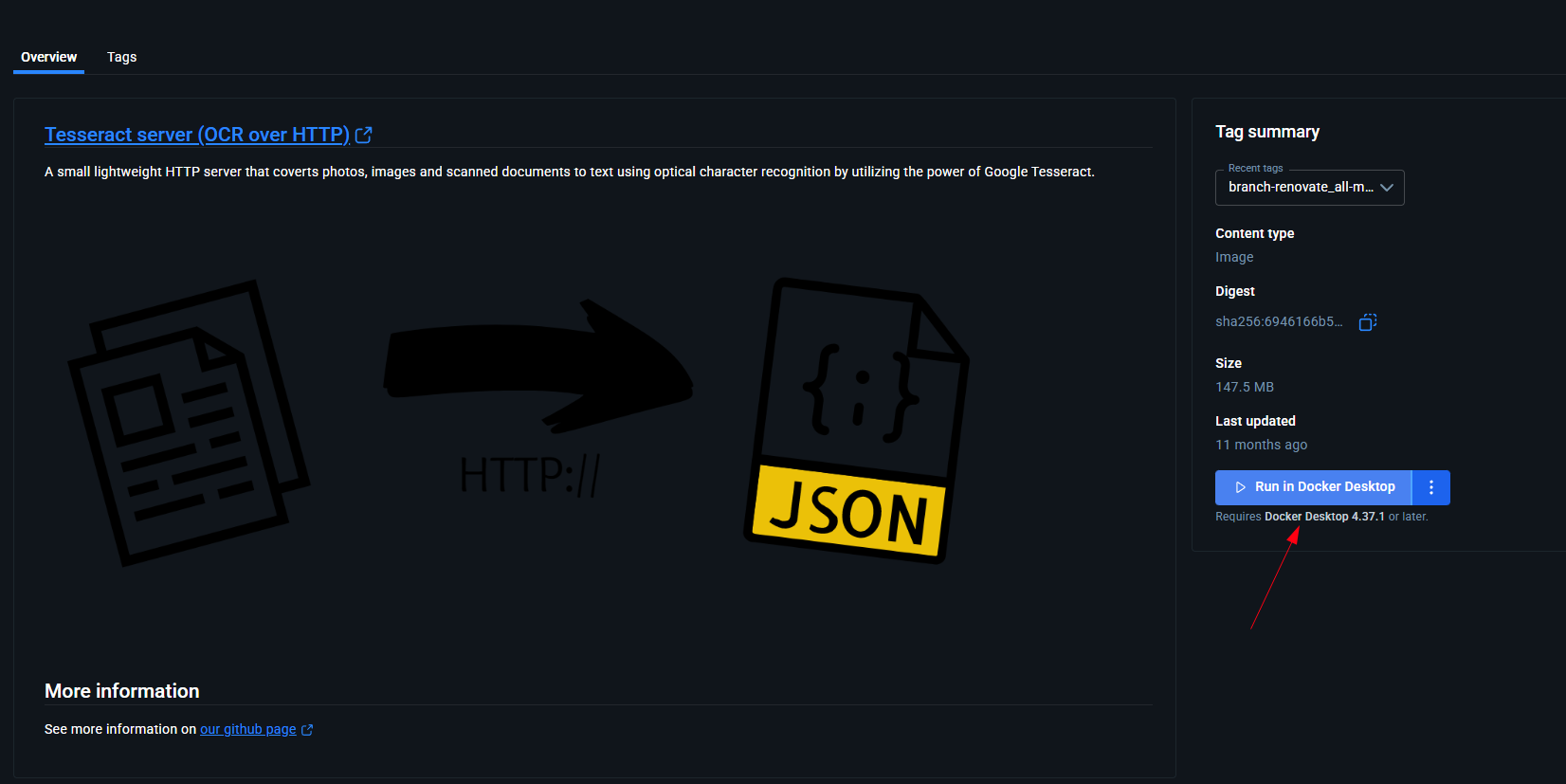

PeteGul 41 Posted December 27, 2025 Posted December 27, 2025 Maybe I'm lost here, but how do I use this on Win11? I run Emby server on Win11, and could not find an easy way of install Tesseract server/docker? Was in the Tesseract Github page, but didn't find an install HowTo. Never used this or a docker. Hmm.. Petter
yocker 1328 Posted December 27, 2025 Author Posted December 27, 2025 10 minutes ago, PeteGul said: Maybe I'm lost here, but how do I use this on Win11? I run Emby server on Win11, and could not find an easy way of install Tesseract server/docker? Was in the Tesseract Github page, but didn't find an install HowTo. Never used this or a docker. Hmm.. Petter You need to download and install docker for desktop. Should be able to find it in the microsoft store. Next part is hard to explain and maybe you can find a youtube video. But basically in the top there is a search, search for the tesseract container and make a pull. When downloaded you start it in containers. Docker can be a bit "scary" the first time but give it 30 min and you will find it's actually somewhat easy and user friendly 1
