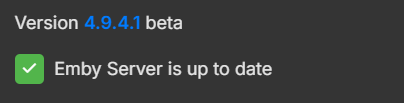

I've been playing with Emby for a while now.  Was revisting it as a daily solution, but noticed that for some reason, Comskip is not working on recordings currently (used to when I first set it up).  I'm on the beta branch, just upgraded to 4.9.4.1 to see if that would address the issue, but still having the same issue.  Checked the log in the tv program folder and saw this (also can replicate when I run Comskip manually).  Happens for all recordings now.

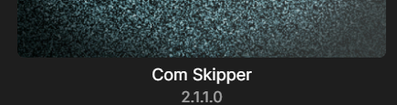

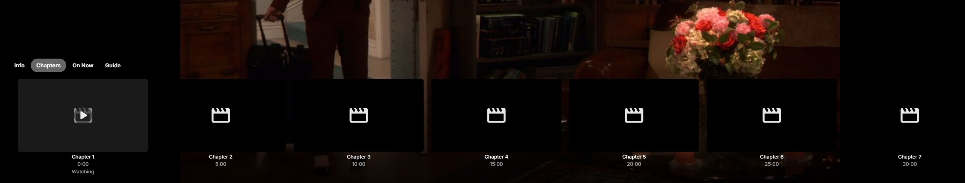

No errors are show.  The chapters are just loading at 5 minute intervals so I started looking at that one recording.  However, i believe that may just be an isolated issue.  I installed a new version of Ubuntu Server on a mini PC and installed Emby (not a docker but full install) and am noticing the same thing.  Even though commercials are being scanned an EDL is being created (with no errors in the log), Emby is still not loading the commercial breaks into the chapters.
Since this is the Synology forum, I'll keep this to the Synology box (only difference is Synology is running beta and the Linux box is on latest production version). Here's the specs:
image.png.35974b660b6b487a4652511ecb612a60.pngimage.png.794bf4d6cc1dab6b8546b75b8c97cc92.pngimage.png.82307f09ef9e5b6f0539316b11cb9ddc.png
image.thumb.png.13eaae548d4a52926b810161041d6c20.pngimage.png.7ee6245ebc400d2878ce8aca5b8ca236.png

I'm not sure what you mean by
Quote
My ComSkipper plugin doesn't use chapters. Just the EDL file generated by comskip.  Post a debug log where it doesnt skip when you expect it to and I can have a look.
I also just updated to the latest Emby nuget so you should update. Probably won't help but you never know.
Quote
Updated to the latest Emby nuget due to vulnerability.
I suggest updating ASAP.
