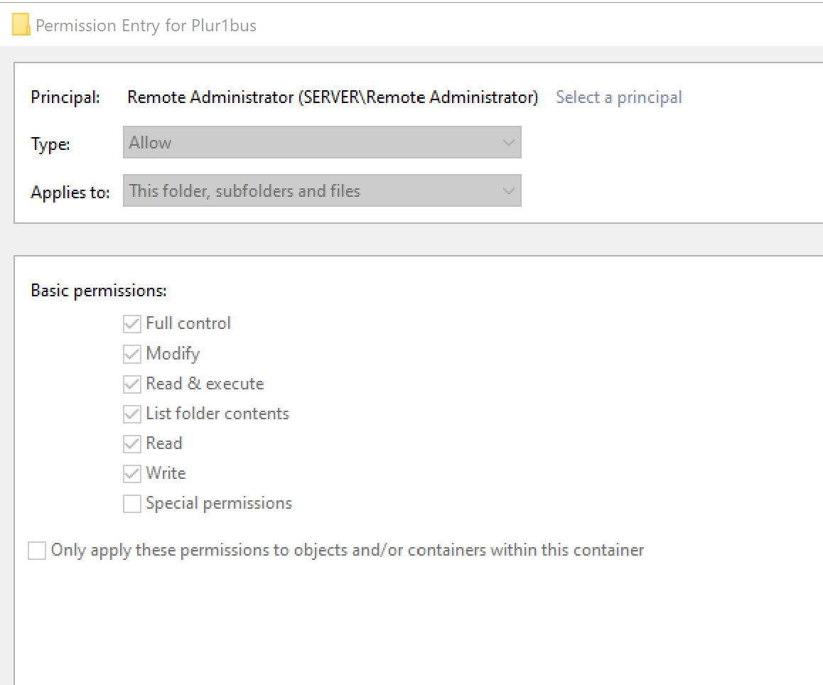

leebo 12 Posted December 30, 2025 Author Posted December 30, 2025 (edited) 20 hours ago, Lessaj said: Â but please fix the permission issues. Here's a screenshot of the folder permissions. I don't see an issue here. The Dexter folder did have a permission issue, but it's been fixed (just now), and the Plur1bus folder did not have that issue anyway. Would uninstalling Emby and reinstalling potentially fix anything? Edited December 30, 2025 by leebo
Lessaj 486 Posted December 30, 2025 Posted December 30, 2025 Please compare Dexter New Blood with another folder that worked previously, it's stopping on that folder.
leebo 12 Posted December 30, 2025 Author Posted December 30, 2025 25 minutes ago, Lessaj said: Please compare Dexter New Blood with another folder that worked previously, it's stopping on that folder. So after fixing the Dexter folder, I rescanned in Emby. It took a while, but the problem show got imported!!! I had to manually add the Imdb number to get the metadata to show up though. And the test show I did last week (Fallout) is the same. the title shows up but without any metadata. Hopefully that will resolve on it's own. Thanks for sticking with me. 2
