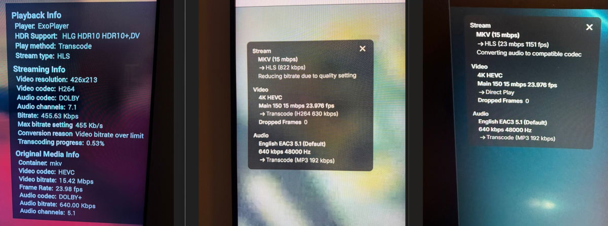

pclausen 44 Posted December 22, 2025 Posted December 22, 2025 (edited) In my living room, all my playback devices started rate limiting anything I play from my Emby server. In addition to it being limited on the Emby app on the TV, I'm also seeing the limit on my SHIELD as well as my HTPC. It even happens from a browser on the HTPC. I have attached a screenshot showing what I'm talking about. The left image is what I see from the App on SHIELD, the center screenshot is when playing back from a browser on my HTPC. The right image when I playback via a browser from a different computer. No issue there. I'm at a loss why every device I attempt to playback Emby content on in my living room is now being severely limited. Prime and Netflix continues to work just fine, so its not a network issues (all devices in the living room are 1Gbps Ethernet connections, no WiFi). I don't have any rate limits defined anywhere on the server. And as mentioned above, I can play back content just fine from a browser on another computer using the same account. Any ideas where the 455 Kb/s max bitrate setting is coming from? Edited December 22, 2025 by pclausen

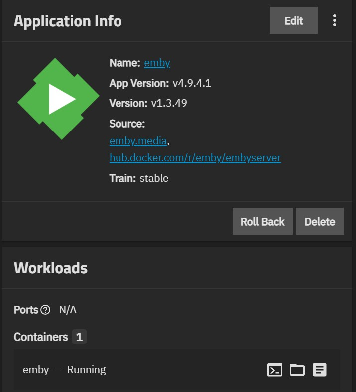

pclausen 44 Posted December 22, 2025 Author Posted December 22, 2025 (edited) Yes. Docker container on TrueNAS: Edited December 22, 2025 by pclausen

pclausen 44 Posted December 22, 2025 Author Posted December 22, 2025 (edited) They are all blank or set to 4k 200 Mbps (on the client side). Don't see anything on the server side that is not blank. As I mentioned above, if I go to another room/device, I don't see this rate limiting issue. In all my years of using Emby, I have never seen anything like this. I was on 1.3.48 when I first noticed the issue and updated to 1.3.49, but it did nothing to correct the issue. Again, issue is only in the living room across all these devices: Emby app on TV (TCL) Shield Emby App Shield Kodi with Emby HTPC running Emby HTPC using browser I go to a computer in another room using a browser, no issue at all. So I don't see how it could be a server side issue? But then I don't see how all my clients in the living room would all be impacted by this either, which would point to the server being the only thing they have in common. Edited December 22, 2025 by pclausen

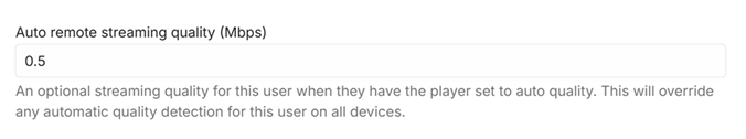

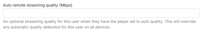

Neminem 1630 Posted December 22, 2025 Posted December 22, 2025 In your user config on the server, there is this new feature. I know it says Auto Remote, but try playing with that.

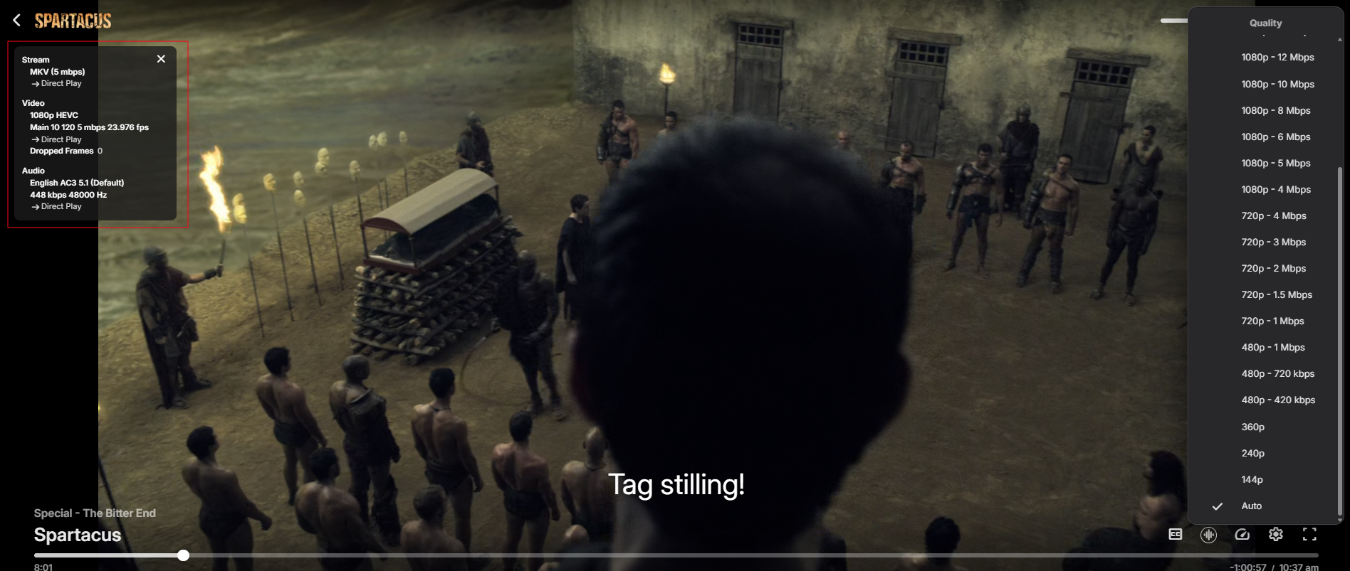

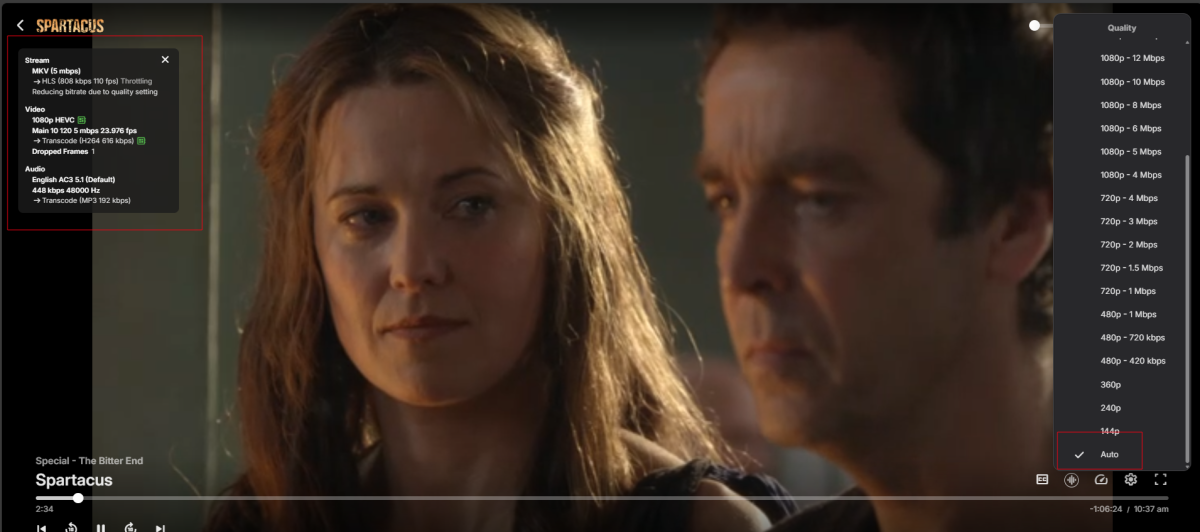

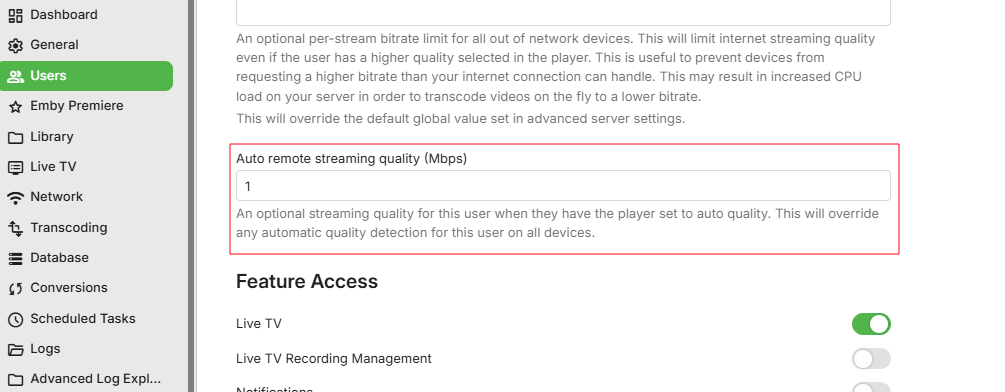

Neminem 1630 Posted December 22, 2025 Posted December 22, 2025 (edited) just testing this in lan. And is does set the Auto to 1Mbps for my web client even on lan. This is from transcoding logs. "IsRemote":false,"HasMixedProtocols":false," ffmpeg-transcode-8cc91370-6403-480a-ad26-27e4050e5b04_1.txtembyserver.txt Setting the settings to 10Mbps Is this supposed to apply to local Lan also? Edited December 22, 2025 by Neminem

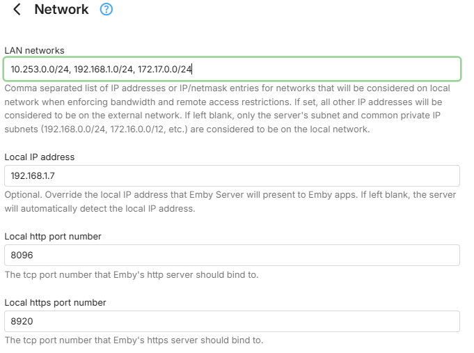

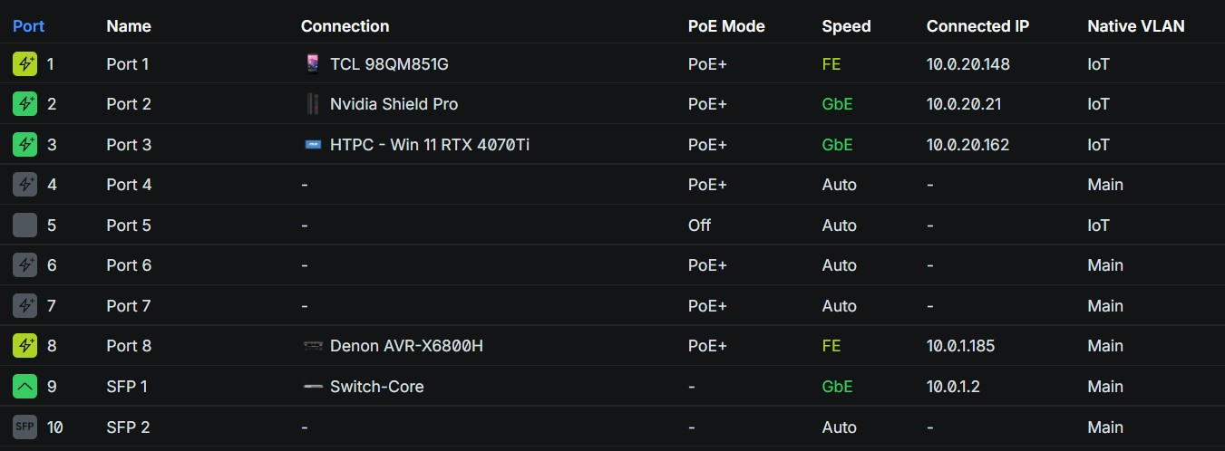

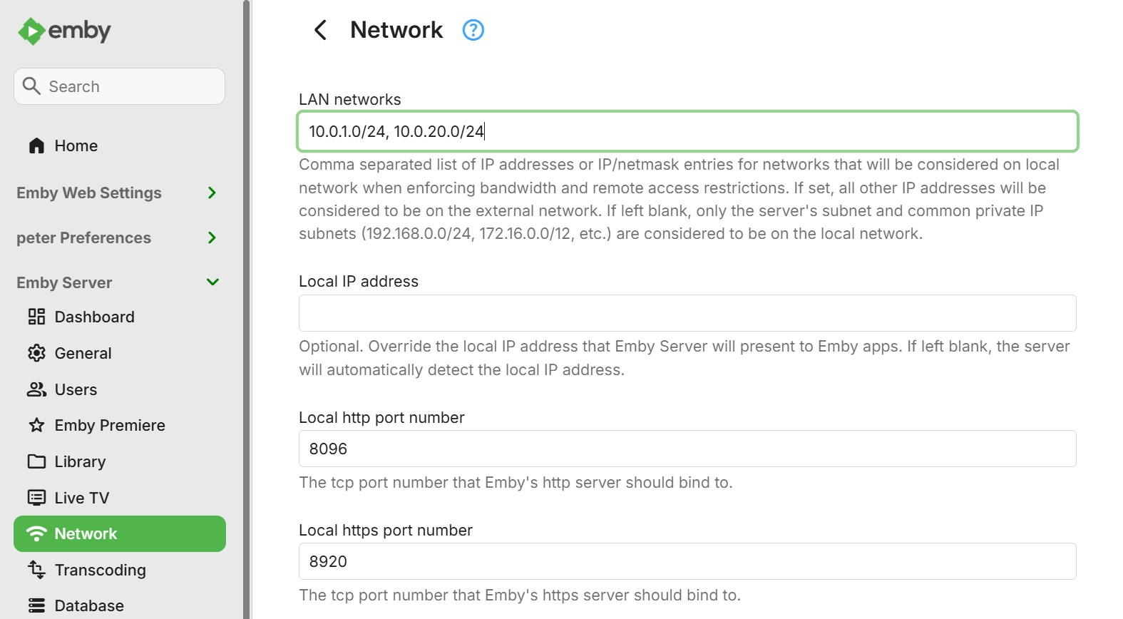

pclausen 44 Posted December 22, 2025 Author Posted December 22, 2025 (edited) @Neminem Thank you for the detailed response. So my streaming devices in the living room are indeed on a different VLAN than my Emby server: (server is on the Main VLAN) So I tried doing this initially: Restarted Emby server, but still the same issue. I then changed the VLAN that the HTPC is on to Main, and after rebooting the HTPC to pickup a "local" IP Address, everything started working like it should. So just adding my IoT to the list of LAN networks by itself does not seem to be enough to solve the issue it seems? When I get a chance, I'll try populating the "Local IP address" with that of my Emby server to see if that does the trick. Thanks! Edited December 22, 2025 by pclausen 1

pclausen 44 Posted December 23, 2025 Author Posted December 23, 2025 @ebr The switch in the living room has a solid 1 Gbps connection to my core switch that the Emby server is connected to. I have tested this from both the IoT and Main VLAN, and the speed is consistent. Is the bitrate test based on the assumption that the Emby server is connected at 1 Gbps? I ask because my server is connected to my core switch at 25 Gbps, so maybe that is throwing off the calculations? As stated above, I was experiencing the issue using a web browser as well when on the IoT network. I have since switched all my Emby clients all around the house to the Main VLAN and the issue is gone. But at some point I would like to be able to be on different VLANs/subnets and not be bitrate limited. I was not able to get it working by fiddling with the network config within Emby server, so I gave up and just put all clients on the same subnet as the server.

sa2000 703 Posted December 23, 2025 Posted December 23, 2025 @pclausenDid you check what this new setting is set at for the user account? could it have been inadvertantly set to 0.5 Mbps? @Neminemhas already confirmed that the separate local subnets added into Network Settings to be treated as local are actually not being treated as such for this new user setting.
Neminem 1630 Posted December 23, 2025 Posted December 23, 2025 1 minute ago, sa2000 said: has already confirmed that the separate local subnets added into Network Settings to be treated as local are actually not being treated as such for this new user setting. Hmmm I think you misunderstand Even on local lan, anything in that setting is being used... If blank No transcoding on lan. If set to 1Mbps in setting, lan connection is also transcoded down to 1 Mbps. Although the wording "Auto Remote" Either the wording is wrong, or the setting does take lan into account. Logs are in my previous post.

Neminem 1630 Posted December 23, 2025 Posted December 23, 2025 Sorry guys, pleas read all information before answering. @ebrIf you had look at the supplied logs you would have known this. App: Emby Web 4.9.4.1 Edge Windows User-Agent: Mozilla/5.0 (Windows NT 10.0; Win64; x64) AppleWebKit/537.36 (KHTML, like Gecko) Chrome/143.0.0.0 Safari/537.36 Edg/143.0.0.0
Neminem 1630 Posted December 23, 2025 Posted December 23, 2025 Further more this is in the logs "IsRemote":false,"HasMixedProtocols":false," If that's true, and it is, then the setting is faulty. See my logs from this post.

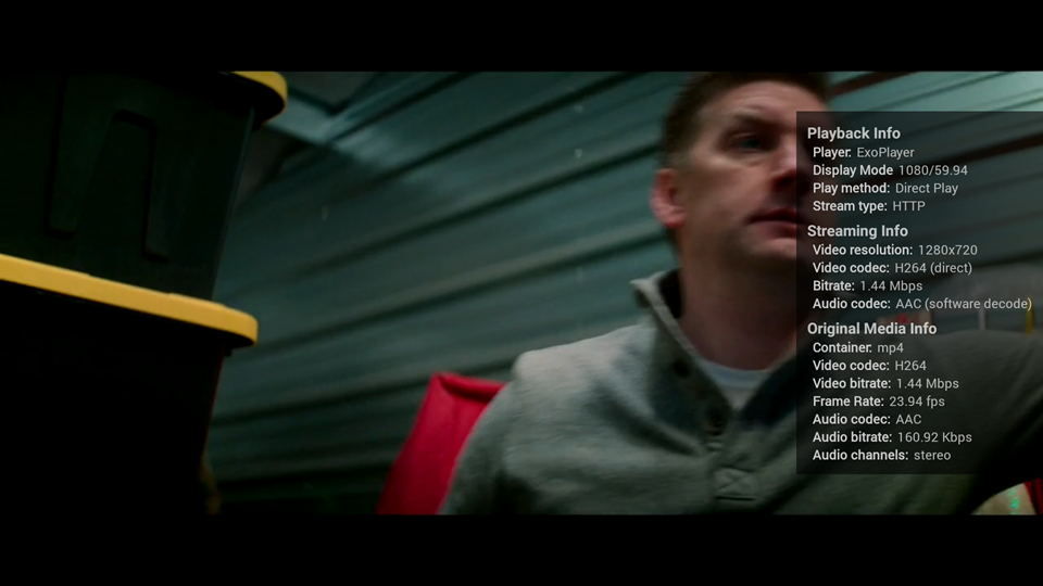

sa2000 703 Posted December 23, 2025 Posted December 23, 2025 1 hour ago, ebr said: I was just asking if you could confirm whether or not the Android TV beta app was NOT having that issue. Just tried AndroidTV Emby Beta 2.1.30 on the Shield with user setting for "Auto remote streaming quality" set to 0.5 Mbps and appears to be working ok on the local network. Just one subnet local network. I am not setup for multiple subnets so have not tested with other subnet
sa2000 703 Posted December 23, 2025 Posted December 23, 2025 I have to repeat that test because the Stats for Nerds are not showing it. Just tried with wifi through my phone hotspot so would be remote and stats for nerds appears to be the same - but Quality is showing as 500 Kb/s. So will repear the previous test and check this instead of Stats for Nerds
sa2000 703 Posted December 23, 2025 Posted December 23, 2025 Repeated the local network test with the user setting at 0.5Mbps, the Quality for playback shows as 110 Mb/s. So it appears for single subnet LAN the 2.1.30 Android TV Beta is ok
Neminem 1630 Posted December 24, 2025 Posted December 24, 2025 Testing the Android TV Beta 2.1.30 does respect the in lan and remote connection. With the setting set to 0.5Mbps.
