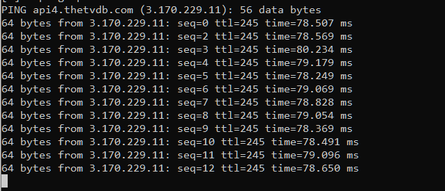

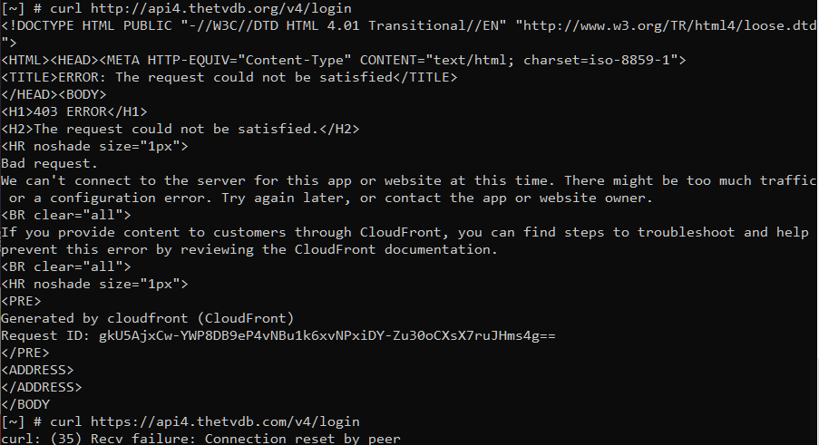

dux_fang 0 Posted December 22, 2025 Author Posted December 22, 2025 I can access this address through ping api4.thetvdb.com from the command line, but I cannot access it using the curl command https://api4.thetvdb.com/v4/login What is the reason for this? Look at the screenshot above, another address http://api4.thetvdb.org/v4/login , can be accessed through the curl command
