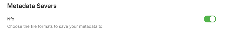

Luke 42288 Posted December 21, 2025 Posted December 21, 2025 Hi, have you enabled nfo file saving for this library? They will be these values: airsbefore_episode airsafter_season airsbefore_season
Mayfly777w 3 Posted December 21, 2025 Author Posted December 21, 2025 I had checked it from the beginning, and indeed multiple NFO files were generated under the media folder. However, whether it’s the NFO of a special episode for which I’ve already set playback rules, the NFO of the main episode referenced by the special episode, the tvshow.nfo, or the corresponding season.nfo, I haven’t been able to find the relevant field in any of them. To be precise, in which file is it actually saved?
Solution Luke 42288 Posted December 22, 2025 Solution Posted December 22, 2025 HI, it would be in the episode nfo file. Try going to one of these episodes in the metadata editor and just click save, then check the nfo file for it. That should give you an example to look at. 1
