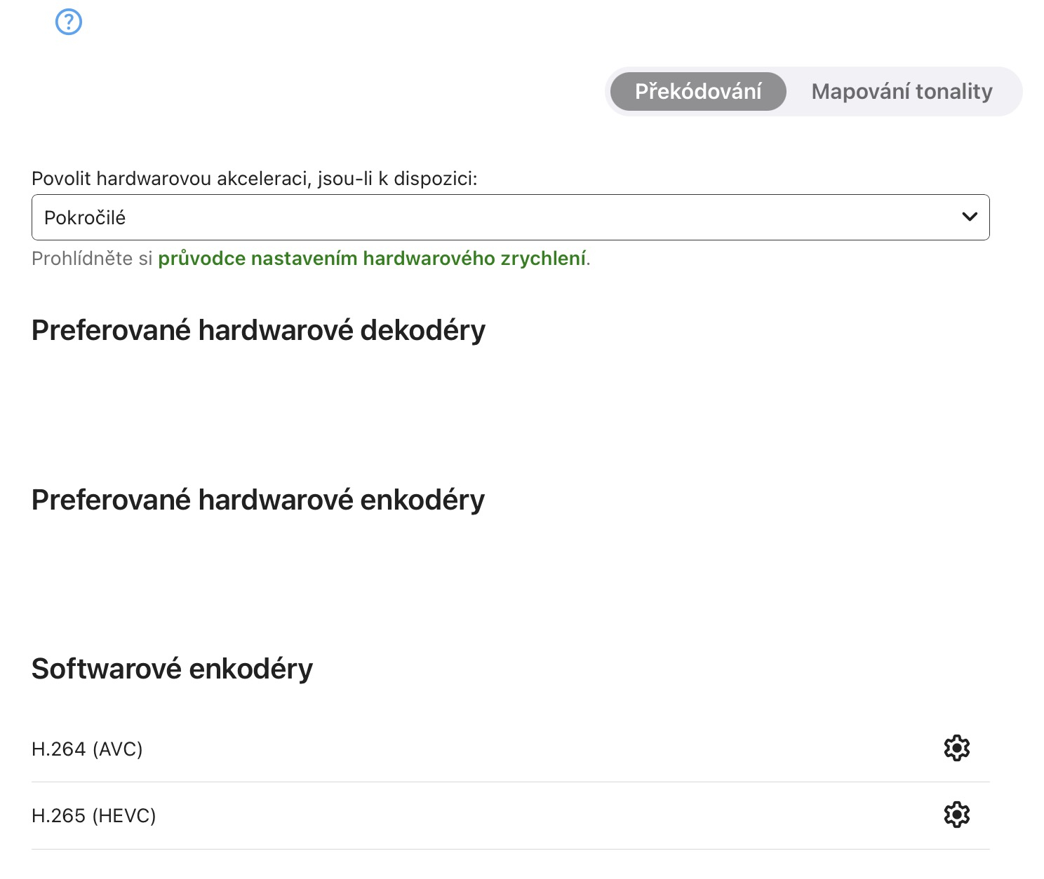

lessyen 0 Posted December 28, 2025 Author Posted December 28, 2025 Actually I'm currently on 4.9.1.90 and it looks like my hardware acceleration disappered as well.. Could this be the problem??

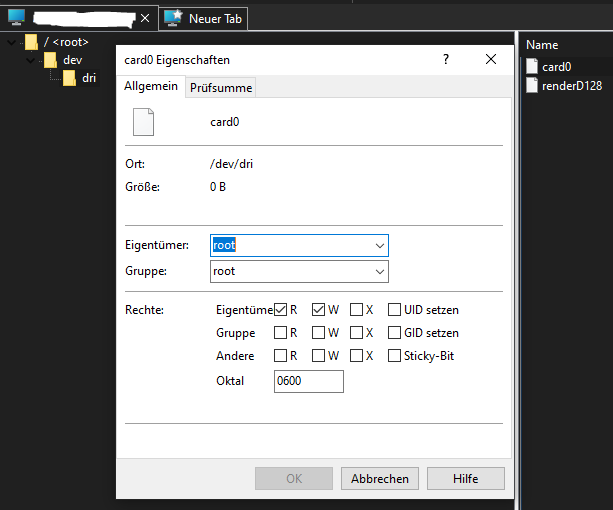

Bims0n 14 Posted December 28, 2025 Posted December 28, 2025 (edited) The issue I posted previously only affects tone mapping, meaning your hardware acceleration section should still be populated. However I had the same issue once where emby was not able to access the DSM video drivers anymore due to right issues of the appropiate files. The section was then empty until the rights were set correctly once again. Could you check in the filesystem at root/dev/dri and set the rights for the files as following and restart your emby? card0 (root/root) renderD128 (root/videodriver) Edited December 28, 2025 by Bims0n

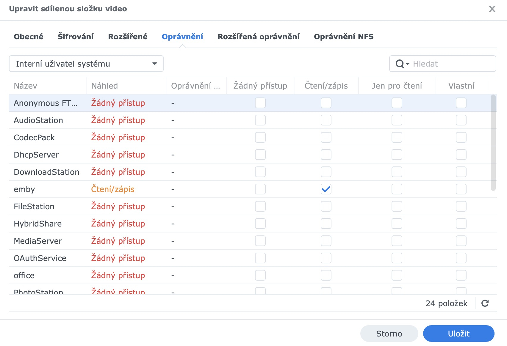

lessyen 0 Posted December 28, 2025 Author Posted December 28, 2025 Honestly this is beyond my knowledge, could you please write me step by step instructions for "noobs"?? I assume it's nothing to do with this right??
Bims0n 14 Posted December 28, 2025 Posted December 28, 2025 (edited) Hi, you guessed right - this has nothing to do with the shared folder permissions. Video Driver files are not accessible within the DSM GUI afaik. Here is a detailed guide on how to access the filesystem (many ways to do so but this is the easiest for rookies I believe): (please be careful with what you do ever there, do not delete or move any files as this could cause serious damage to your NAS unless you know what you are doing) If sucesful with the guide above head into the filesystem via WinSCP at /root/dev/dri and check the rights for the files (rightlick on the file --> properties). They should be as following: card0 (root/root [0600]) renderD128 (root/videodriver [0660]) Edited December 28, 2025 by Bims0n

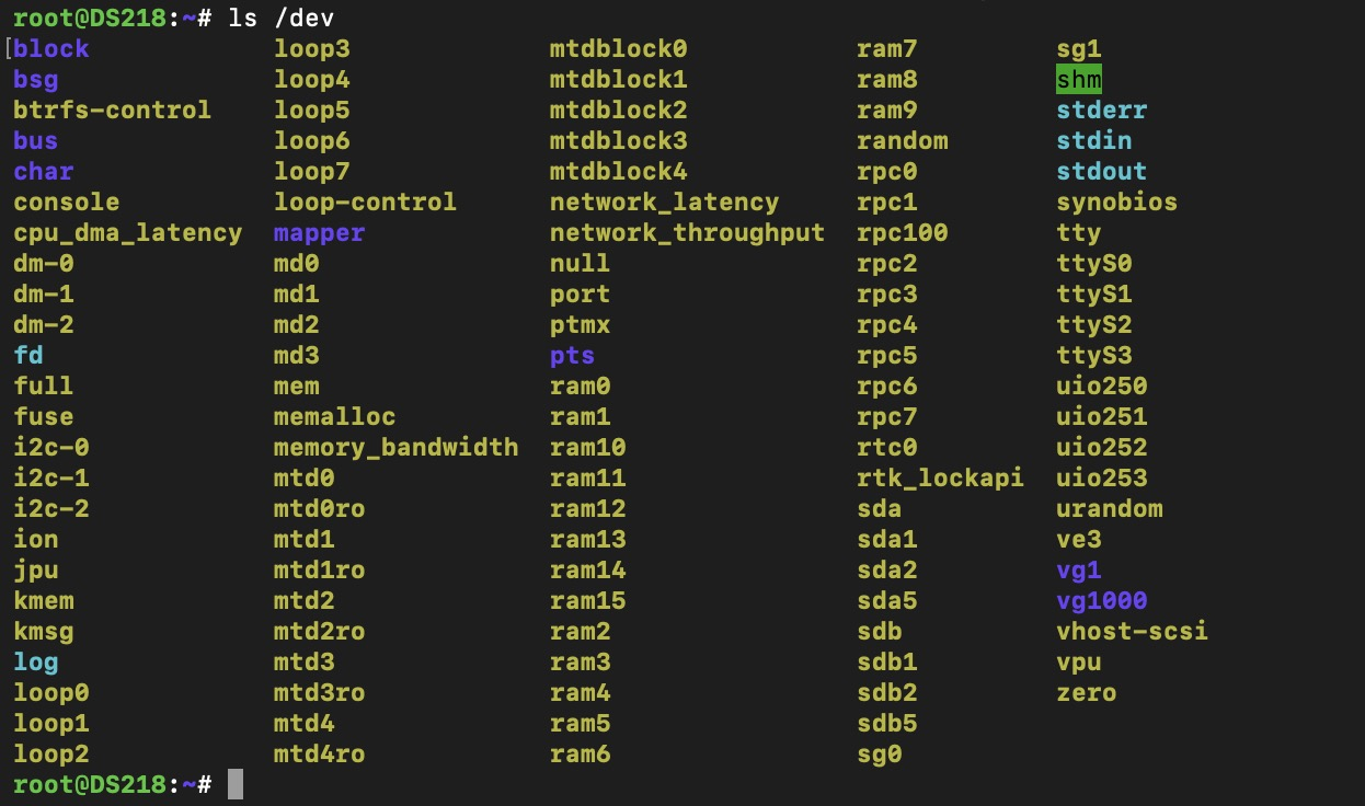

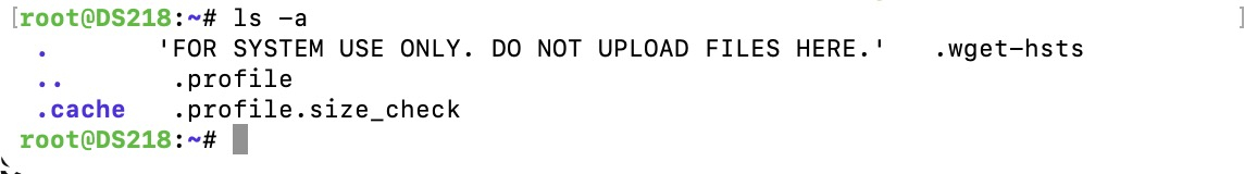

lessyen 0 Posted December 28, 2025 Author Posted December 28, 2025 I've managed to connect via SSH from my macOS, listed folders and it I don't see any dev folder nor dri subfolder..
Bims0n 14 Posted December 29, 2025 Posted December 29, 2025 (edited) If you want to do it via SSH then this is also fine, GUI editing is easier however imo. Commands would be as following up to my limited command line knowledge. Please note that # comment is the comment that explains what is done in the command line. sudo -i #get super user rights #enter your su admin password cd /dev/dri/ #change directory ls -l #read file attributes (screenshot for comparison) If these don't match then we should change them, beforehand however I strongly recommend to back them up: cp /dev/dri/card0 /dev/dri/card0_backup #backup card0 file cp /dev/dri/renderD128 /dev/dri/renderD128_backup #backup renderD128 file chmod 600 /dev/dri/card0 #change read/write of card0 file chmod 660 /dev/dri/renderD128 #change read/write of renderD128 file chown root /dev/dri/card0 #change owner of card0 file chgrp root /dev/dri/card0 #change group of card0 file chown root /dev/dri/renderD128 #change owner of renderD128 file chgrp videodriver /dev/dri/renderD128 #change group of renderD128 file after these changes exit & disable SSH and restart Emby. Edited December 29, 2025 by Bims0n
lessyen 0 Posted December 29, 2025 Author Posted December 29, 2025 38 minutes ago, Bims0n said: cd /dev/dri/ #change directory "cd /dev/dri/" - No such file or directory.. any ideas??
visproduction 335 Posted December 29, 2025 Posted December 29, 2025 Is you ./dev in he md directory? https://www.man7.org/linux/man-pages/man4/md.4.html
TMCsw 259 Posted December 30, 2025 Posted December 30, 2025 9 hours ago, lessyen said: "cd /dev/dri/" - No such file or directory.. any ideas?? This generally means the computer doesn't have a "GPU/iGPU" or, more likely, the GPU Drivers aren't installed and/or working correctly.
lessyen 0 Posted December 30, 2025 Author Posted December 30, 2025 As far as I know: "Synology DS218 has an integrated GPU (iGPU) within its Realtek RTD1296 CPU, which enables hardware-accelerated video transcoding, specifically for 10-bit 4K H.265 (HEVC) video." I believe everything went wrong after Synology's decision to cut-off VideoStation and disable HW transcoding natively.. I really need Emby to pull it out from DS218 and make it working again.
lessyen 0 Posted December 30, 2025 Author Posted December 30, 2025 Can this be resolved/configured/updated through Emby, or should I start looking into the possibility of running it from Docker (if that's even possible on DS218)??
DonMacaroni 55 Posted December 30, 2025 Posted December 30, 2025 Docker won't help if your host lacks video drivers. 1
