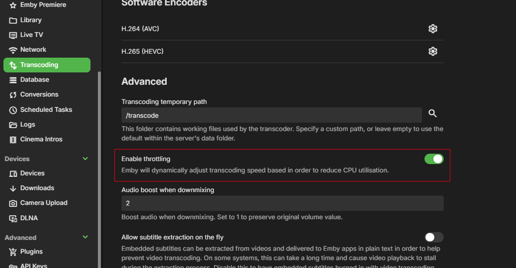

Neminem 1623 Posted December 18, 2025 Posted December 18, 2025 Also try with this setting. That should insure that you only transcode what is needed in the timeframe you are watching. This option will enable burst transcoding, as needed. Without this setting your server will transcode the whole file, and first stop when it's done with that. And will start over if you stop the stream, for a restroom break
