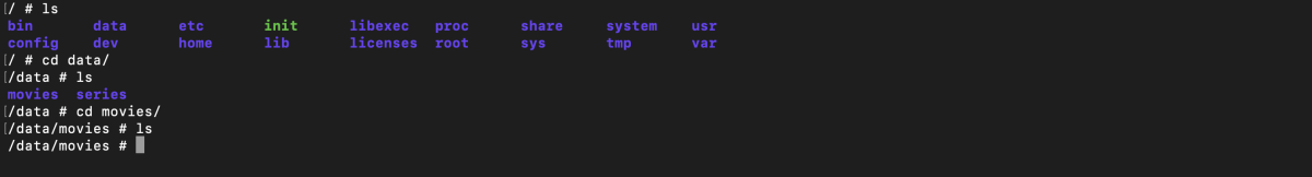

pepeze12 1 Posted December 17, 2025 Posted December 17, 2025 (edited) Hey there, My setup consists of a Proxmox server with three VMs: an HAProxy VM for SSL, a TrueNAS VM for storage, and a Docker server with a GPU for transcoding. I mounted my media library via NFS because I want to stay flexible with storage. I also have a Windows 11 VM to manage the library. Anyway, I mounted the NFS share under /mnt. All containers work fine, but Emby randomly loses the library. When I check the share on the Docker host where the library is located, all movies are still there. However, when I ls inside the container and look at the mount point, it’s empty. This happens every 2–3 days. Can someone help me with this? ffmpeg-transcode-85f555bb-6249-4947-8bde-cabdad649a20_1.txt embyserver.txt Edited December 17, 2025 by pepeze12

Luke 42242 Posted December 17, 2025 Posted December 17, 2025 The server cannot access the video files directly. You can see it all throughout the log: Quote 13:37:10.328 /data/movies/H/Hotel Transylvania 2 (2015) [tmdbid=159824]/Hotel Transylvania 2 (2015) [tmdbid=159824].mkv: No such file or directory This could be any number of things from the mount being disconnected, to file names changed, to being denied permission on it, etc.
pepeze12 1 Posted December 18, 2025 Author Posted December 18, 2025 But nothing is there. When I go into the container, the folder is empty. If I check on the host, the NFS mount is still present and all movies are in place. The system also reports that there was no NFS disconnect, and I didn’t change any names or settings between the time it was working and the time it failed. I don’t understand what is happening.

pepeze12 1 Posted December 19, 2025 Author Posted December 19, 2025 (edited) 13 hours ago, darkassassin07 said: Are you mounting the nfs share to the host, then bind-mounting the folder on the host to a folder in the container like any other folder? Yes, exactly. That works better for me. 13 hours ago, visproduction said: I thought mounted drives in Ubuntu are nomally in the ./mnt folder, not in /data. I should have explained what the two images are. Sorry, my bad The upper screenshot shows the Docker host where the NFS share is mounted. The screenshot below shows the mount inside the container, where the NFS mount is passed to Emby. For example. volumes: - mnt/nfs/emby-movies:/data/movies Edited December 19, 2025 by pepeze12
