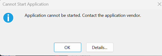

bobbee001 4 Posted December 16, 2025 Author Posted December 16, 2025 To fix all my issues, tried uninstalling emry and reinstalling on windows 11. stops at 50%
bobbee001 4 Posted December 16, 2025 Author Posted December 16, 2025 Ran sfc against windows, found and corrected a few microsoft win11 errors. Tried the install again install.log
bobbee001 4 Posted December 16, 2025 Author Posted December 16, 2025 Restart windows, reran emry setup. loads 50%, after a few seconds - blank screen

bobbee001 4 Posted December 16, 2025 Author Posted December 16, 2025 I had just run the uninstall. Ok, I just deleted the directory and tried again. install.log
Neminem 1591 Posted December 16, 2025 Posted December 16, 2025 Hmm devs will need to answer, I'm not sure what that error in that log means. But did you restart PC after uninstalling it.
bobbee001 4 Posted December 16, 2025 Author Posted December 16, 2025 I restarted after the uninstall. Not after the directory uou mention was deleted.
