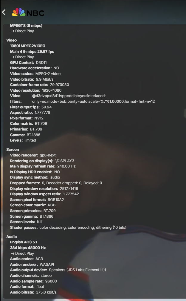

bandit8623 226 Posted December 15, 2025 Posted December 15, 2025 this is the windows app. any way to boost audio on the app? its half the volume here is through browser.

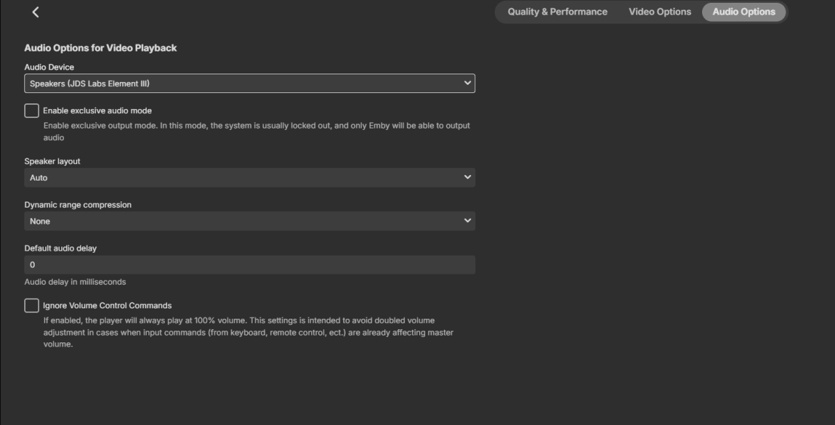

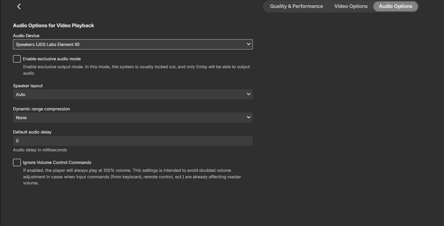

softworkz 5133 Posted December 19, 2025 Posted December 19, 2025 There are a number of places where volume can be controlled: Inside MPV player Windows per-App sound mixer Windows global volume Sometimes, audio devices have their own additional software control for volume Hardware volume (in case of speakers) and additional knobs that are possibly affecting volume: Speaker layout mismatch (try set explicitly Windows speaker layout setup (right-click device in Windows settings and select "Set up speakers" Dynamic range compression enabled So, please go through all of these and check. Two things for reducing confusion and number of places involved: Enable "Exclusive audio mode" Enable "Ignore volume control commands

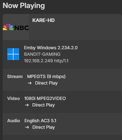

bandit8623 226 Posted December 19, 2025 Author Posted December 19, 2025 (edited) 4 hours ago, softworkz said: There are a number of places where volume can be controlled: Inside MPV player Windows per-App sound mixer Windows global volume Sometimes, audio devices have their own additional software control for volume Hardware volume (in case of speakers) and additional knobs that are possibly affecting volume: Speaker layout mismatch (try set explicitly Windows speaker layout setup (right-click device in Windows settings and select "Set up speakers" Dynamic range compression enabled So, please go through all of these and check. Two things for reducing confusion and number of places involved: Enable "Exclusive audio mode" Enable "Ignore volume control commands ill try exclusive mode. i have a usb dac that the settings dont change when using browser vs app. the audio only seems off for ac3 audio on live tv. ill double check this Edited December 19, 2025 by bandit8623

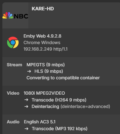

Lessaj 484 Posted December 19, 2025 Posted December 19, 2025 (edited) What do you have set on the server side for "Audio boost when downmixing" in the Transcoding section? I think that AC3 5.1 -> MP3 is a 2.0 downmix. Edited December 19, 2025 by Lessaj
bandit8623 226 Posted December 19, 2025 Author Posted December 19, 2025 (edited) 2 minutes ago, Lessaj said: What do you have set on the server side for "Audio boost when downmixing" in the Transcoding section? I think that AC3 5.1 -> MP3 is a 2.0 downmix. i have it boost so it matches other content. if i dont boost its super quiet. think +2 not sure why default downmix by default is way quiet? Edited December 19, 2025 by bandit8623
bandit8623 226 Posted December 19, 2025 Author Posted December 19, 2025 (edited) 2 minutes ago, Lessaj said: So it's set to? 1? 1.5? 2? +2 i think im not home atm. cant vpn this second Edited December 19, 2025 by bandit8623 1
Lessaj 484 Posted December 19, 2025 Posted December 19, 2025 I see your edit now. I think I misread which one was the problem, but I guess that explains why the browser is much louder.
