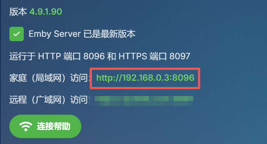

sunmagic 2 Posted December 14, 2025 Posted December 14, 2025 Here is my situation: I have a proxy server at 192.168.0.3:8085 and an Emby server at 192.168.0.3:8096. Currently, when I add 192.168.0.3:8095 in the client, it automatically detects and switches to 192.168.0.3:8096 upon the next login, which is not what I intend. Therefore, I would like to ask if it is possible to configure the client to prevent it from automatically detecting the IP and port, or if the server can be customized to avoid this behavior. Thank you for your assistance.

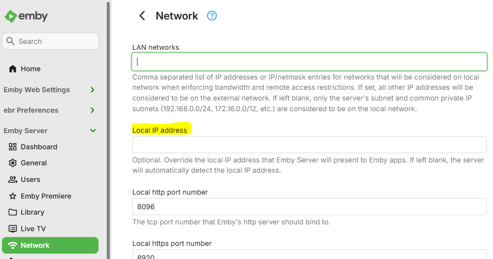

ebr 16354 Posted December 15, 2025 Posted December 15, 2025 Hi. You can already configure this in the server settings:
sunmagic 2 Posted December 15, 2025 Author Posted December 15, 2025 Thank you for your reply. I have tried this configuration. Changing the port here directly replaces the service port. For example, if I set it to 8098, the client will also detect 8098 and automatically change to 8098, instead of the 8095 I want.

ebr 16354 Posted December 15, 2025 Posted December 15, 2025 Sorry, this is what you want to set to 8095.
