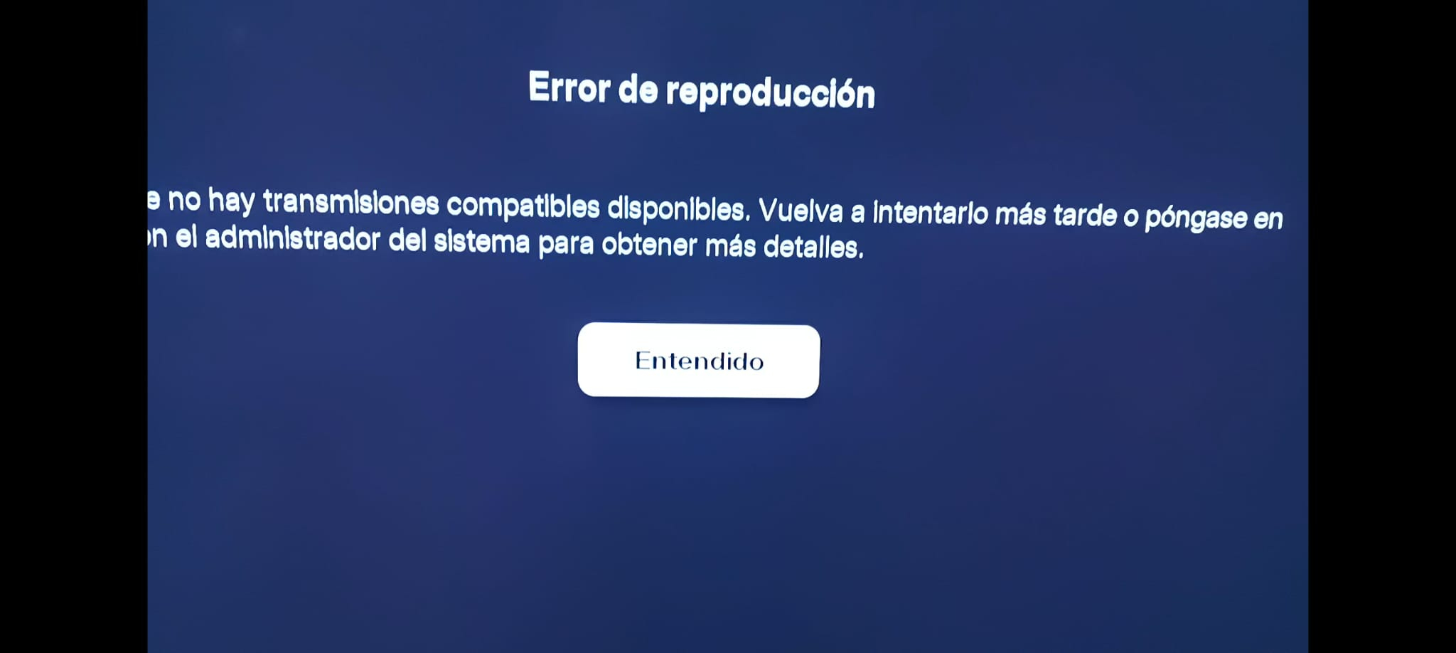

PE65_Ansia 1 Posted December 13, 2025 Posted December 13, 2025 It started last summer when trailers stopped playing. I read that it was a cookie issue, but in my case, it's still the same. Trailers and movies, even those I've had saved for over 15 years, have stopped working. Despite deleting everything, completely turning off the TVs, and reinstalling the app version 1.0.47, it's still the same. The LG TVs are 2025 Oled, and the Philips is a 2023 Ambilight. I have over 2,000 movies, TV series, etc., on the server. The strange thing is that the TV series work perfectly, but the movies, even some that worked a few months ago, no longer do. It gives a "strange" error... The server is an old HP server with 128 GB of RAM, two Xeon processors, etc. It's a beast that I use as a NAS. The hard drives, with a total capacity of about 40 TB, are kept at temperatures below 35 degrees Celsius. The strange thing is that, with other similar programs, movies play perfectly without errors. I tried this program in September 2024; I liked it and paid for the subscription, but now I can't use it, or it only works for watching TV series. Movies don't work, neither in 480p nor in 4K; everything fails. The error message says: Playback error. There are currently no compatible streams available. Please try again later or contact your system administrator for more information. It also appears, but only for a few seconds and then disappears: Watch video on YouTube Error 153 Video player configuration error. Remembering the P2P era, I renamed the files I recently added in case there was a copyright issue. Even though I only use it on an intranet, the problem persists: it gives an error. And those same movies that won't play in Emby do play in other similar programs. If I play them on the server, with any player, they work perfectly, but not with Emby. Is anyone else experiencing a similar error? Best regards.
Luke 42233 Posted December 13, 2025 Posted December 13, 2025 Quote It started last summer when trailers stopped playing. I read that it was a cookie issue, but in my case, it's still the same. Trailers and movies, even those I've had saved for over 15 years, have stopped working. @PE65_Ansia Hi there, let's look at an example. Please attach the information requested in how to report a media playback issue. Thanks!

TechMinerUK 1 Posted December 21, 2025 Posted December 21, 2025 For what its worth, I have the same issue at the moment, it's not affecting all LG TVs (We have 4 that we use at home) All TVs are running Emby for LG 1.0.47, three of the TVs are absolutely fine playing any format with zero issues, one of them categorically will no longer work with any media (Music, TV shows or movies) Nothing too unusual is showing up in the logs and I know it's not a server issue, the TV for whatever reason has just decided to throw its toys out of the pram, I've even reset the TV, signed out of the app, deleted it and re-installed it but el zilcho
PE65_Ansia 1 Posted December 22, 2025 Author Posted December 22, 2025 On 12/16/2025 at 9:05 PM, Luke said: HI, you can also send log files over private message to me. Surprise! If I move the movies that are giving errors directly to a folder in the TV series section, they play without any problems. Note: I only tried moving 1 terabyte. I haven't tried it with 3 or 4... And it worked perfectly, not a single error. And those same movies in the movies section, ALL of them without exception, give errors. I've tried about 100 or so, very old movies from the last century and from 2025... All with the same error. It's funny, if I add more letters or numbers to the title, all of them, without exception, play again. And if I move them to any folder in the TV series, the same thing happens; I don't need to change the name and they play perfectly. Therefore, it's not the server configuration; it's the application LG is using. Or perhaps the type of LG TVs, are OLED models from 2025.
PE65_Ansia 1 Posted December 22, 2025 Author Posted December 22, 2025 4 hours ago, TechMinerUK said: All TVs are running Emby for LG 1.0.47, three of the TVs are absolutely fine playing any format with zero issues, one of them categorically will no longer work with any media (Music, TV shows or movies) Try changing the name; for example, if the movie is called "Blade," rename it to "Blaaaade." If I change the name, they play perfectly. The TV series aren't giving me any errors at the moment. And if I add a folder called "movies" inside one of the TV series folders and put the movies that aren't working inside it, they start working again.
Luke 42233 Posted December 22, 2025 Posted December 22, 2025 3 hours ago, PE65_Ansia said: Surprise! If I move the movies that are giving errors directly to a folder in the TV series section, they play without any problems. OK then maybe try refreshing metadata on an existing title, and then see if you can play after that.
PE65_Ansia 1 Posted December 22, 2025 Author Posted December 22, 2025 Luke, in short, is a bit strange, but it's the LG app, because it doesn't change anything in the Emby registry. It's as if it's completely independent of the Emby system. It could be something specific to LG TVs... I need to do more testing... But I'm setting up a home theater and I have very little free time to test with Emby. For now, if you rename them, it works. If you move them to any folder in the TV series section, it also works without renaming them. Regarding renaming, I think it's a copyright issue, because using movie titles that will be released in 2026 gives me the same error. If, for example, I rename "Blade" to "Spider-Man: Brand New Day," it still blocks it. But if the title is, for example, "Spider-Man: Brand BAD Day," then it can be viewed without any problem. And nobody accesses Emby from outside their home. I have friends who do use it, but since this happened to me in August, I've blocked them all. 8 hours ago, Luke said: OK then maybe try refreshing metadata on an existing title, and then see if you can play after that. Noted, but I think I already tried that... I keep a log of the server tests to note what works and what doesn't. I'll run tests on the 24th and 25th, which I expect will be quiet days...
