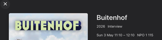

O19GP 8 Posted April 27 Author Posted April 27 @LukeComing back to this, as I still haven't found a way to fix it: Here's more detailed log info: Setup: Emby 4.9.3.0 running in Docker on WSL2 (Windows host). Container timezone set to Europe/London, confirmed BST. Host system clock synced via NTP, correct. Windows host clock matches WSL2 clock to the second. The problem persists and I have a clean example. Buitenhof (Dutch channel, WebGrab+Plus EPG) on 26 April 2026: - Emby guide shows start time: 11:10 - Recording timer fired: 11:00:13 - Actual broadcast start: ~11:13 - Recording ran for 69.73 minutes - Result: recording started 10 minutes before guide time, ended ~60 seconds before programme finished From the log: 2026-04-26 11:00:13.633 Info LiveTV: Recording timer fired for 98bc93fdf2a834b0f336065f2561a814 Buitenhof - S21:E24 2026-04-26 11:00:16.073 Info LiveTV: Will record to .../Buitenhof S21E24.ts for 69.73211289666666 minutes. The same pattern occurs on UK channels using Emby's own guide data (not just WebGrab), so this is not an EPG source issue. Channel 4 News and ITV Evening News show identical behaviour — timer fires significantly before the guide-scheduled time, with a variable offset typically between 10 and 45 minutes early. Pre/post padding is set to zero. The issue started at the BST→GMT clock change in October 2025 and has persisted through the GMT→BST change in March 2026. Deleting and recreating all series timers did not resolve it. Happy to provide additional logs or run any diagnostics that would help identify where the scheduling offset is being introduced. ----- The screenshot is for this upcoming Sunday as I can't see yesterday's guide anymore. Time is exactly the same.

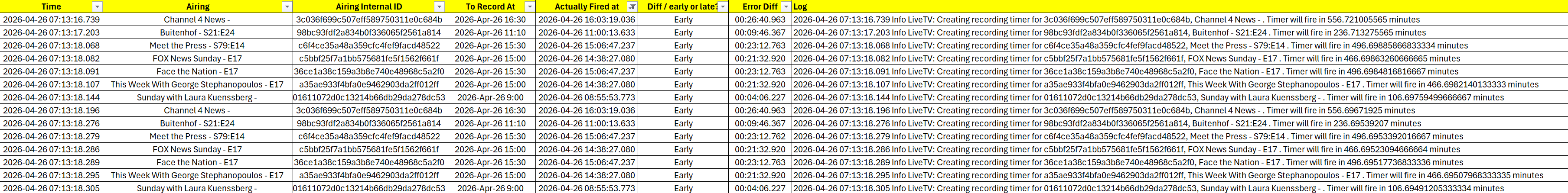

sa2000 890 Posted April 27 Posted April 27 (edited) 20 minutes ago, O19GP said: Is there a way to determine whether Emby's timer fires based on an absolute wall clock target, or on elapsed time from creation? If it's elapsed time, a clock jump between 07:13 and 16:03 could produce exactly this offset even if the clock looks correct afterwards. I do not know - @Lukewill need to answer that. All I can say is that all timers are firing incorrectly Why use WSL ? Can you reproduce this on windows or native linux machine There are references to time going out of sync in WSL when you do web search - eg https://www.google.com/search?q=timers+not+accurate+in+wsl&oq=timers+not+accurate+in+wsl Log shows all the trigger times were wrong. My gut feeling is that this is a WSL 2 issue Analysis in excel shows they are all adrift Edited April 27 by sa2000
