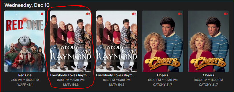

justinrh 266 Posted December 11, 2025 Posted December 11, 2025 The first "Everybody Loves Raymond" show did not record last night. Any way to know why? embyserver-63901008000.txt

justinrh 266 Posted December 12, 2025 Author Posted December 12, 2025 (edited) Luke, there were 2 episodes scheduled, see the pic. Do you see 2 recordings? The one you list is the 1 of the 2 that did in fact record. Edited December 12, 2025 by justinrh
Luke 42239 Posted December 13, 2025 Posted December 13, 2025 OK but that is the one you circled, and you specifically said the first one did not record. So what time was the one that did not record? What was the season and episode number?
justinrh 266 Posted December 13, 2025 Author Posted December 13, 2025 Okay, if 20:00:04.156 indicates the start of the recording, then I must have gotten the 2 mixed up. What I do know is one of them did not record.

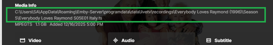

sa2000 696 Posted December 15, 2025 Posted December 15, 2025 There are a couple of aspects to this that need to be looked into 1. How we handle back to back recordings - We closed the live TV stream at 20:30 as the 20:00 episode completed at same time as the trigger fired for the 20:30 recording. I just need to double check that is normal 2. Both airings had the same episode title as the episode was in 2 parts - being S05 E01 and S05 E02 with same title "Italy" for both. I need to look into if the title plays a part in establishing if already in the library. The episodes are both named Italy but identified in the guide metadata as being in 2 parts and there are two different internal identifiers. These were the 2 fired timers 2025-12-10 20:00:00.014 Info LiveTV: Recording timer fired for 99af148f028fc756957a28c029709c01 Everybody Loves Raymond. 2025-12-10 20:30:00.008 Info LiveTV: Recording timer fired for 91c1cf038e78cb87c8da85ae292dfcaa Everybody Loves Raymond. We recorded the first into 2025-12-10 20:00:00.550 Info LiveTV: Opening live stream for recording from channel 1073276 MeTV to D:\media\TV_series\Everybody Loves Raymond (1996)\Season 5\Everybody Loves Raymond S05E01 Italy.ts When the timer fired for the 2nd episode, we were closing the stream because of the completion of the first - i do not know if this was a factor 2025-12-10 20:30:00.008 Info LiveTV: Recording timer fired for 91c1cf038e78cb87c8da85ae292dfcaa Everybody Loves Raymond. 2025-12-10 20:30:00.011 Info LiveTV: Recording stopped: D:\media\TV_series\Everybody Loves Raymond (1996)\Season 5\Everybody Loves Raymond S05E01 Italy.ts 2025-12-10 20:30:00.012 Info MediaSourceManager: Live stream native_99f3661e0eaea35588d3ef46d10be2c5_0e2e34d94a677e59c0f695f4edb1976a consumer count is now 0 2025-12-10 20:30:00.012 Info MediaSourceManager: Closing live stream 06044cf0e6f93cdae5f285c9ecfaaeb4_01413a525b3a9622ce6fdf19f7dde354_native_99f3661e0eaea35588d3ef46d10be2c5_0e2e34d94a677e59c0f695f4edb1976a 2025-12-10 20:30:00.012 Info SharedHttpPipelineSource: Closing HdHomerunUdpStream 1
sa2000 696 Posted December 16, 2025 Posted December 16, 2025 Managed to reproduce the problem. Suspect it was because both episodes were named the same "Italy" Diagnostics referred to the development team 1

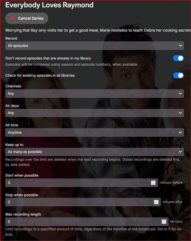

Luke 42239 Posted December 16, 2025 Posted December 16, 2025 On Imdb they are called italy part 1 & 2: https://www.imdb.com/title/tt0115167/episodes/?season=5&ref_=ttep The episode matching by name is already restricting to same season only. There's no real way to avoid this other than unchecking the box about don't record episodes already in the library.
justinrh 266 Posted December 16, 2025 Author Posted December 16, 2025 (edited) Thanks @sa2000 you are awesome! 2 hours ago, Luke said: The episode matching by name is already restricting to same season only. There's no real way to avoid this other than unchecking the box about don't record episodes already in the library. @LukeI don't understand what you are saying. Both episodes are in the same season. Why not match by episode only? It is only the episode that matters, I'd think. Edited December 16, 2025 by justinrh
