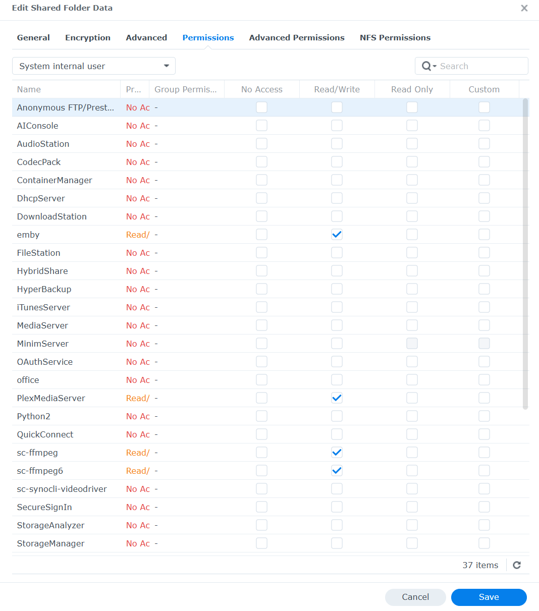

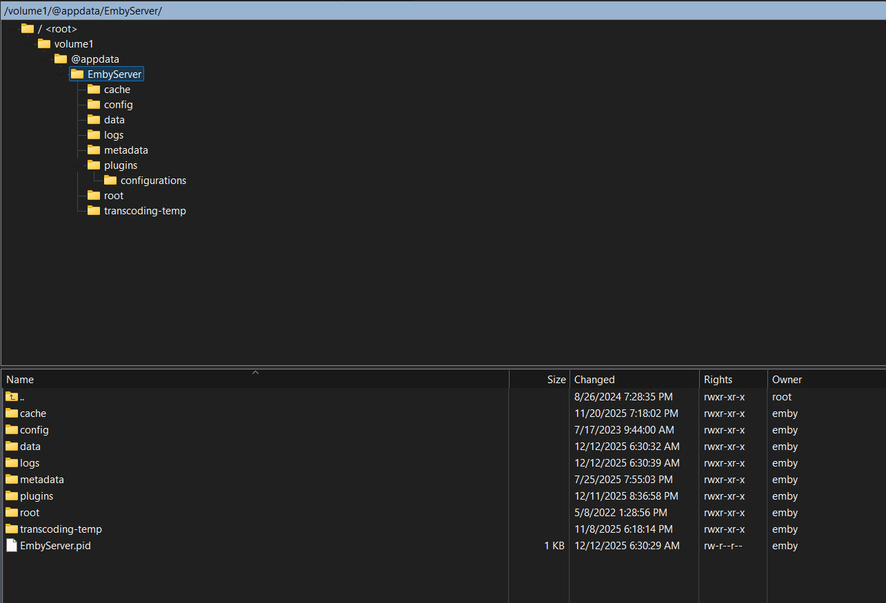

FrostByte 5453 Posted December 12, 2025 Posted December 12, 2025 The only permissions you should have to set are the ones for your shared folders using the system internal user 'emby'. When you installed Emby server it would have set the needed permissions for its folders like in the picture below. It sounds like the script just didn't run for some reason and you need to be su to modify that xml file. The only other method I can think of would be to use command line tools like powershell, terminal, etc. You could copy and then modify the file and save it to your Windows PC. Then copy it back using command line. You will need to do the 'sudo -i' command though to copy it back.

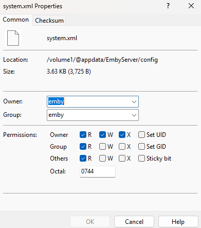

Smeghain 14 Posted December 12, 2025 Author Posted December 12, 2025 (edited) 16 minutes ago, FrostByte said: Just to be sure, the following box is set to run the task as 'root'. You log in as admin, but the script itself runs as root. OK i managed to copy across the system.xml file and had modified the enable remote access and i removed all references to the 192.168.0.* ip address and tried to run emby again, it just comes back in the web browser "Forbidden" Edited December 12, 2025 by Smeghain
FrostByte 5453 Posted December 12, 2025 Posted December 12, 2025 4 minutes ago, Smeghain said: OK i managed to copy across the system.xml file and had modified the enable remote access and i removed all references to the 192.168.0.* ip address and tried to run emby again, it just comes back in the web browser "Forbidden" Can you show me a screenshot of the permissions on the file after you copied it back? Like the one I posted above. If all is fine with the new file then @Lukemay have to jump back in.
Smeghain 14 Posted December 12, 2025 Author Posted December 12, 2025 21 minutes ago, FrostByte said: Can you show me a screenshot of the permissions on the file after you copied it back? Like the one I posted above. If all is fine with the new file then @Lukemay have to jump back in.

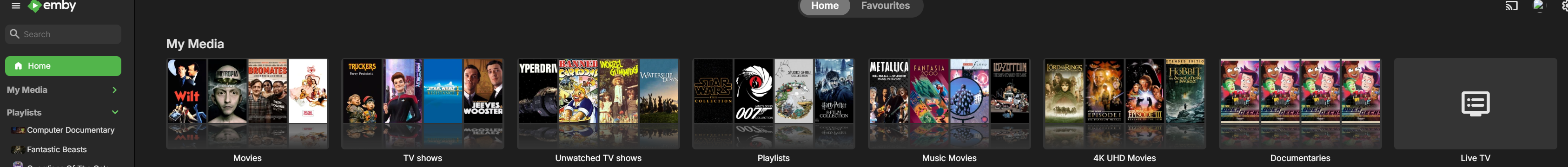

Smeghain 14 Posted December 12, 2025 Author Posted December 12, 2025 9 minutes ago, Smeghain said: Some progress made, ive got back in this far but when i click on anything like movies, nothing is showing up in those ? do i need to remove the movies tv and so on and re add them ?
FrostByte 5453 Posted December 12, 2025 Posted December 12, 2025 Probably can just rescan your libraries
Smeghain 14 Posted December 12, 2025 Author Posted December 12, 2025 1 minute ago, FrostByte said: Probably can just rescan your libraries When i click on the 3 dots, i dont get any options to rescan or such like i normally would when i go in to the libaries in the add libraries theres nothing there, so might just need to readd them ?
FrostByte 5453 Posted December 12, 2025 Posted December 12, 2025 Try from Settings... Scheduled Tasks on the server

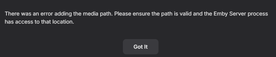

Smeghain 14 Posted December 12, 2025 Author Posted December 12, 2025 Just now, FrostByte said: Try from Settings... Scheduled Tasks on the server I tried to add the libaries back in but i get this error now
FrostByte 5453 Posted December 12, 2025 Posted December 12, 2025 Maybe check your system internal user 'emby' has access to the shared folders you're using
Smeghain 14 Posted December 12, 2025 Author Posted December 12, 2025 11 minutes ago, FrostByte said: Looks like emby has permission to read/write, so not sure why i cant add folders to the libaries
Smeghain 14 Posted December 12, 2025 Author Posted December 12, 2025 (edited) 20 minutes ago, Smeghain said: Looks like emby has permission to read/write, so not sure why i cant add folders to the libaries although im not sure what that would do to help the permissions issue ? I saw a reply in a thread about re-adding libary and they suggested removing libary.db file to fix the problem ? Edited December 12, 2025 by Smeghain
