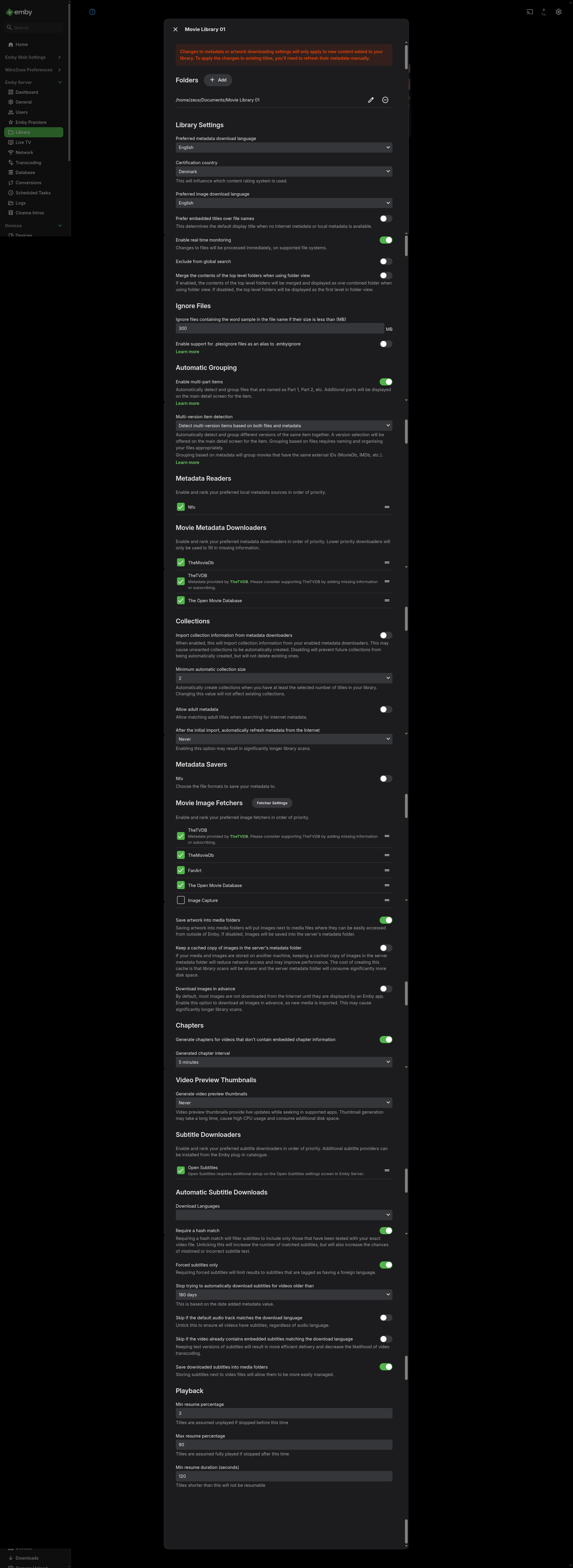

Nitro_Zeus 11 Posted December 10, 2025 Posted December 10, 2025 Hi all, I'm running Emby server on Ubuntu Desktop. I recently updated to the newest version 4.9.1.90, and after that, when I upload new movies to my library folder, and perform a scan, Emby will not find the new movies, i tried searching for them on Emby Web, and the movies are not found. This makes no sense. I have not changed anything, and suddenly, after updating it does not work. I also tried refreshing metadata on the library and scanning library files from the Emby web, makes no difference. See attached PDF for Library config. Has anybody experienced the same issue? All movies are placed in the folder like this: /home/zeus/Documents/Movie Library 01/xxxxxxx 1080p (2008)/xxxxxx.mp4 screencapture.pdf
