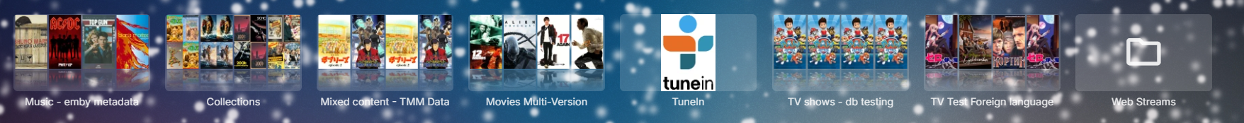

JuJuJurassic 50 Posted December 9, 2025 Posted December 9, 2025 Hi All, The Tune-In plugin isn't appearing on the home screen. I've looked through the server.log, attached, and it appears not to be loading. Can anyone give me any suggestions on how to fix it, please Thanks embyserver(9).txt

JuJuJurassic 50 Posted December 10, 2025 Author Posted December 10, 2025 on the opening home scren, with the libraries
Happy2Play 9814 Posted December 10, 2025 Posted December 10, 2025 12 minutes ago, JuJuJurassic said: on the opening home scren, with the libraries Do you have any Access Restrictions set on the User?
JuJuJurassic 50 Posted December 10, 2025 Author Posted December 10, 2025 (edited) it was there,it just seems to have disappeared, but that was before the upgrade to the current version Edited December 10, 2025 by JuJuJurassic
Luke 42255 Posted December 11, 2025 Posted December 11, 2025 Have you verified that the user who is logged in is granted access to it?

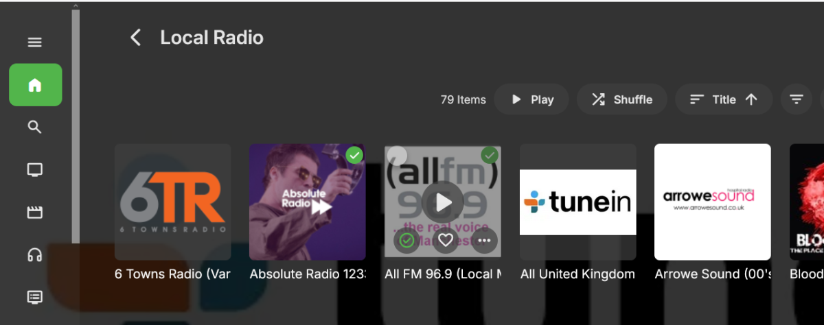

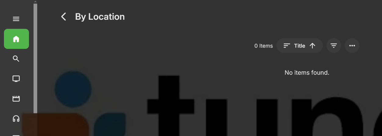

JuJuJurassic 50 Posted December 11, 2025 Author Posted December 11, 2025 (edited) i can't see any restrictions. I removed it, checked the plugins folder and the dll was still there, so I deleted it, rebooted the server and added it, and it's there now. But when I go into it there are no languages/ locations/ Music etc, only Local radio, which works. Local radio has; The channels work, but if you go into "all UK", after drilling down it says no options my lat / long is close enough at (53.793850, -1.752440) I've tested the login id on the TuneIn website, and I've logged in ok. Any ideas? Edited December 11, 2025 by JuJuJurassic

Luke 42255 Posted December 11, 2025 Posted December 11, 2025 Quote But when I go into it there are no languages/ locations/ Music etc, only Local radio, which works. As far as I know this is just the way it is. The TuneIn api returns empty data for some categories. I don't recall if we print anything to the log but it comes back with some kind of restricted message saying they want you to use an official tunein app for that particular content.
JuJuJurassic 50 Posted December 12, 2025 Author Posted December 12, 2025 Hi Luke, Previously, in Locations it would ask you the area, Europe, then the country, then the city. Non of these are now available. Chatgpt says there was a update on the community boards, but I can't find it. it offered to patch the current version for me, but I tried and failed. If I could share the chatGPT link I would , but it basically said tune in initialised then died. Have a go, it's quite interesting. Is there a solution? Thanks

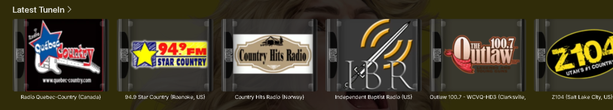

Dibbes 515 Posted December 17, 2025 Posted December 17, 2025 (edited) 11 hours ago, Luke said: Have you explored the options for the plugin? Got the same issues here, just local radio that has any stations. The options just ask for a username and lat/lon, nothing else. Interestingly, the main page does give unrelated stations on the bar, just nothing in the folders: Have the feeling TuneIn changed a few things since this plugin was released... Edited December 17, 2025 by Dibbes
Dibbes 515 Posted December 17, 2025 Posted December 17, 2025 53 minutes ago, Luke said: Have you explored configuring lat Lon? I did, I just took that and my username out for screenshotting purposes. It's there normally
