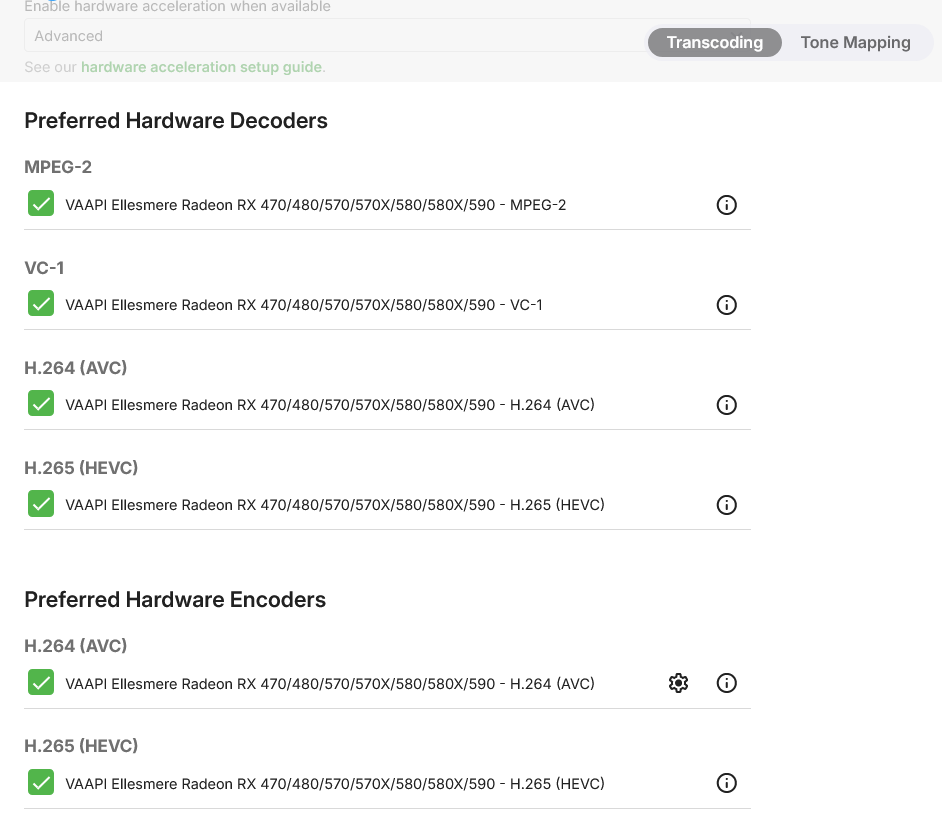

bunty_sam 0 Posted December 9, 2025 Posted December 9, 2025 Hi, I am trying to enable full hardware transcoding on Emby using Docker on Linux. I have an AMD RX570 (Polaris) GPU and Emby Premiere. Hardware acceleration is enabled in the dashboard and VAAPI decoders are listed correctly. The issue so far I have identified is that Emby uses VAAPI for hardware decode, but video encoding continues to fall back to software, causing ffmpeg to use the CPU heavily during transcoding. GPU load remains low and the dashboard shows “Software Encoder” for the video stream. I have confirmed the following: /dev/dri/renderD128 and /dev/dri/card0 are passed into the container Correct render and video group permissions inside container Hardware decoding appears to be working Tone mapping enabled, hardware acceleration enabled, VAAPI selected ffmpeg -encoders inside the container shows h264_vaapi and hevc_vaapi, but both are listed as decode-only (with a D flag). There is no AMF hardware encoder present (h264_amf or hevc_amf). On Jellyfin, the same GPU appears to handle transcoding much more smoothly and CPU usage remains low, which makes me believe RX570 hardware encoding should be possible under Linux. But Emby always falls back to CPU for video encoding. How can I fix this issue? Because I just bought the lifetime emby premiere license and facing this issue. System details: Debian 13 (trixie) Docker GPU: AMD RX570 4 GB Emby Server image: emby/embyserver:latest Hardware acceleration enabled in Emby This is my Docker YML configuration services: emby: image: emby/embyserver:latest container_name: emby environment: - PUID=1000 - PGID=1000 - TZ=Asia/Kolkata group_add: - "44" # video - "105" # render networks: - proxy security_opt: - no-new-privileges:true volumes: - ./emby_data/config:/config - /mnt/Seedbox/downloads/torrents/Movies:/data/movies - /mnt/Seedbox/downloads/torrents/TV_Shows:/data/tvshows ports: - 8096:8096 - 8920:8920 #optional devices: - /dev/dri:/dev/dri restart: unless-stopped labels: - "traefik.enable=true" - "traefik.http.routers.emby.entrypoints=https" - "traefik.http.routers.emby.rule=Host(`emby.xx.eu`)" - "traefik.http.routers.emby.tls=true" - "traefik.http.routers.emby.tls.certresolver=cloudflare" - "traefik.http.routers.emby.service=emby" - "traefik.http.services.emby.loadbalancer.server.port=8096" networks: proxy: external: true I have attached the settings from the advanced tab under Transcoding menu and also a screenshot of system usage using btop and radeontop when a transcoding was triggered. Any guidance from the team or other users who have this working would be appreciated. I am happy to provide logs or run additional diagnostics if needed. Thanks in advance.

Q-Droid 1011 Posted December 9, 2025 Posted December 9, 2025 As you said it's detecting your hardware then tries to use HW accel to decode and encode but fails and falls back to software. The error appears to be the same for both examples. Likely something support/devs would have to look into. 20:35:10.876 [AVHWDeviceContext @ 0x25b55500] Failed to get number of OpenCL platforms: -1001. 20:35:10.876 [hwmap@f2 @ 0x25be9640] Failed to created derived device context: -19. 20:35:10.876 [hwmap@f2 @ 0x25be9640] Failed to configure output pad on hwmap@f2 20:35:10.877 Error reinitializing filters! 20:35:10.877 Failed to inject frame into filter network: No such device 20:35:10.877 Error while processing the decoded data for stream #0:0 20:35:10.881 [aac @ 0x25b153c0] Qavg: 166.260 20:35:10.881 [aac @ 0x25b153c0] 2 frames left in the queue on closing 20:35:10.884 Conversion failed! 20:35:10.884 EXIT 1

bunty_sam 0 Posted December 10, 2025 Author Posted December 10, 2025 7 hours ago, Q-Droid said: Is it only when tone mapping? Have you tried transcoding media that doesn't require tone mapping? There are some other threads for similar problems. You might want to monitor and post there too since they seem to have more attention from the devs. Indeed, if I force transcoding on a non-HDR file my GPU is handling the transcoding tasks, and if it is HDR then switching to CPU. embyserver.txt ffmpeg-transcode-42237cb5-7f74-4df5-9567-dccf16a29dc6_1.txt hardware_detection-63901011842.txt
Lessaj 484 Posted December 10, 2025 Posted December 10, 2025 Seems to confirm what I said in the other topic that HDR tone mapping still doesn't work on AMD GPUs. From some light research it looks like Jellyfin has this working on all AMD GPUs that have HEVC 10-bit decoding, maybe an ffmpeg update is needed (and long overdue).
