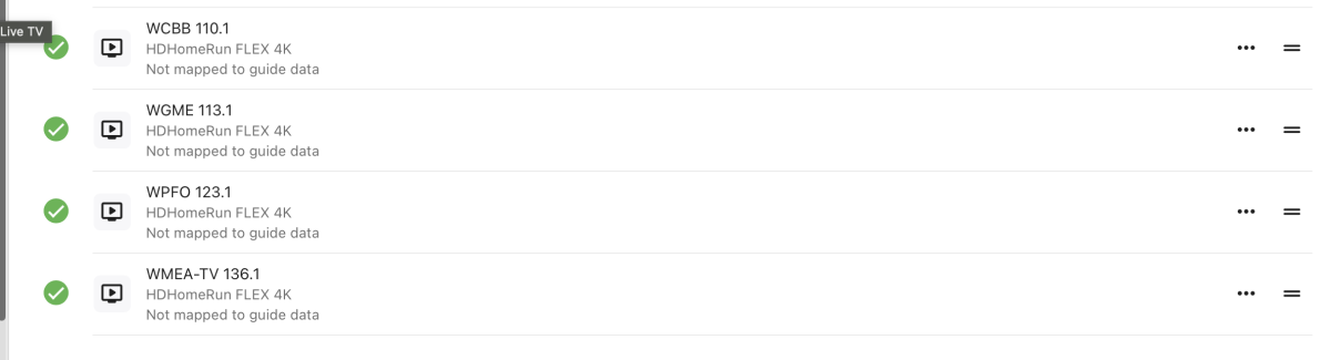

jsq12 0 Posted December 8, 2025 Posted December 8, 2025 Zip Code 04222 The following channels are missing guide data: 8.6 MeTV Toons 110.1 WCBB - PBS 113.1 WGME - CBS 123.1 WPFO - FOX 136.1 WMEA - PBS

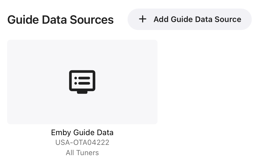

sa2000 695 Posted December 8, 2025 Posted December 8, 2025 4 hours ago, jsq12 said: Zip Code 04222 The following channels are missing guide data: 8.6 MeTV Toons 110.1 WCBB - PBS 113.1 WGME - CBS 123.1 WPFO - FOX 136.1 WMEA - PBS What is the lineup identifier ? You can see that in Server Settings / Live TV / Setup screen under "Emby Guide Data" For zip code 04222 I can only see OTA channel numbers up to 51.x https://www.channelmaster.com/pages/tv-antenna-map-durham-me-04222#address=04222

sa2000 695 Posted December 9, 2025 Posted December 9, 2025 (edited) 23 minutes ago, jsq12 said: Yes that works. Still need 8.6 MeTV Toons added. Thanks for confirming OTA channel numbers over 100 are wrong - you could ask Silicondust why that happens. Update: could be because they are ATSC 3.0 channels - which i am not sure would be supported. 110.1 WCBB - PBS This is channel 10.1 so can be mapped manually to that 113.1 WGME - CBS This is channel 13.1 so can be mapped manually to that 123.1 WPFO - FOX The lineup has 23.1 as ROARTV which is wrong I believe for the Portland, Maine market. I will mention this to Gracenote 136.1 WMEA-TV - PBS I can't see any 36.x channels for your zip code on channelmaster.com here It could be 26.1 As with regards to 8.6 MeTV Toons: I will ask gracenote to look into adding the channel but channelmaster.com is showing it as a weak signal channel - so there is a risk that it may not get added for that reason Edited December 9, 2025 by sa2000
jsq12 0 Posted December 9, 2025 Author Posted December 9, 2025 (edited) They're not wrong per say, they are just the ATSC 3.0 channels in our market. Edited December 9, 2025 by jsq12
