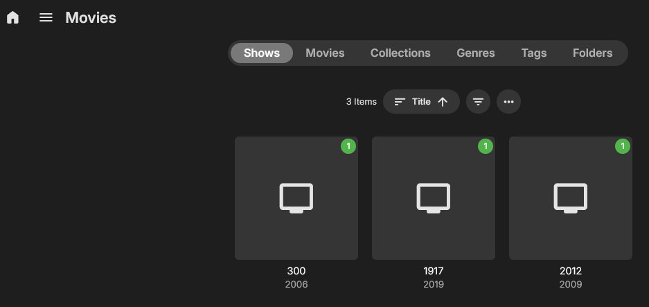

Alcyone7 10 Posted December 7, 2025 Posted December 7, 2025 After upgrading the server to the latest version, 3 movies have now been miss identified (previous perfectly fine) to SHOWS instead. No matter what, the server insists they're shows and even if I manually identify them using an IMDB ttxxxxxx reference, the server refuses to accept this. When clicking on the MOVIE tab, instead of showing the movies in the library, it now insists on showing the folders. The 3 movies in question are: 300 1917 2012 At first it seemed to be titles with numerical only names, however the filn 65 is just fine. I have tried removing them, updating the library, waiting a minute or two, then adding them back - but I get the same results. Any ideas on how to fix this problem?
GrimReaper 5265 Posted December 7, 2025 Posted December 7, 2025 How are your files named and organized? What are root folders of that library? Is there particular reason it has to be Mixed content-type library instead of dedicated type one?
Alcyone7 10 Posted December 7, 2025 Author Posted December 7, 2025 (edited) Organised as it was before the update. The library is a MOVIE content type only (always has been). The folder MOVIES has a folder for each film, with name and year, with files inside using same name minus the year MOVIES\300 (2006)\300.mp4 Never had any issue with the library until the update. Edited December 7, 2025 by Alcyone7
GrimReaper 5265 Posted December 7, 2025 Posted December 7, 2025 4 minutes ago, Alcyone7 said: The library is a MOVIE content type only (always has been). This screenshot does not show that, it is a screenshot from Mixed content type library. 45 minutes ago, Alcyone7 said: You can't have "Shows" tab in Movie type library and you'd have some additional tabs if it were.
