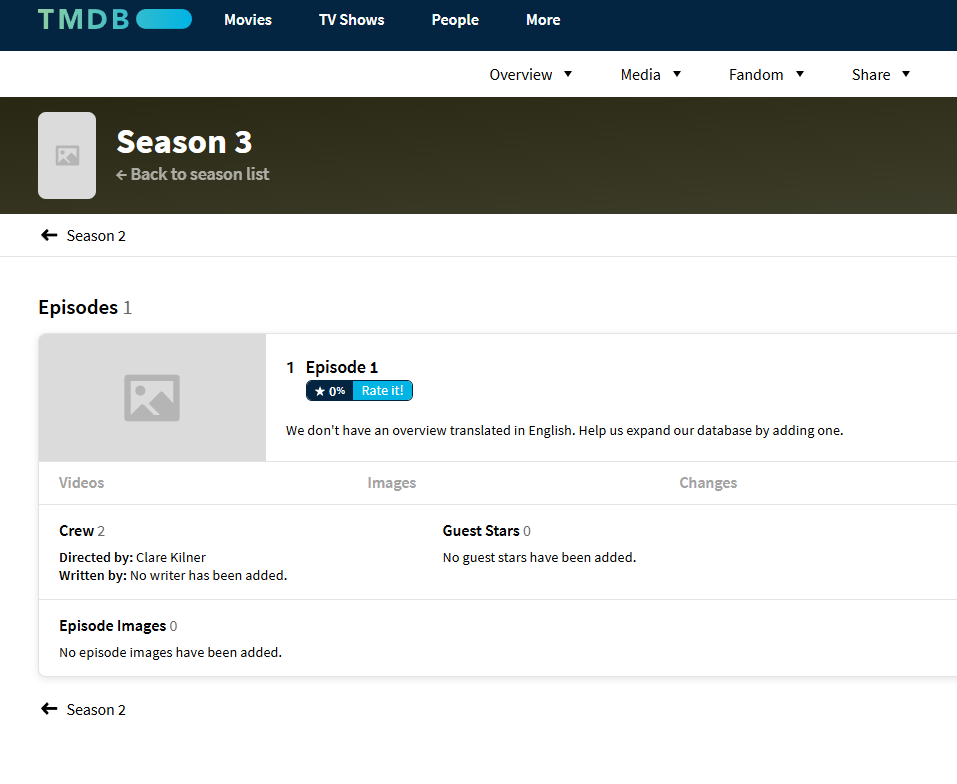

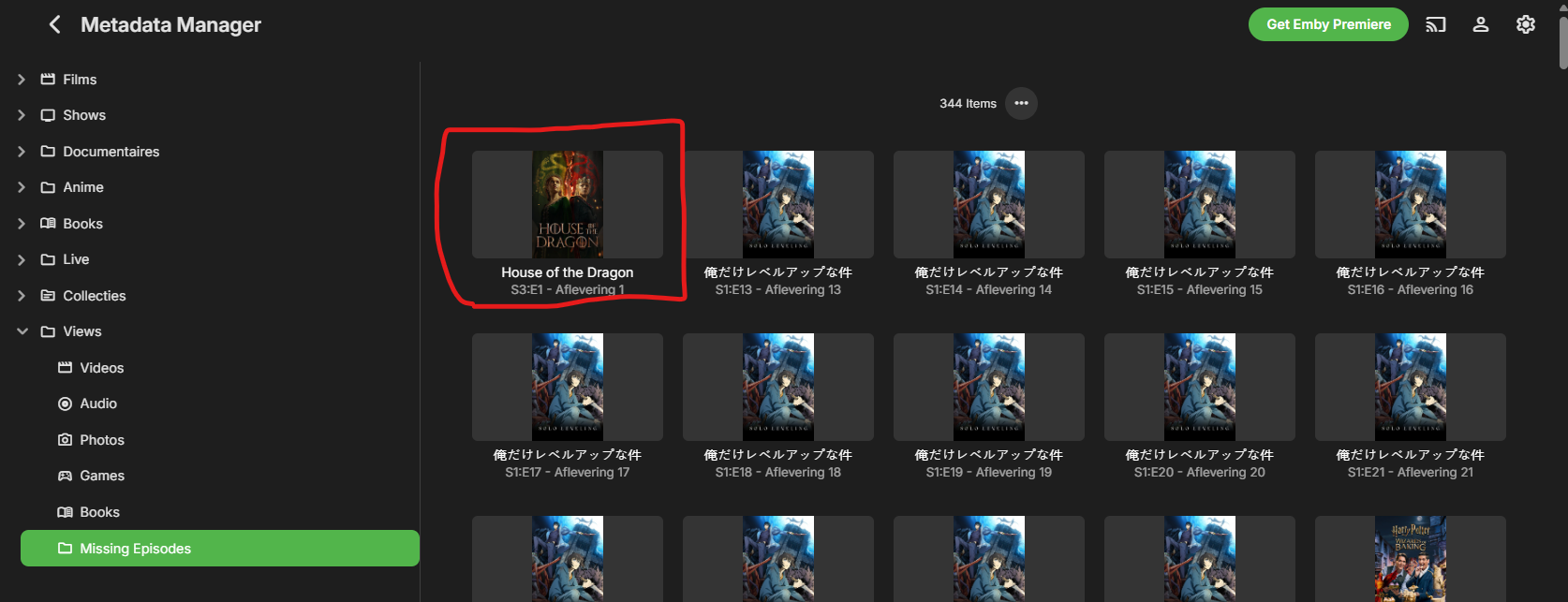

brothom 211 Posted December 7, 2025 Posted December 7, 2025 I've been going back and forth with the meta data providers (tmdb, tvdb, etc) about "empty" episodes being added without an air date which are consequentually detected as "missing episodes" within Emby somehow. An example would be House of the Dragon - s03e01. This is shown as a missing episode eventhough it's empty and has no air date: https://www.themoviedb.org/tv/94997-house-of-the-dragon/season/3/episode/1 Is there something we can do to prevent these episodes from showing up as missing episodes? I had the issue before where "someone" had added Wednesday Season 03 to TheMovieDB (eventhough there's nothing known about it yet) and those items immediately showed up under "Missing Episodes". I prefer to use the "Missing Episodes" feature because it prevents me looking up in a bunch of repositories if something has aired or not. Thanks in advance!

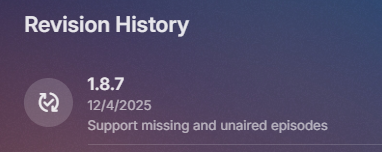

Happy2Play 9814 Posted December 8, 2025 Posted December 8, 2025 (edited) 2 minutes ago, brothom said: Yep, that's the reproduction case! Tvdb has many other issues which is why I prefer tmdb. But looking closer at the issue it boils down to a missing air date apparently. Maybe we can work with that somehow to prevent false positives also coming from other providers with brackish data. Since it was just added to the plugin I will guess there may be other quirks like this. May have to look at what the api is returning also. Edited December 8, 2025 by Happy2Play
brothom 211 Posted December 8, 2025 Author Posted December 8, 2025 1 minute ago, Happy2Play said: Since it was just added to the plugin I will guess there may be other quirks like this. Hm that also explains other random seasons and episodes appearing. Is this plugin maintained by Emby or a third party?
Happy2Play 9814 Posted December 8, 2025 Posted December 8, 2025 1 minute ago, brothom said: Hm that also explains other random seasons and episodes appearing. Is this plugin maintained by Emby or a third party? Emby

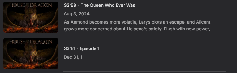

Happy2Play 9814 Posted December 8, 2025 Posted December 8, 2025 (edited) Looks like Luke needs to exclude missing air_date or have them fall under Upcoming but that I think only applies to individual Missing reports. from my example "air_date": "2024-08-04T00:00:00.0000000Z", "episode_number": 8, "name": "The Queen Who Ever Was", "overview": "As Aemond becomes more volatile, Larys plots an escape, and Alicent grows more concerned about Helaena's safety. Flush with new power, Rhaenyra looks to press her advantage.", "id": 5234730, "production_code": "", "season_number": 2, "still_path": "/1XuMwNuO3BKUXFCQCOoC4qcdvKi.jpg", "vote_average": 6.612, "episode_number": 1, "name": "Episode 1", "overview": "", "id": 6086485, "production_code": "", "season_number": 3, "vote_average": 0, "vote_count": 0 Edited December 8, 2025 by Happy2Play
