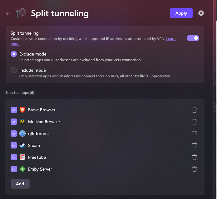

Bradum 15 Posted December 7, 2025 Posted December 7, 2025 Hi All, I am running an Emby server that I have friends connecting to remotely. I recently started running a system-wide VPN (Proton VPN) but I have Emby and Emby Server set as exceptions to not use the VPN; for some reason this is still causing people to not be able to connect when the VPN is active. Is there another program or service I need to add as an exception to the VPN, or is there something else I'm missing? Thanks in advance!

Bradum 15 Posted December 8, 2025 Author Posted December 8, 2025 (edited) 1 hour ago, Tur0k said: Did you implement proton VPN connection on the Emby server host or the firewall/router? I have Emby Server set as an exception for my VPN, so they shouldn't be running through it. Edited December 8, 2025 by Bradum

Bradum 15 Posted December 8, 2025 Author Posted December 8, 2025 That makes sense. You have to use the split-tunneling feature so it's available via LAN rather than being funneled through the VPN. 1

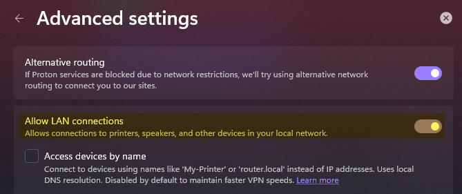

Bradum 15 Posted December 14, 2025 Author Posted December 14, 2025 On 12/10/2025 at 11:16 AM, crusher11 said: Split tunneling doesn't seem to be working either. I tried excluding my browser, and I tried excluding my Emby LAN IP, no dice. Split tunneling works for me. Are you excluding Emby Server itself? There's also a setting under Advanced Settings called "Allow LAN Connections" which you probably want to enable.
crusher11 1153 Posted December 14, 2025 Posted December 14, 2025 (edited) 17 minutes ago, Bradum said: Split tunneling works for me. Are you excluding Emby Server itself? The server isn't running on the same machine as the VPN. The LAN setting is on by default. Edited December 14, 2025 by crusher11
crusher11 1153 Posted December 14, 2025 Posted December 14, 2025 It appears my entire Synology NAS—which is what's running my server—is inaccessible with the VPN active. Can't even browse it in Windows Explorer. No such issues with my TrueNAS though, that continues to work just fine.
Bradum 15 Posted December 15, 2025 Author Posted December 15, 2025 22 hours ago, crusher11 said: It appears my entire Synology NAS—which is what's running my server—is inaccessible with the VPN active. Can't even browse it in Windows Explorer. No such issues with my TrueNAS though, that continues to work just fine. Did you enable "Allow LAN connections"?
pwhodges 2039 Posted December 15, 2025 Posted December 15, 2025 2 hours ago, Bradum said: Did you enable "Allow LAN connections"? On 14/12/2025 at 15:42, crusher11 said: The LAN setting is on by default.

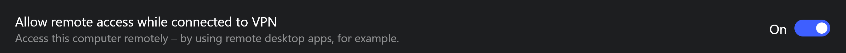

Chillout 113 Posted December 15, 2025 Posted December 15, 2025 Does Proton have a setting to allow remote connections similar to what Nord VPN has in user settings?

crusher11 1153 Posted December 18, 2025 Posted December 18, 2025 Scratch that, checking the “access devices by name” setting has resolved the issue. 1 1
