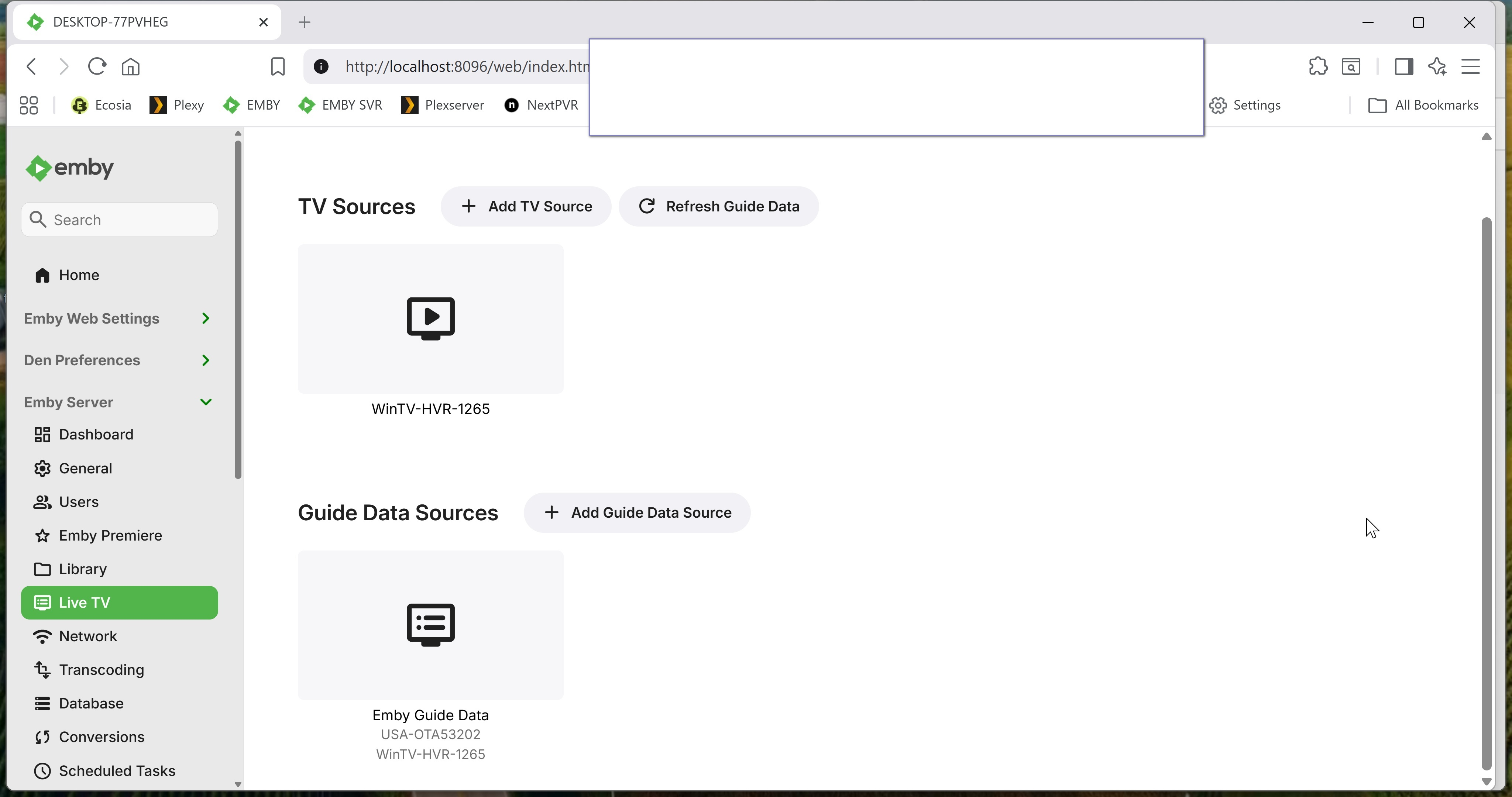

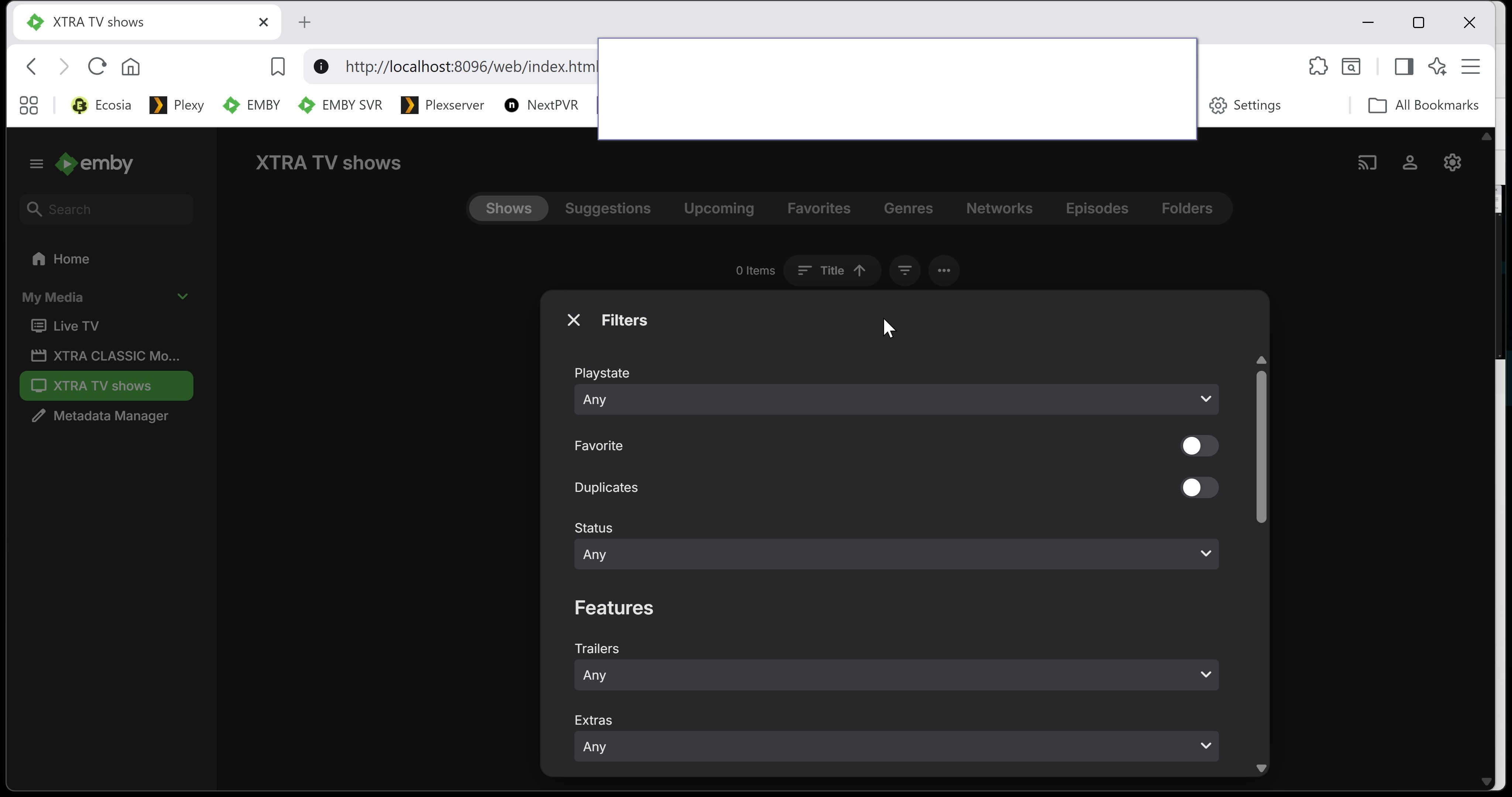

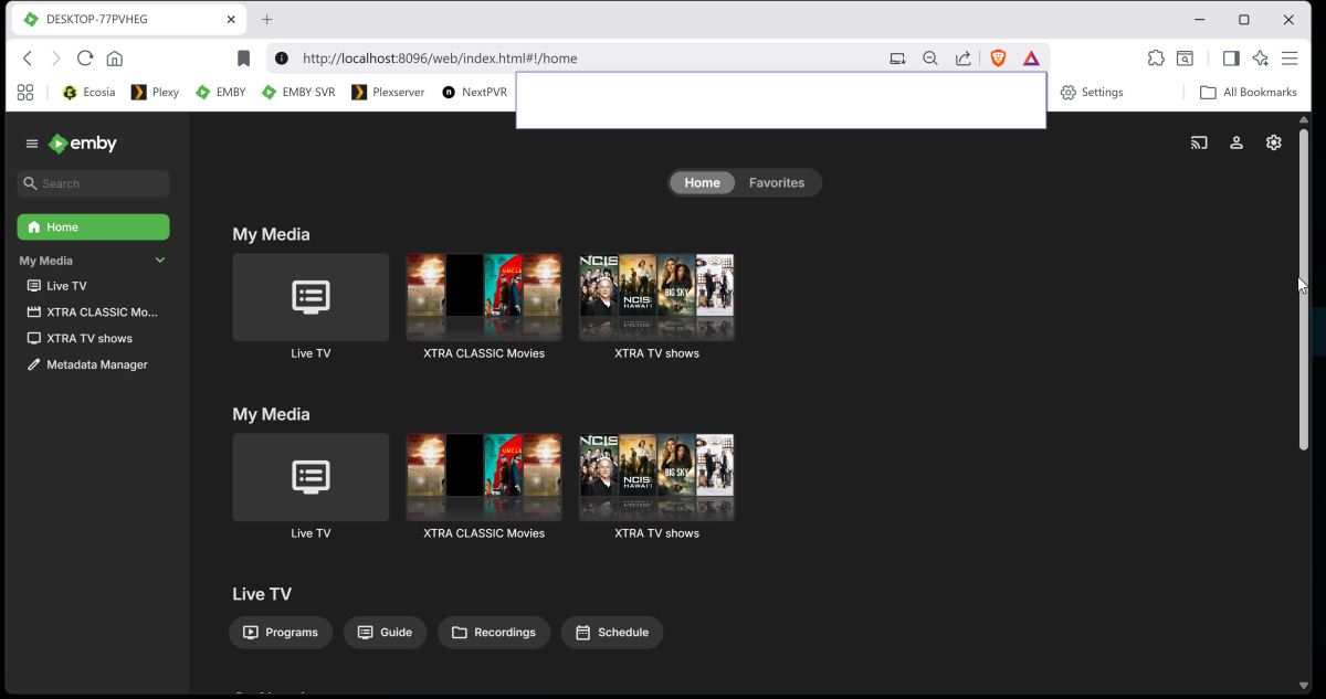

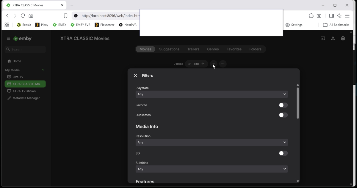

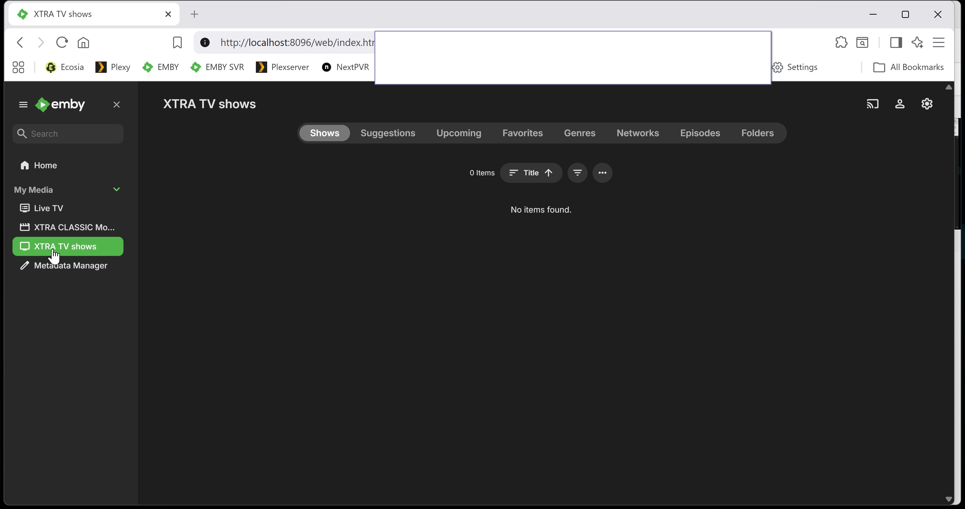

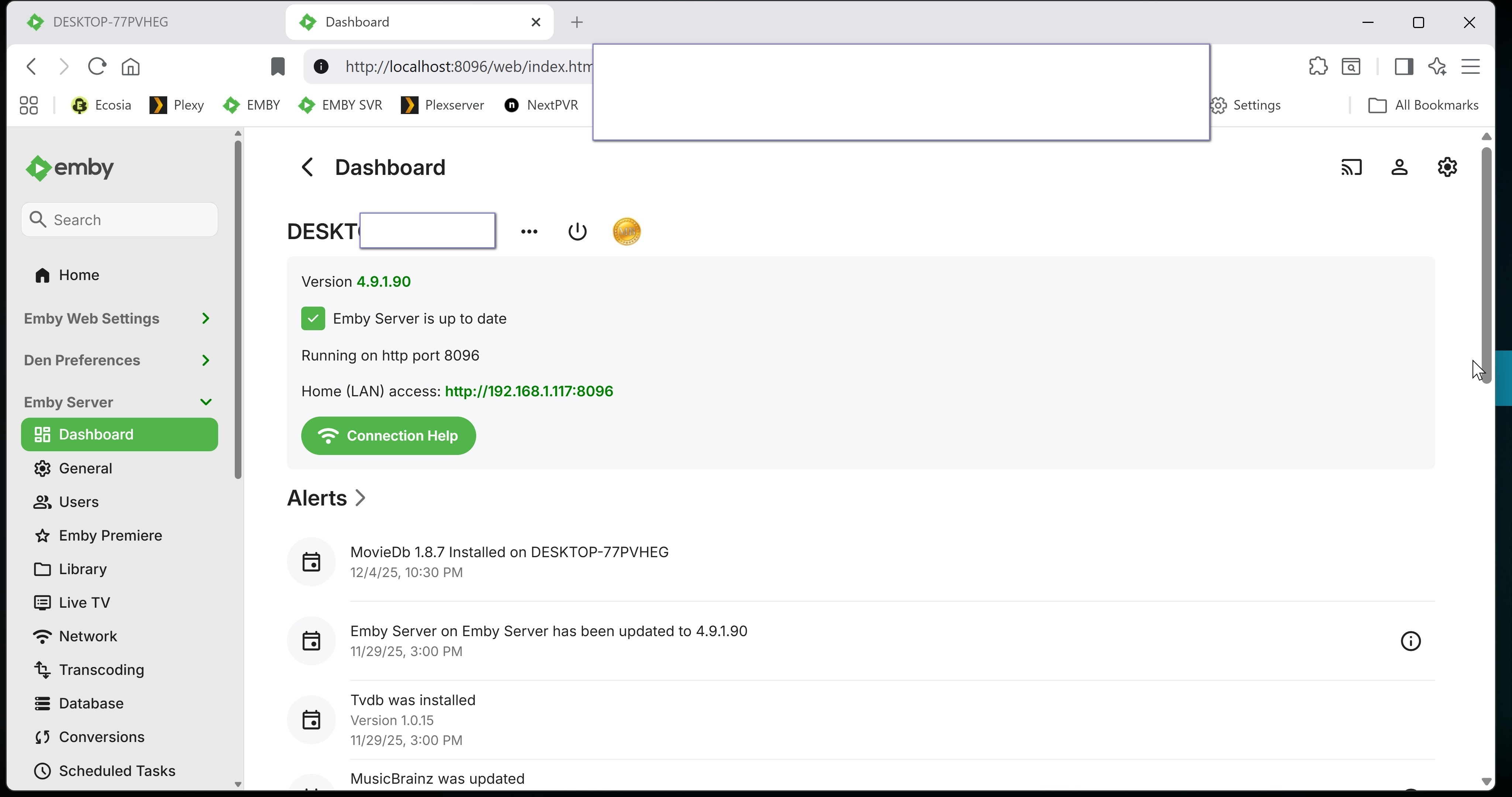

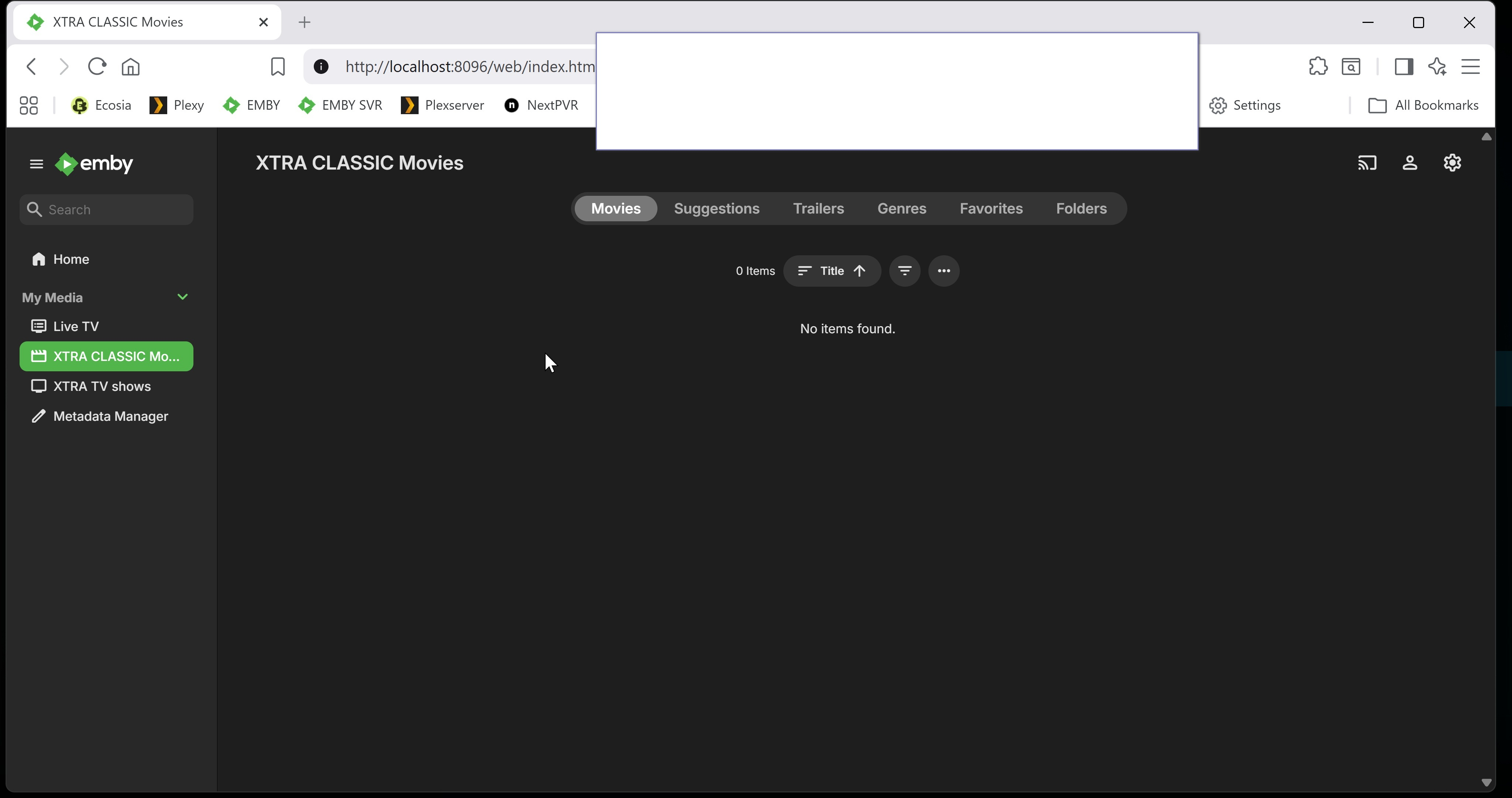

carefulkelly 4 Posted December 5, 2025 Posted December 5, 2025 I am having the same problem as original poster; using premiere (recently installed) on windows 11; however I have attempted the suggested changes and still see no TV guide info. While investigating this I noticed from the outset that I was unable to pull in any tv guide data updates. This endures. When I click the update box in settings/live tv the green update line still simply flashes momentarily and never progresses. I do have a filter in place, but that is just to limit the display of local OTA channels (looking forward to a direct fix for that in future) and I am confident that this filter is not affecting the guide data results (which were not displaying even before i created it). Now the issue has expanded. While I did originally see my tv shows and movies, and their cover-icons (as the attached screenshots show), since I followed your suggested changes including deleting the contents of the data folder* , my movies and tvshows no longer display at all. See attached screenshot indicating that the movie guide data was just updated but tv has not. *My data folder was not the C:\Users\MediaServer\AppData\Roaming\Emby-Server\programdata\cache\httpclient you posted as that did not exist but I had a folder C:\Users\[My username]\AppData\Roaming\Emby-Server\programdata\cache\httpclient and that is where I made the deletion of the files. I also run plex and nextpvr. They work as expected using the same hauppauge card. Thanks for your input.

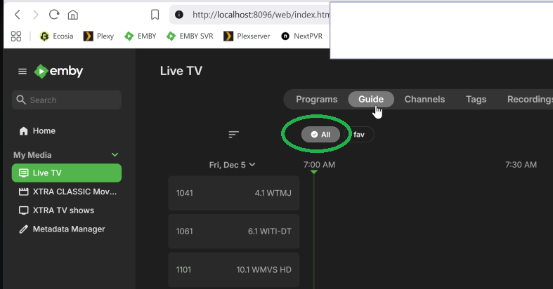

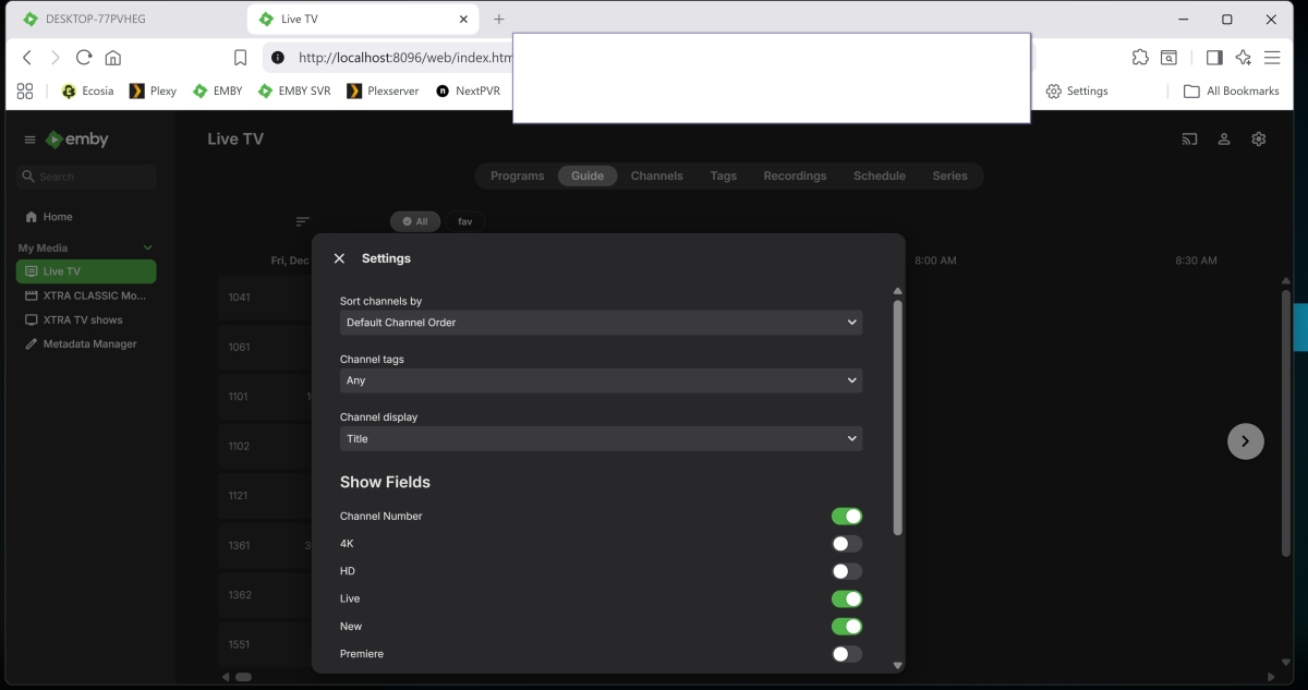

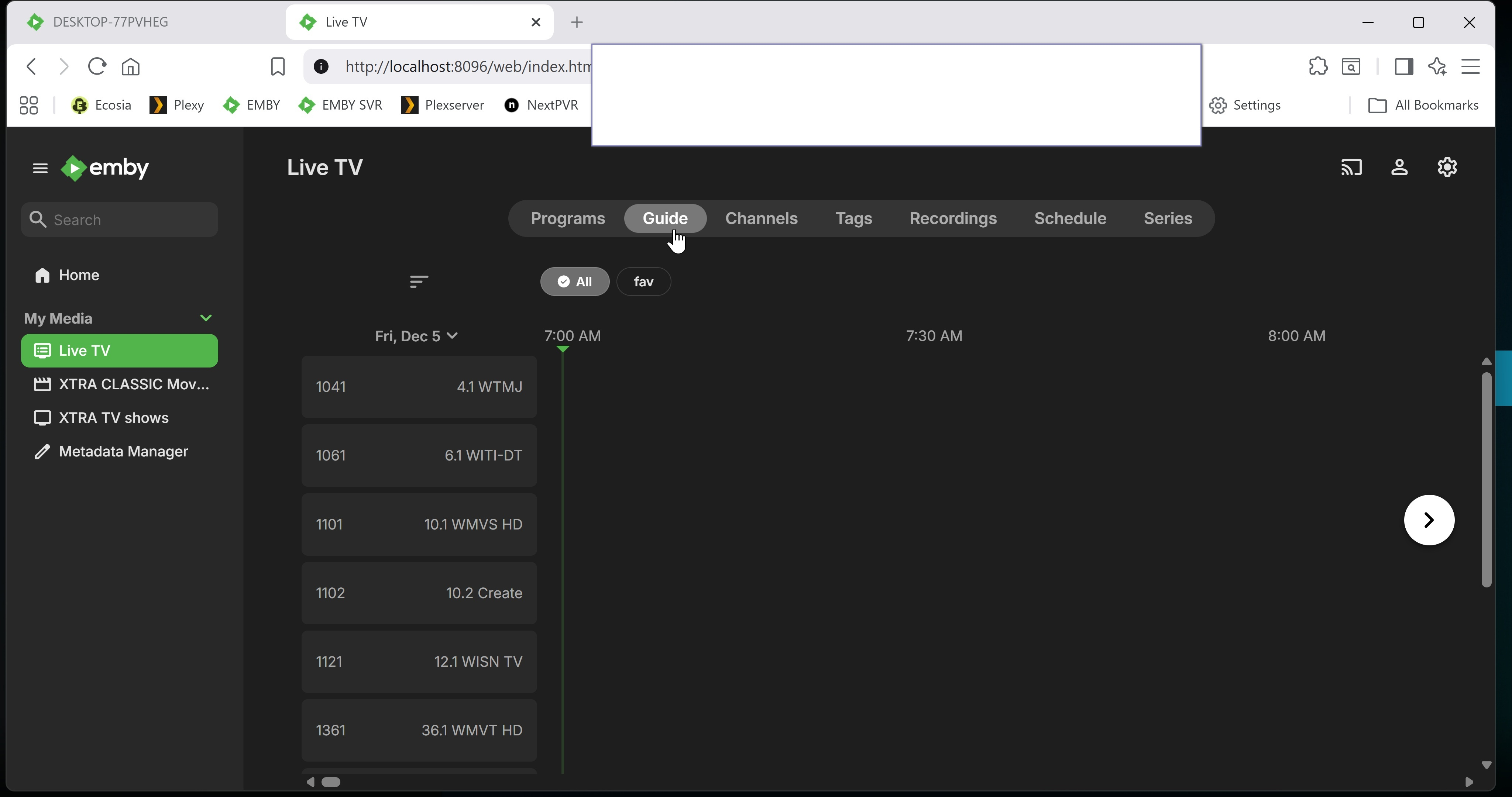

sa2000 695 Posted December 5, 2025 Posted December 5, 2025 @carefulkellyYou could see if it is to do with the filter by clicking on the "All" icon in the Live TV / Guide view and see if that resolves the issue If it is to do with Guide Data, then you could go to server settings / live tv / and click on Refresh Guide Data and on completion check the Live TV / Guide view and if still wrong, download the embyserver log and attach
Luke 42234 Posted December 5, 2025 Posted December 5, 2025 @carefulkellyalso have you checked the channel mappings in the server setup to ensure that all of your tuner channels are mapped to guide channels?
carefulkelly 4 Posted December 6, 2025 Author Posted December 6, 2025 Thanks. I have checked "enable for all tuner devices " (previously unchecked) and rebooted. As for any more direct mapping I am unsure of how to do that. Guide data is still not showing as downloading nor has there been a dashboard alert indicating a more recent guide installation and guide area remains blank.

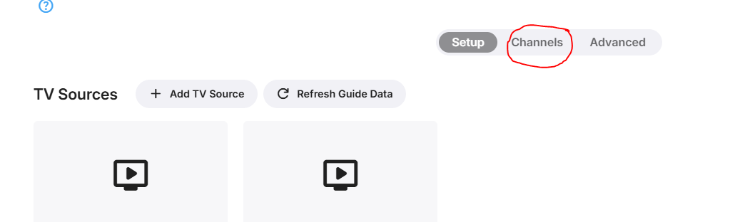

ebr 16331 Posted December 7, 2025 Posted December 7, 2025 Hi. Click here and ensure your channels are mapped to guide data.
