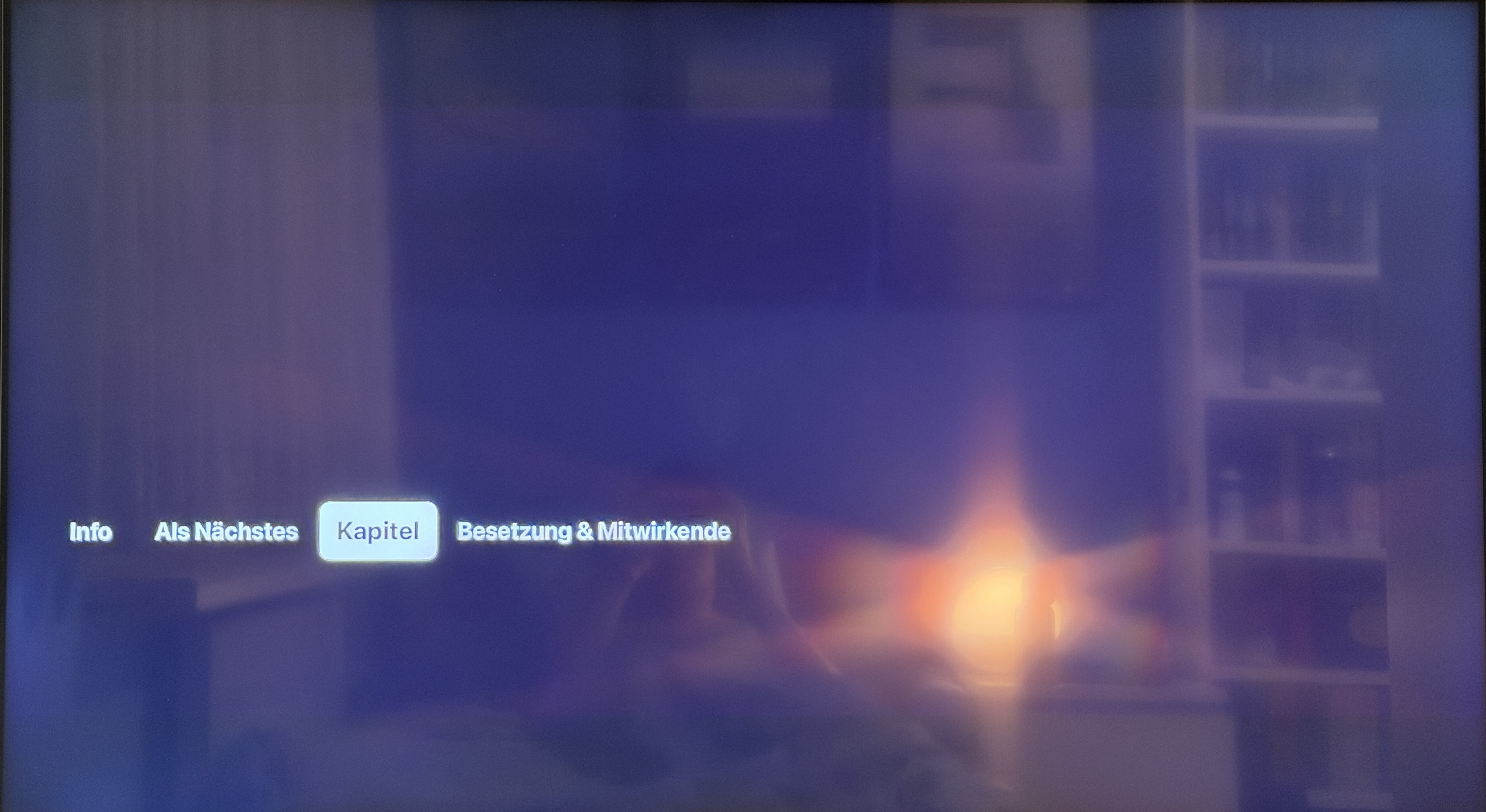

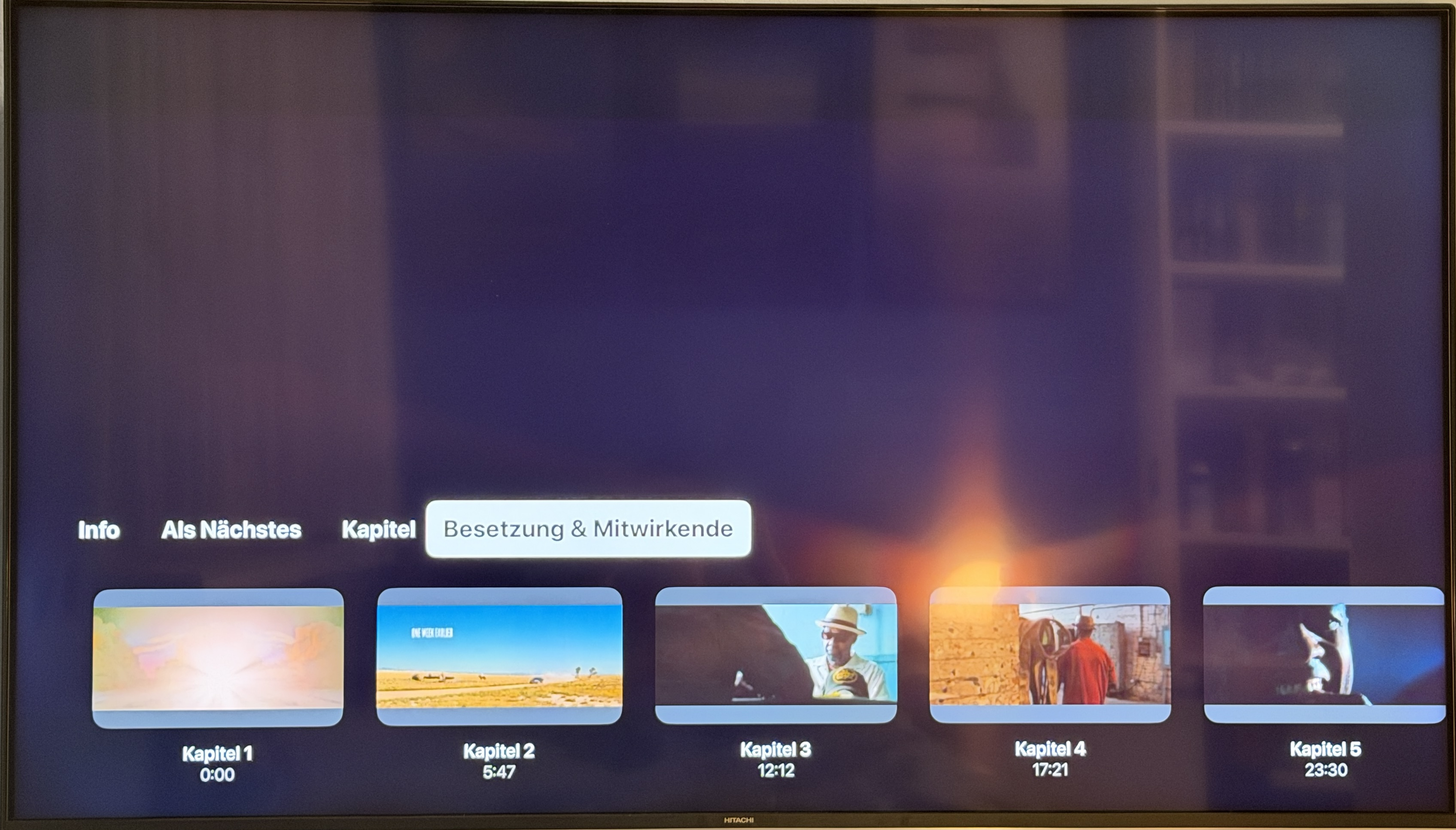

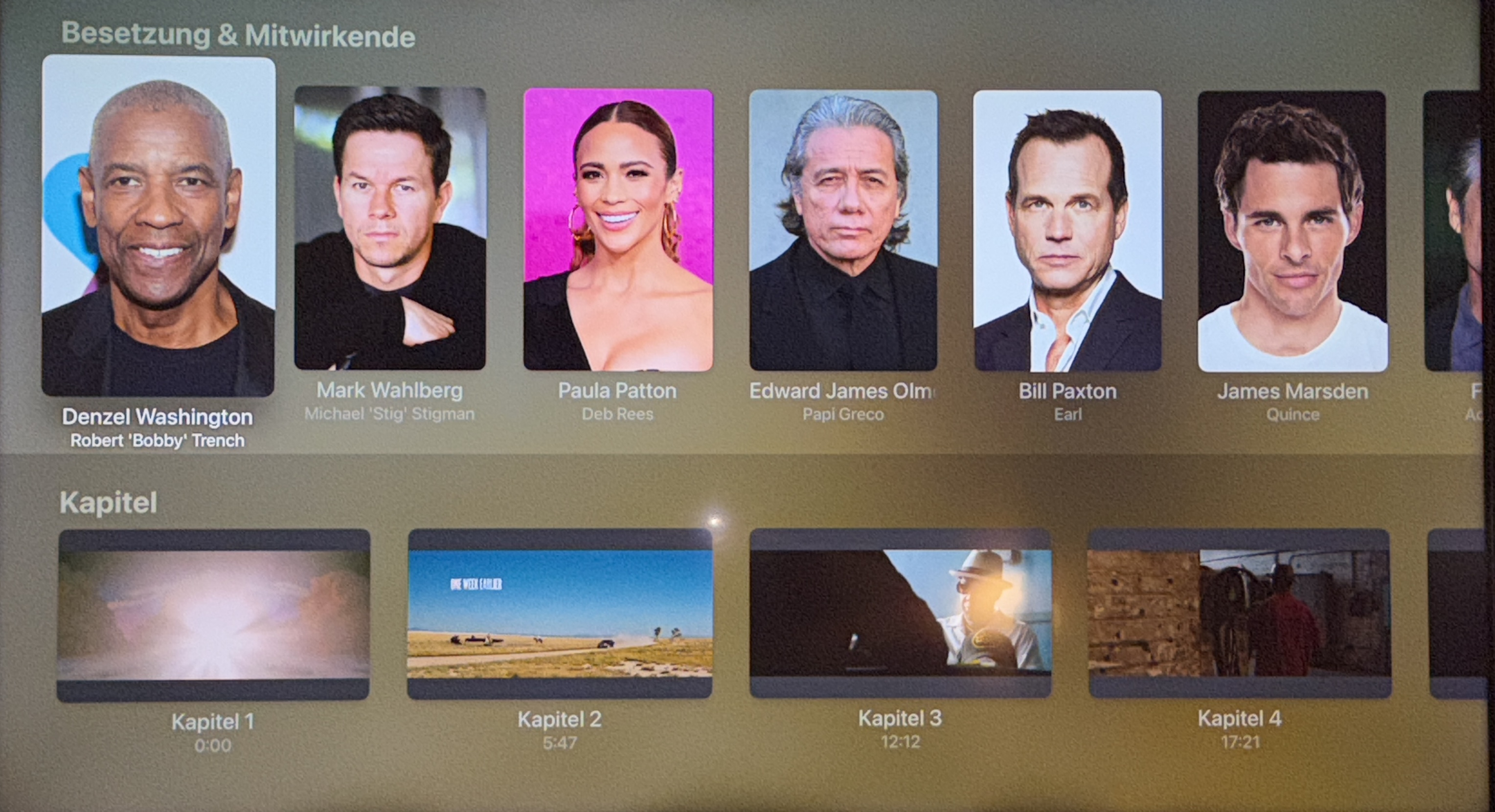

SultanOfTux 5 Posted December 4, 2025 Posted December 4, 2025 Hi everyone, I've found a weird bug in the latest Emby Apple TV app (Version 2.0.2, Server 4.1.4.1.90, Apple TV 4K latest Gen). During movie playback (swipe/touch for overlay), Cast and Chapters sections are swapped or empty – only affects movies, series work perfectly: Movie with Cast but no Chapters: Cast section completely empty. Movie with both: Chapters section empty, Cast incorrectly shows chapter markers/titles instead of actors. Server metadata is correct (NFO/scan OK). Anyone else seeing this or have ideas? Thanks for your help! @SamES

SamES 1084 Posted December 6, 2025 Posted December 6, 2025 On 05/12/2025 at 08:35, SultanOfTux said: Hi everyone, I've found a weird bug in the latest Emby Apple TV app (Version 2.0.2, Server 4.1.4.1.90, Apple TV 4K latest Gen). During movie playback (swipe/touch for overlay), Cast and Chapters sections are swapped or empty – only affects movies, series work perfectly: Movie with Cast but no Chapters: Cast section completely empty. Movie with both: Chapters section empty, Cast incorrectly shows chapter markers/titles instead of actors. Server metadata is correct (NFO/scan OK). Anyone else seeing this or have ideas? Thanks for your help! @SamES Hi, Can you please confirm two things for me from your screenshots Is this playback of Movies in a Playqueue? Do you have Cinema Intros or pre-roll trailers enabled? Thanks
SultanOfTux 5 Posted December 6, 2025 Author Posted December 6, 2025 Hi, The movies are not directly part of a play queue; they are just normal individual movies. Yes, I have an audio codec–based intro. I turned off Cinema Intros for testing, and then the chapters and cast were actually displayed correctly again. So it only happens when I enable the Cinema Intros.
SamES 1084 Posted December 6, 2025 Posted December 6, 2025 Thanks, I can see where the problem is. That helps to confirm that I've found the same problem that you're seeing.
