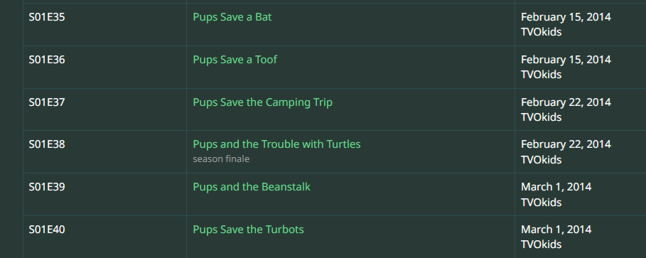

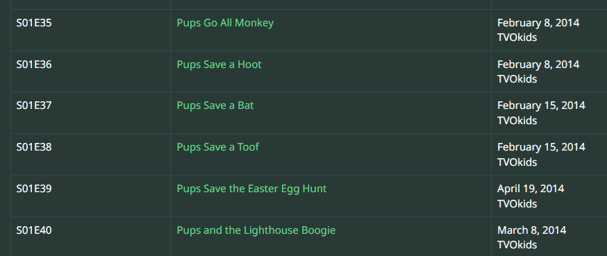

sa2000 703 Posted December 10, 2025 Posted December 10, 2025 Thanks for the database and the updated nfo for Paw Patrol S01E39-E40 There are inconsistencies in the data in the nfo which appear to relate to thetvdb changes to introduce "US Airing Order". So at some point the metadata had the episode titles based on the "US Airing Order" rather than the default "Aired Order". Whilst the title and original title are now based on the Aired Order, the sortname field still has the US Airing Order title. Not sure what we update on refreshes and it is possible some fields are not. thetvdb has these titles for the different airing date orders AirDate Order: E39 - Pups and the Beanstalk E40 - Pups save the turbots US Airing Date order: E39 - Pups Save the Easter Egg Hunt E40 - Pups and The Lighthouse Boogie Your nfo has the following now E39 <title>Pups Save the Easter Egg Hunt</title> <originaltitle>Pups and the Beanstalk / Pups Save the Turbots </originaltitle> <sorttitle>Pups Save the Easter Egg Hunt, Pups and the Lighthouse Boogie</sorttitle> <imdbid>tt3461700</imdbid> <tvdbid>4856019</tvdbid> <uniqueid type="tvdb">4856019</uniqueid> <uniqueid type="imdb">tt3461700</uniqueid> <episode>39</episode> <season>1</season> <aired>2014-04-13</aired> E40 <title>Pups and the Lighthouse Boogie</title> <originaltitle>Pups and the Beanstalk / Pups Save the Turbots </originaltitle> <sorttitle>Pups Save the Easter Egg Hunt, Pups and the Lighthouse Boogie</sorttitle> <episode>40</episode> <season>1</season> <aired>2014-04-13</aired> Maybe the safest option is to move the files out of the current library paths, scan the library and then bring the files back I thought maybe the issue / cause is to do with switching back and forth between "US Airing Order" and "Aired Order" but looking at the other media files with issues - the "How I Met Your Mother" series does not have a different aired order - so that blows that idea. Looking at your database, the following are shows and seasons that need to be corrected I have not been able to see a pattern to allow me to try and reproduce. The issue appears to be mostly with the originaltitle field. All my attempts so far have not reproduced the issue. This gives you the multi-episode files that have the issue in addition to Paw Patrol E39-E40 Looking at this list, do you know what might have been common to cause the problem? 1

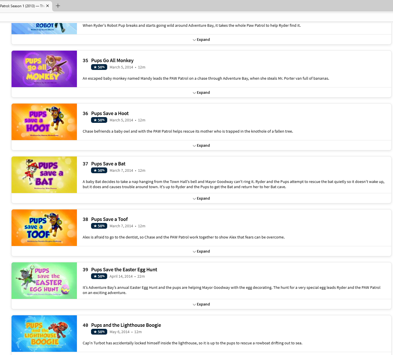

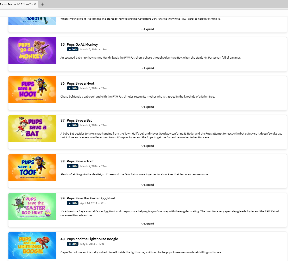

sa2000 703 Posted December 10, 2025 Posted December 10, 2025 On 08/12/2025 at 22:41, Coolbule said: Also I'll list my meta data options for TV Shows if that helps Series Metadata Downloaders TVDB - Movie DB - Open Movie DB Season Metadata Downloaders only TheMovieDb Episode Metadata Downloaders TheMovieDB - The TVDB - Open Movie DB I think it is a bad idea to have all 3 providers listed here for Episode Metadata You have opted for the TheMovieDB only for the season metadata, so I would suggest you just have that for Episode metadata as mixing metadata from different sources could be potential for issues You can see here that the Movie Database has US Airing Dates by default for Paw Patrol But the default for thetvdb which is what is used by Emby is not the US Airing Dates thetvdb has this for US Airing Date which we would not be using - I will add a note in the Naming Standards article about this 1 1

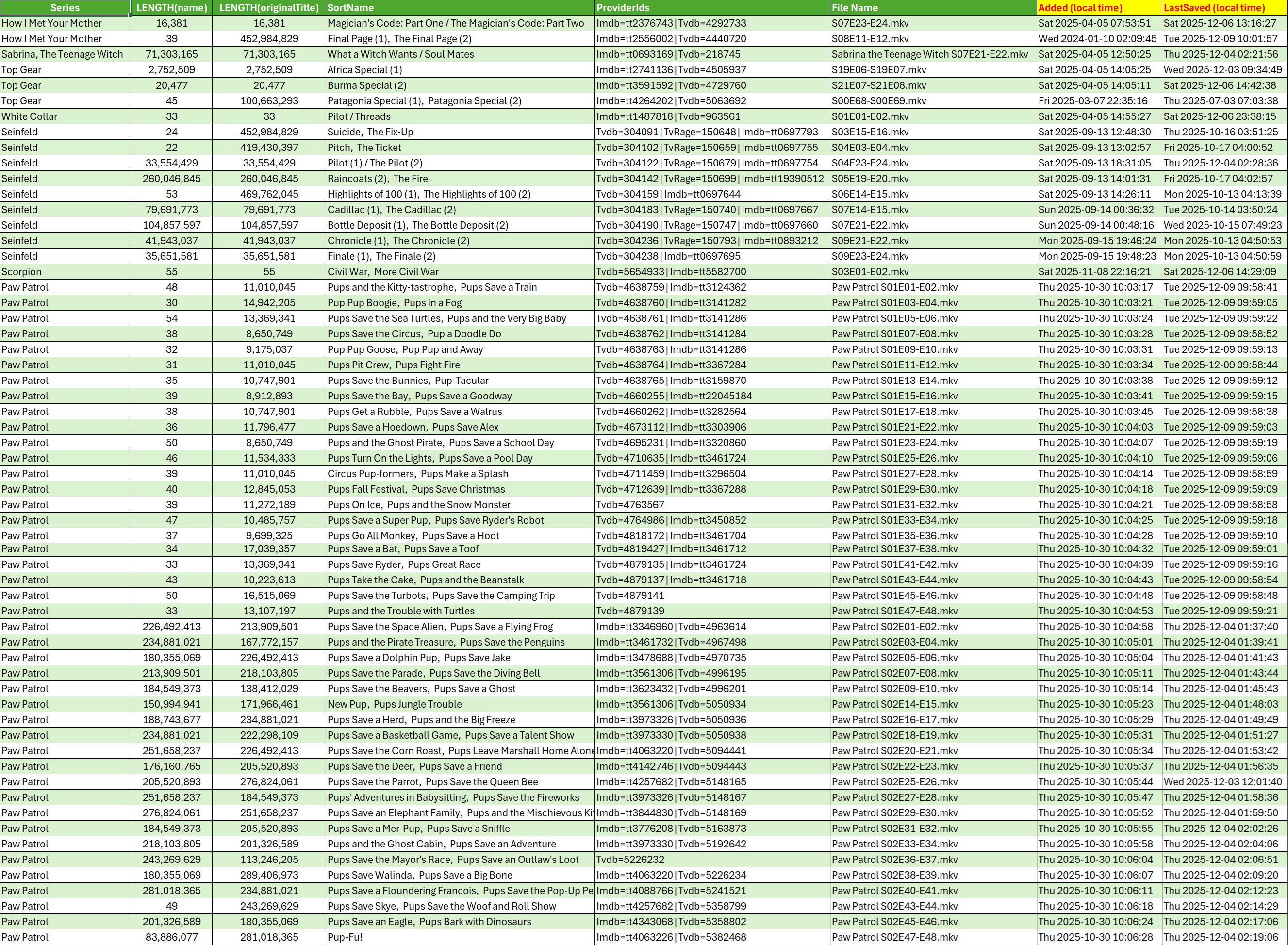

sa2000 703 Posted December 10, 2025 Posted December 10, 2025 (edited) @Lessaj and any others with this issue could use this sqlite query to list media files with this issue select id, LENGTH(name), LENGTH(OriginalTitle), SeriesName, SortName, ProviderIds, Path, DateCreated, DateModified, DateLastRefreshed, DateLastSaved, IsLocked, LockedFields from mediaitems where ((type = 8) and ((name like '% / % / % / %') OR (originaltitle like '% / % / % / %'))) I like Paweł Salawa's SQLite Studio product which has a very easy to use "Export query results" feature in the tools menu for exporting to a csv which can be imported to excel Note: As it is looking for media items with title or originaltitle including 3 slash characters - you may pick some that do have that many slashes and not actually the repeated two episode titles over and over again. So there may be false positives. Update: changed the query to just pick episodes since we know the issue has only been seen for episodes. The query results gives the series name, episode path and length of each of the fields that have been seen to get corrupted. Also some date/time information lis returned, like date added, last refreshed etc .. These are epoch times and can be converted to the UTC date and time using tools such as EpochConverter Edited December 10, 2025 by sa2000
Lessaj 486 Posted December 10, 2025 Posted December 10, 2025 1 minute ago, sa2000 said: @Lessaj and any others with this issue could use this sqlite query to list media files with this issue select id, LENGTH(name), LENGTH(OriginalTitle), SeriesName, type, SortName, ProviderIds, Path, DateCreated, DateModified, DateLastRefreshed, DateLastSaved, IsLocked, LockedFields from mediaitems where ((name like '% / % / % / %') OR (originaltitle like '% / % / % / %')) I like Paweł Salawa's SQLite Studio product which has a very easy to use "Export query results" feature in the tools menu for exporting to a csv which can be imported to excel Thanks for providing this. It returns 30 rows for me and interestingly 18 of the 30 are songs, the rest are from Hey Arnold! and one episode of Ramen Akaneko. Doesn't seem like I have much of an issue overall, but I will look into the results. I just fixed Hey Arnold! the other day when I mentioned it...
sa2000 703 Posted December 10, 2025 Posted December 10, 2025 There may be false positives - if the titles do genuinnely have 3 slashes
Lessaj 486 Posted December 10, 2025 Posted December 10, 2025 Ah, in the case of the music files, yes the titles do have more than one, thank you. For the Hey Arnold! entries I realized that this was a copy of my library before I fixed it, so nevermind all good now. And the Ramen Akaneko episode does have 4 titles with 3 slashes. So in my case, no issues found. 1
