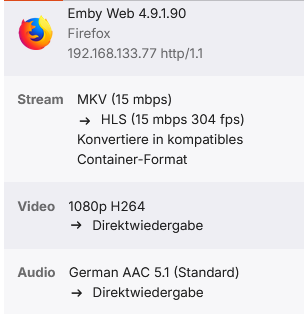

psyc_psyc 1 Posted December 8, 2025 Author Posted December 8, 2025 (edited) Hm eine editir funktion im forum gibts wohl nicht, okay bei diesem gabs edit ^^. Daher ein neuer Post Also den unterschied den ich nun zwischen den zwei geräten gesehen habe ist , bzw zwischen den geräten ist. Das er am Laptop das File in die Konvertierung als stream gibt. Bild eins ist der fehlerhafte, also ihc klicke auf das medium er versucht ihn zu laden, klicke einmal auf das fenster, dann ladet er die hintergrund bilder und medien infos also name und co kg und zeigt in der uebersicht bild 1 an , alles direktwiedergabe. Wenn ich am laptop mit der aelteren firefox version den titel abspiele (funktioniert instant) geht er in die konvertierung. Siehe bild 2 Edited December 8, 2025 by psyc_psyc

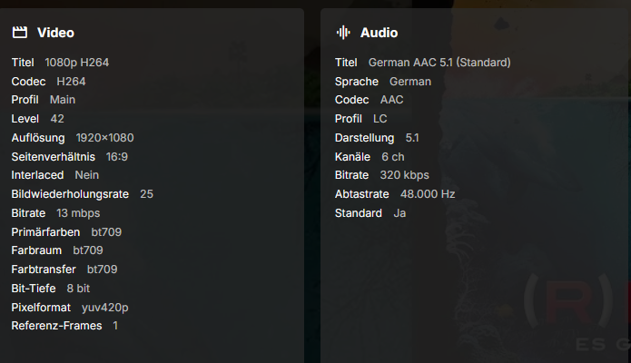

psyc_psyc 1 Posted December 8, 2025 Author Posted December 8, 2025 (edited) Hi Luke, Yes, I can narrow it down to certain files: It seems the issues are specifically occurring with the H.264 (HEVC) video encoder and AAC audio. (Sorry, I previously wrote H.265, but I meant H.264 The quality settings (auto vs. max resolution) don't seem to make a difference; the problem persists on both. How can I best help you to pinpoint the exact files or parameters causing this? Also, what is the best path forward—is there a way to manually force transcoding for these specific cases again, or how should we proceed to fix this? Best regards p5yc Update: I’ve also edited this post to include a screenshot of the specific file properties. It shows the exact encoding details, including the H.264 profile and the AAC track information. Hopefully, this helps to verify if there's a specific mismatch with the new browser engines. Edited December 8, 2025 by psyc_psyc file attachment , edit codet
psyc_psyc 1 Posted December 8, 2025 Author Posted December 8, 2025 Hi Luke, I’ve confirmed the issue: Emby incorrectly assumes Firefox can handle H.264 Level 4.2 MKVs via Direct Play. Forcing a bitrate limit (e.g., 12 Mbps) triggers the GPU transcoder and fixes playback, but this is a poor workaround as it limits my 4K local library as well. Since re-encoding thousands of files to Level 4.1 isn't an option during my medical leave, here is my question: Is there a way to modify the server's DLNA/Client profile for Firefox to flag 'Level 4.2' as unsupported? This would force the server to remux or transcode these specific files to 4.1 automatically for the web client without having to manually cap the entire local bitrate for 4K content. Thanks again for your technical insight! p.S.: Update on Client Testing: Tomorrow, I will test this on the dedicated Emby Theater apps for both Linux (Kitchen TV) and Windows. I expect these will handle the files without issue since they don't rely on the restricted browser engines for Direct Play. This further points to a specific negotiation error between the Emby Server and modern browser MKV decoders regarding Level 4.2.
Luke 42239 Posted December 9, 2025 Posted December 9, 2025 hi, how did you determine that it doesn't support level 4.2?
psyc_psyc 1 Posted December 9, 2025 Author Posted December 9, 2025 Hi Luke, Thank you for confirming the Level 4.2 behavior. I have more critical data, which narrows down the root cause even further. I tested a clean file (H.264 Level 4.1 with AAC) and it also failed when streaming quality was set to 'Auto,' indicating the issue is not purely codec level or AC3, but with the MKV container itself during Direct Play in the new Firefox client. Here is the log evidence: Failure Log (Auto Quality): The console output shows the player immediately failing with the message: Medien können nicht wiedergegeben werden. Keine Decoder für angefragte Formate... This indicates the browser is failing to decode the MKV file directly. Success Log (Limit Set): When I set the quality limit low enough to trigger transcoding, the stream immediately switches to HLS (master.m3u8) and plays without issue. The log confirms the reason: TranscodeReasons=ContainerBitrateExceedsLimit. Conclusion: The problem is that the new Firefox MKV Direct Play support is unreliable (or buggy) when used with the Emby Web Client. The most effective fix would be for the server to recognize this and to automatically force Transcoding/Remuxing to HLS for all MKV container files delivered to the Firefox client, regardless of the H.264 Level, to avoid the failure cascade. What is the recommended server profile configuration to force MKV Remuxing/Transcoding instead of Direct Play for the web client? Thanks again for your perseverance on this. The data confirms my workaround is effective! p.S.: I have attached two separate logs to this post: firefox_console_output_file_without_transcoding_dircektplay.txt (The initial failure without a bitrate limit) firefox_console_output_file_StreamingQuailiHomelan-1080p_10mbps.txt (The successful playback after setting the limit to 10 Mbps) firefox_console_output_file_without_transcoding_dircektplay.txt firefox_console_output_file_StreamingQuailiHomelan-1080p_10mbps.txt
