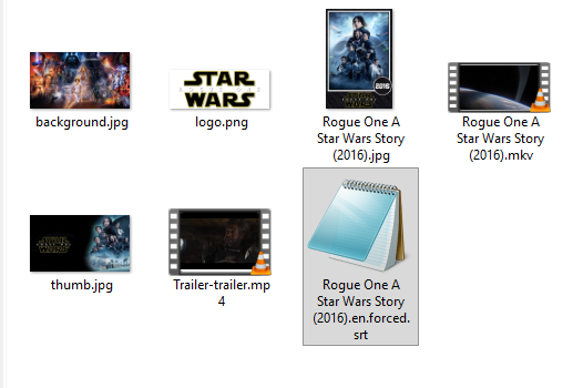

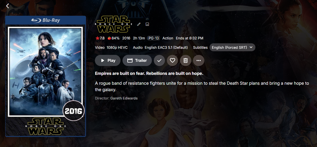

chrisrobbins1970 82 Posted December 3, 2025 Posted December 3, 2025 (edited) Sent a log at 6:15pmEST.. Watching Rogue One; using .srt file. for some reason the subtitles are no longer showing.. in VLC the subtitles are showing up with no issues. Here are the logs...any help would be great... here are some screenshots as well... embyserver.txt ffmpeg-remux-ed19f6d5-9226-4acb-88cc-7475116ce435_1.txt Edited December 3, 2025 by chrisrobbins1970

chrisrobbins1970 82 Posted December 4, 2025 Author Posted December 4, 2025 in the screenshot it shows i have Rogue One A Star Wars Story (2016).en.forced.srt
