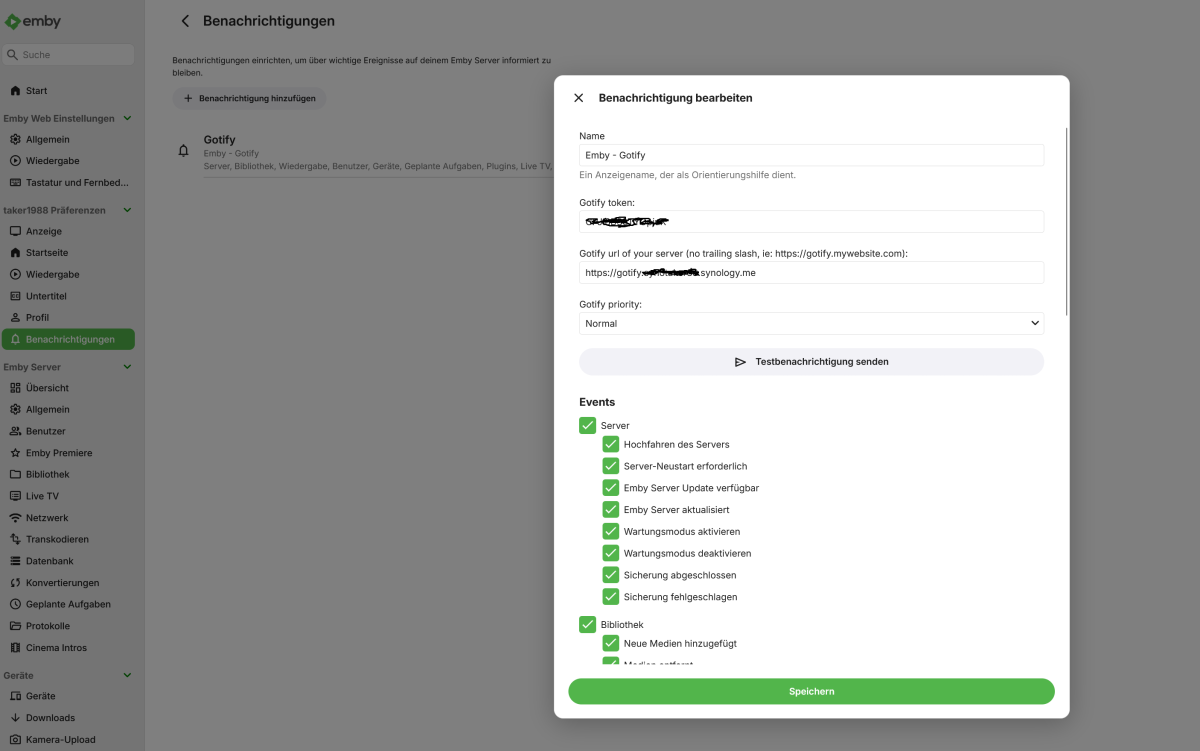

taker1988 21 Posted December 2, 2025 Posted December 2, 2025 Hi, I just downloaded the Gotify plugin. I copied the MediaBrowser.Plugins.GotifyNotifications.dll file to the plugin folder and then restarted the server. I configured the plugin, but it's not working. As soon as I try to send a test message, I get an “Error - Unauthorized” message, but I don't know why. I'm running Emby in Docker. I'm using the latest beta 4.9.2.7 with a Premier license. The whole thing is running on Synology DS720+ with DSM 7.3.1-86003 Update 1. Gotify is also running in Docker with the :latest tag. I created a new client in Gotify and copied the token. In Emby, I entered the token in the plugin settings and entered my reverse proxy address, which points to Gotify, as the address. Gotify works this way with other programs. Could it be that the plugin no longer works with the latest version of Emby? Or have I configured something incorrectly? Best regards

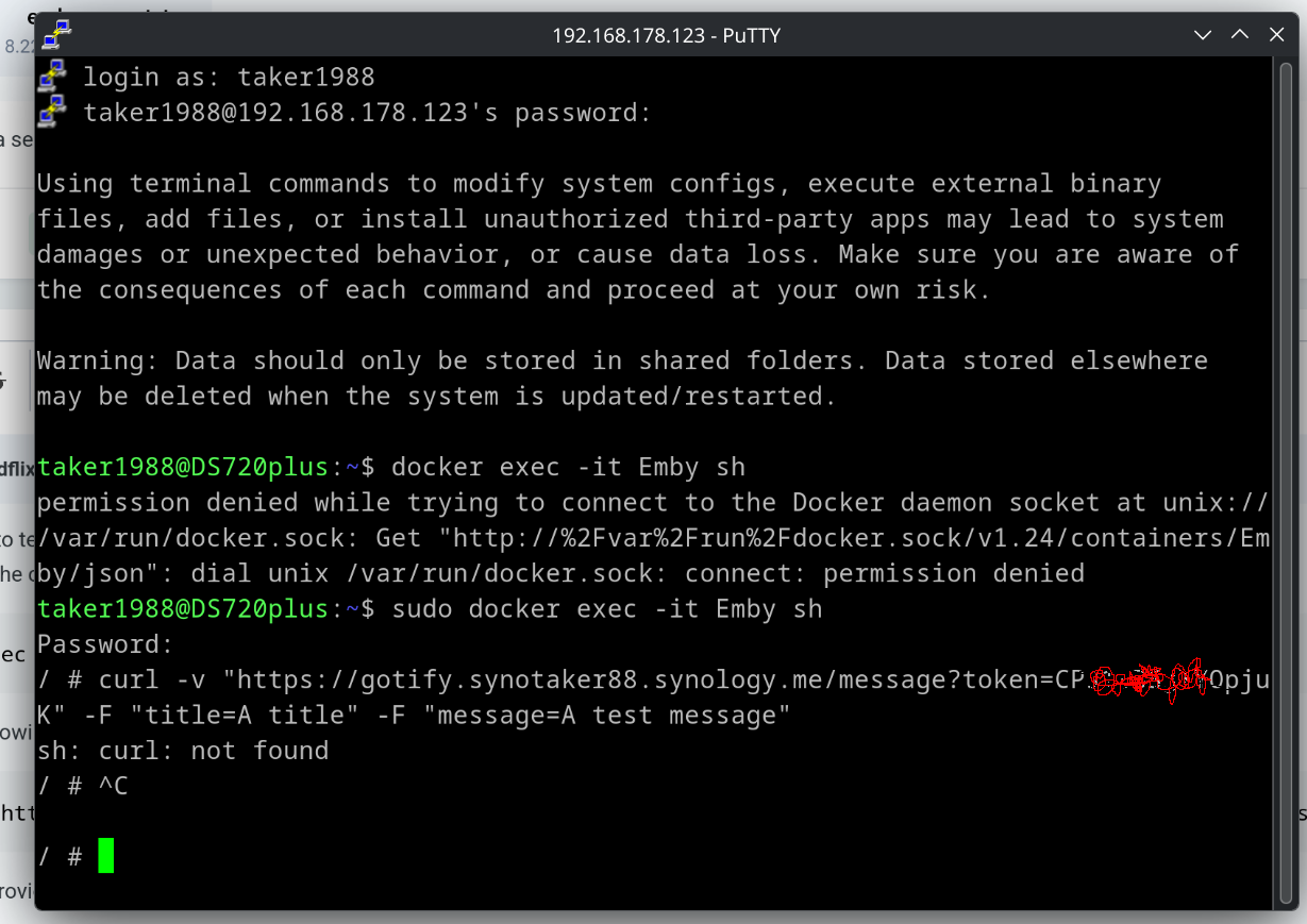

taker1988 21 Posted December 4, 2025 Author Posted December 4, 2025 (edited) 8 hours ago, fredflix said: Not sure what to tell you... I just spun a new fresh install of the beta version 4.9.2.7 (docker) and it works just fine. Can you enter the container: docker exec -it name_of_your_emby_container sh and run the following curl command (replacing "YOUR_TOKEN" with your Gotify token): curl -v "https://gotify.synotaker88.synology.me/message?token=YOUR_TOKEN" -F "title=A title" -F "message=A test message" Can you then provide the ouput? Please remove any IP addresses and Gotify token beforehand! Sure. I don´t know how to copy & paste in the terminal. So I had to type it with my hand. I added a screenshot for you. Seems to be a problem with curl? I also have portainer installed. Should I try that with that bash console thing? @LukeYes, it is on my network. All those things am I running with Docker. //edit: Portainer terminal is showing me also an error. :( Edited December 4, 2025 by taker1988

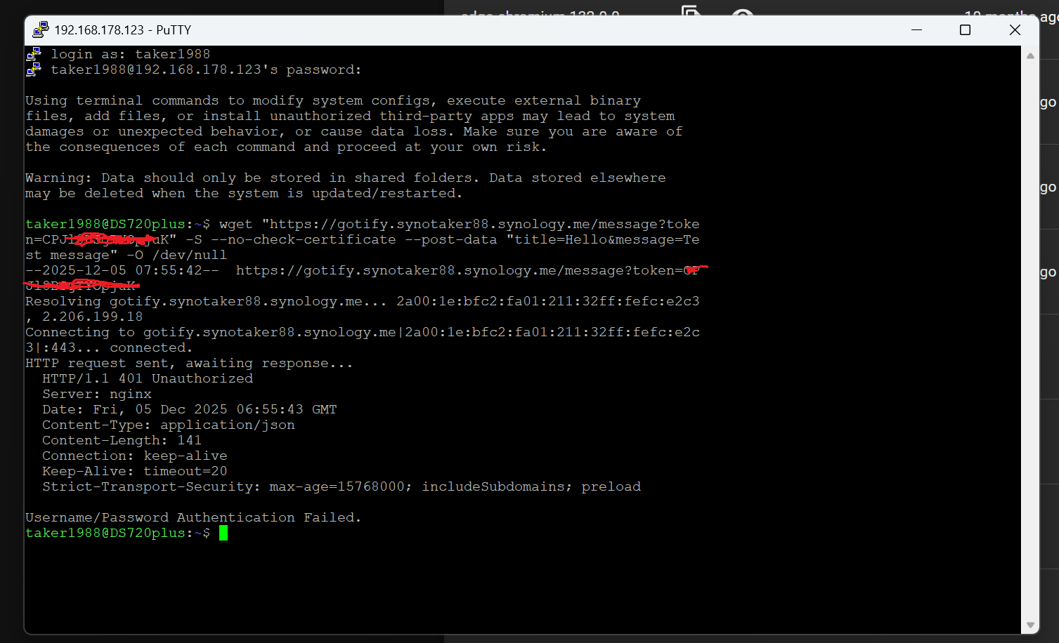

fredflix 31 Posted December 4, 2025 Posted December 4, 2025 (edited) 1 hour ago, taker1988 said: Sure. I don´t know how to copy & paste in the terminal. So I had to type it with my hand. I added a screenshot for you. Seems to be a problem with curl? I also have portainer installed. Should I try that with that bash console thing? @LukeYes, it is on my network. All those things am I running with Docker. //edit: Portainer terminal is showing me also an error. :( My mistake. You're on the right track. It's just that I forgot Emby's docker image doesn't ship with Curl. It does ship with Wget on the other hand. So can you try this wget command? (Same thing, make sure to mask your IP and Gotify token) wget "https://gotify.synotaker88.synology.me/message?token=YOUR_TOKEN" -S --no-check-certificate --post-data "title=Hello&message=Test message" -O /dev/null To paste into a terminal, usually the keyboard shortcut is Ctrl + Shift + V To copy from the terminal it's usually Ctrl + Shift + C Edited December 4, 2025 by fredflix
taker1988 21 Posted December 5, 2025 Author Posted December 5, 2025 Ok, that command worked now. See Screenshot. Authentication failed.
fredflix 31 Posted December 5, 2025 Posted December 5, 2025 (edited) 21 minutes ago, taker1988 said: Yep, this shows this has nothing to do with the plugin nor Emby. Your container OS is getting denied as well. Your problem goes way beyond the scope of support I can provide. All I can say is at a quick glance, here's what I'd do for troubleshooting this: - check your reverse proxy. Do you have HTTP Auth (also called "Basic Authentication") on your Gotify server/endpoint? The fact that you're getting a "Username/Password Authentication Failed." message suggests so. - do you have more than 1 Gotify instance and "maybe" your domain is pointing to the wrong instance where your API key does not exist, hence you're getting denied? - run that exact same wget command on your host server (not the container) where your docker containers reside and see if you're getting denied as well. - triple check the API key you're using matches the one on your Gotify server. All it takes is one wrong character or rogue trailing space for it to fail. Edited December 5, 2025 by fredflix

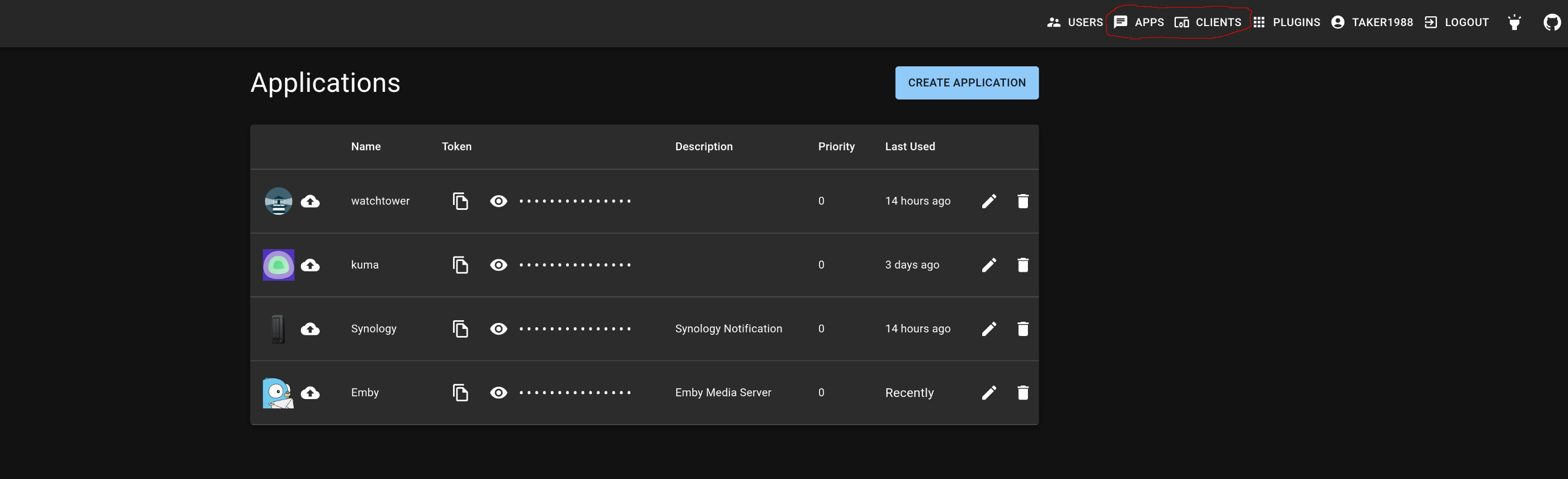

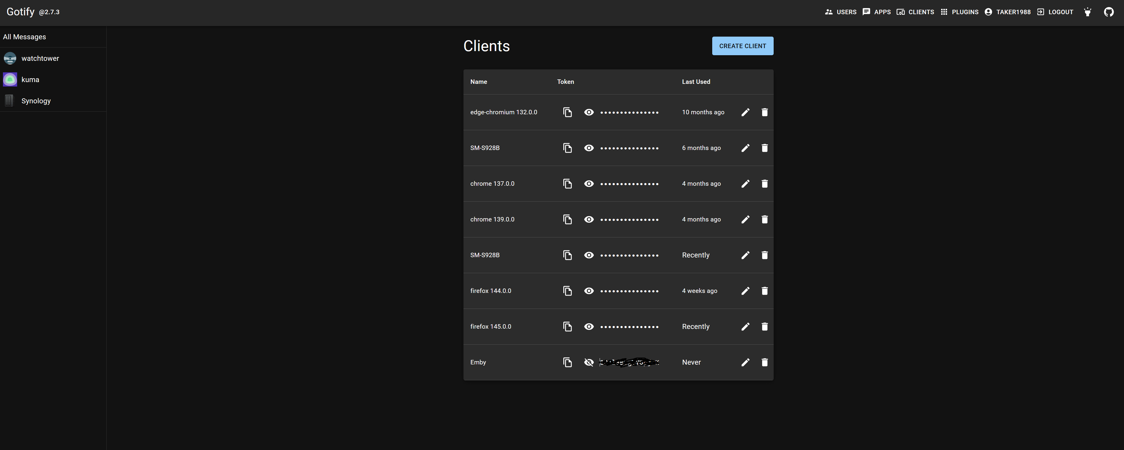

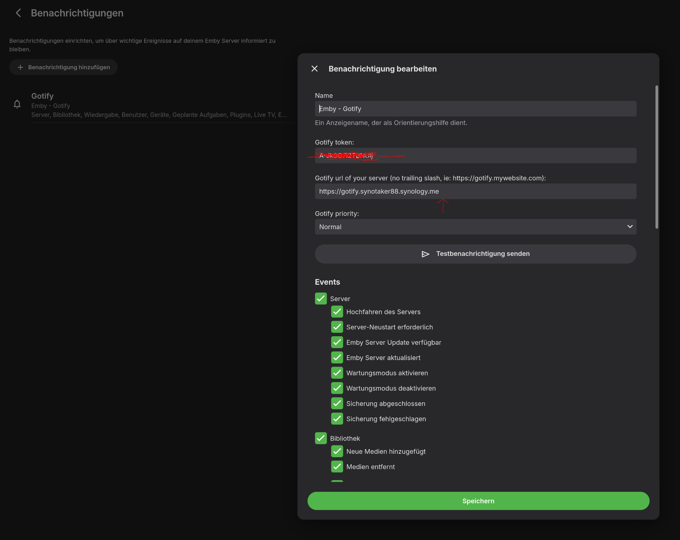

Solution taker1988 21 Posted December 6, 2025 Author Solution Posted December 6, 2025 Okay, it's working now. It was my mistake. In the Gotify web interface, I always clicked on “Clients” in the top right corner and created a client there. But I have to click on “Apps” and create the Emby app there. I then entered this token on the Emby server in the plugin settings and it worked. Additional information: In the plugin settings, where you enter the Gotify URL, it didn't work like this: https://gotify.synotaker88.synology.me/ - I had to enter it like this: https://gotify.synotaker88.synology.me (i.e., without / at the end) Now everything works. Thanks for your help Best regards
fredflix 31 Posted December 6, 2025 Posted December 6, 2025 3 hours ago, taker1988 said: Additional information: In the plugin settings, where you enter the Gotify URL, it didn't work like this: https://gotify.synotaker88.synology.me/ - I had to enter it like this: https://gotify.synotaker88.synology.me (i.e., without / at the end) Glad you got it working Also, just to re-iterate: right above your red arrow, it literally says "no trailing slash" along with a url example 1
taker1988 21 Posted December 6, 2025 Author Posted December 6, 2025 Haha, yes, I just wanted to mention it explicitly once more. Best regards
