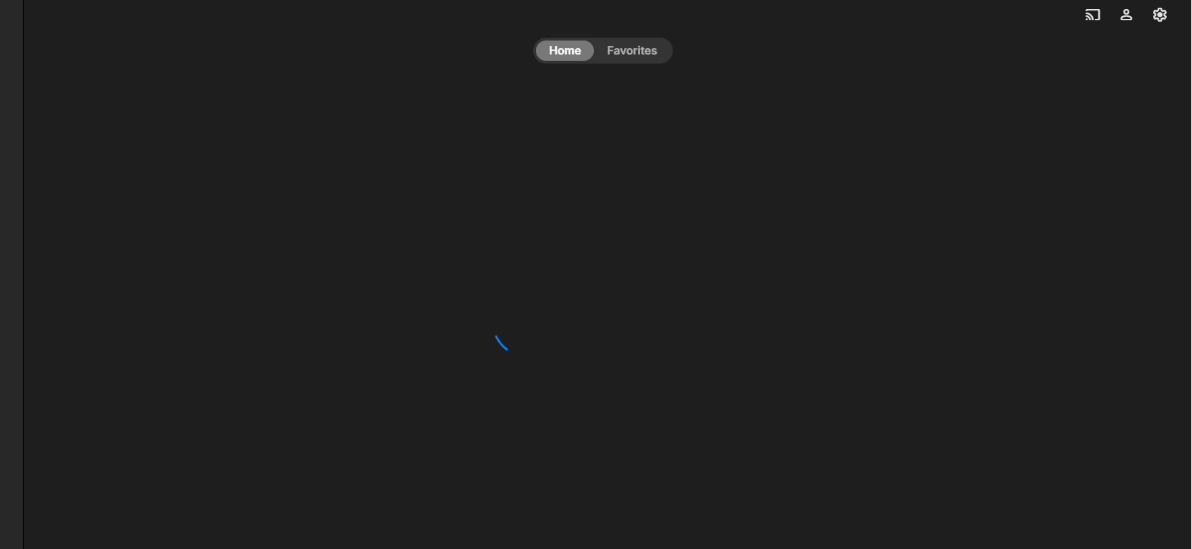

hawkeye09 0 Posted December 1, 2025 Posted December 1, 2025 Hi, I have two emby instances running and i am having problems since updating to version 4.9.1.90. One instance is windows and was updated around 3 weeks ago. Since then i have found randomly it will go to a blank screen spinning state. the only way to fix it was to kill the emby program in task manager and start the instance back up again. I have tried to reboot the server uninstall emby and restore with a backup with the same problem. The other instance which i am running was Ubuntu which i didnt upgrade which was version 4.8 and has no issues. i recently upgraded its to 4.9.1.90 and now i am find the same problems as i am having on windows. embyserver-63900136114.txt

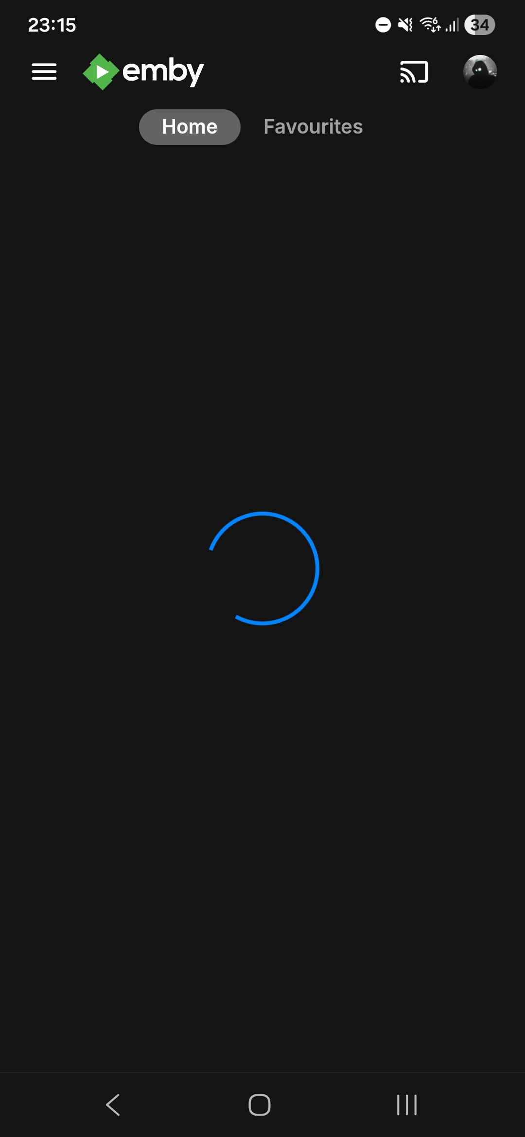

filecore 8 Posted December 29, 2025 Posted December 29, 2025 (edited) Well it seems like I can already update you. Started the fresh server, tried to open a file on Android, nothing. Figured it might be stale data on the client, cleared cache and data from the app, still nothing. Just a spinner and a blank UI. Same thing whether I added my subdomain via the internet, or just via local IP:port. Edited December 29, 2025 by filecore

filecore 8 Posted December 29, 2025 Posted December 29, 2025 2 minutes ago, Luke said: Is that from when the loading spinner was stuck on the home page? Yes - I enabled logging, force stopped the app, reproduced the behaviour, then uploaded the log.
Luke 42288 Posted December 29, 2025 Posted December 29, 2025 2 minutes ago, filecore said: Yes - I enabled logging, force stopped the app, reproduced the behaviour, then uploaded the log. Can you side load the latest build? https://emby.media/emby-for-android.html does it happen with that?

filecore 8 Posted December 30, 2025 Posted December 30, 2025 Hi, sorry for the delay - my last message was at 1am local time and I decided it was time to go to bed! Sideloaded the Android build now, cleared cache and data, enabled logging, and force killed the app then relaunched. First I clicked on an episode of Parks and Rec and it played fine. Then I clicked on The Babadook and got a blank screen for about 20s before it rendered the listing. Clicking play on it gave another spinner. Tried to load a music playlist instead. Another blank screen. Babadook was still stuck as the entry in the notification area widget. Stopped testing at that point, and here are the logs. emby_android_1767086001870.txt emby_android_1767085994927.txt
filecore 8 Posted December 30, 2025 Posted December 30, 2025 As a test I pulled the latest beta server image and ran it, repeating the same sequence of actions as above. This time, Parks and Babadook loaded quickly and started playing just fine, but the playlist would only partially load (see screenshot). Random clicking around also found other shows not loading anything, just a black screen again.
