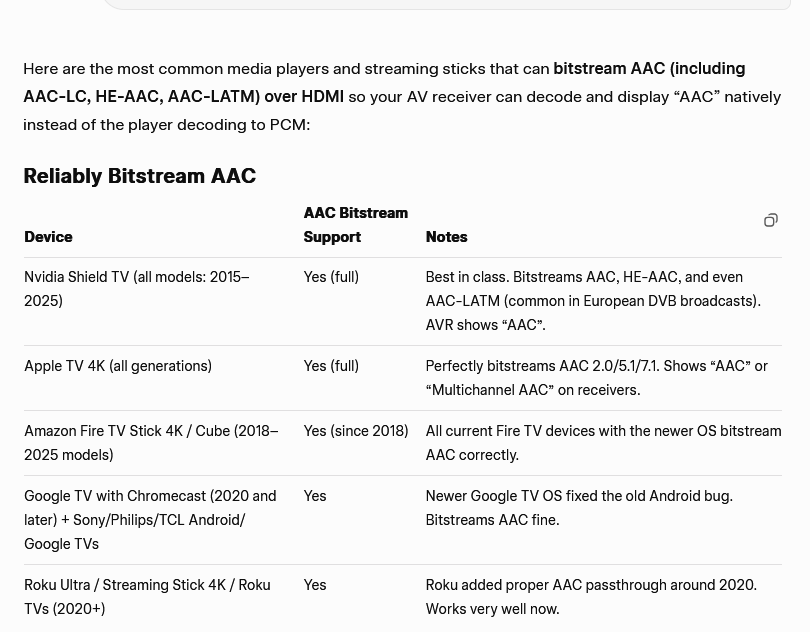

NakedPirate 16 Posted December 1, 2025 Posted December 1, 2025 (edited) 6 hours ago, yocker said: Unless you are talking about the Firestick specifically which maybe doesn't support passthrough for it, then AAC can be sent over HDMI. Most, if not all, modern denon receivers should support AAC. That's hypothetical. But yes. All AVRs after about 2010, the late Denon 19xx series and the 2000/3000/4000 AVC and AVR series can natively decode AAC without any problem. But since AAC is not part of the bitstreamable codec list over HDMI and not standardized, it is not implemented. But it works with PCs or Raspberries. All other mainstream devices won't bitstream AAC and fall back to PCM (or worse), as far as I know. I asked Grok, so maybe there are more devices than I thought: Can anyone confirm some devices? That's the negative list: That's what AI says, but I'm not entirely sure, so without liability! Edited December 1, 2025 by NakedPirate I am Batman! 1
yocker 1431 Posted December 1, 2025 Posted December 1, 2025 2 hours ago, NakedPirate said: That's hypothetical. But yes. All AVRs after about 2010, the late Denon 19xx series and the 2000/3000/4000 AVC and AVR series can natively decode AAC without any problem. But since AAC is not part of the bitstreamable codec list over HDMI and not standardized, it is not implemented. But it works with PCs or Raspberries. All other mainstream devices won't bitstream AAC and fall back to PCM (or worse), as far as I know. I asked Grok, so maybe there are more devices than I thought: Can anyone confirm some devices? That's the negative list: That's what AI says, but I'm not entirely sure, so without liability! You are right, most devices can not do it and decodes the signal before sending it on. I just know it's possible.
