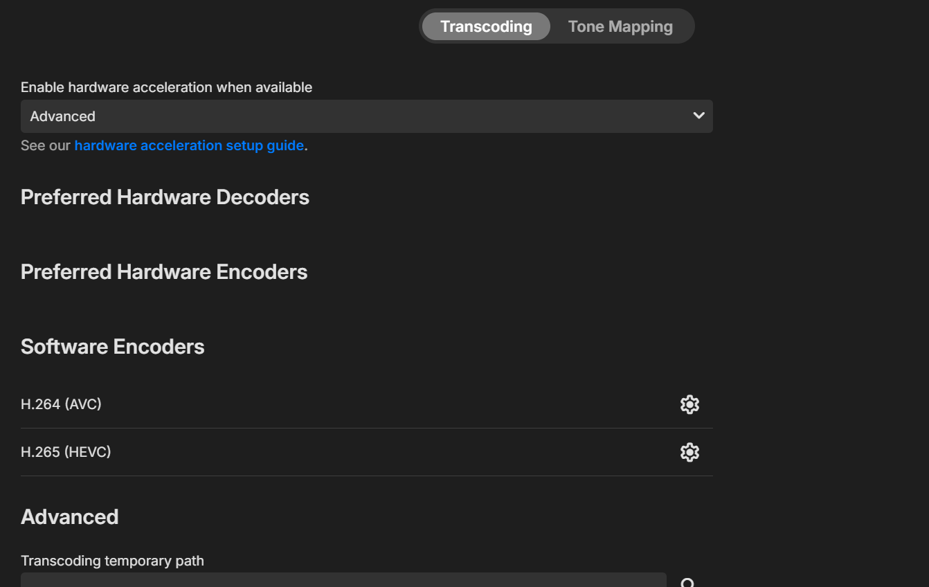

mr_man_029 3 Posted November 29, 2025 Posted November 29, 2025 Hey all, I'm running a docker container of Emby on a local machine running Debian (Intel N150). I'm using the latest emby/embyserver image. For some reason I can't get any devices to show under preferred hardware decoders/ encoders (specifically trying to set up Intel QSV). In my docker compose file I included the /dev/dri path under the devices parameter, and I also added the render and video groups to the GIDLIST entry (in my case it was 44 and 992 for /dev/dri/card0 and /dev/dri/renderD128). If I look at the hardware detection logs, I see a message "Failed to initialize VA /dev/dri/renderD128. Error -1" (log attached). I was able to get hardware transcoding to work with a Docker Jellyfin installation, so I'm thinking this has something to do with Emby's configuration that I'm missing. Any advice? hardware_detection-63899973592.txt

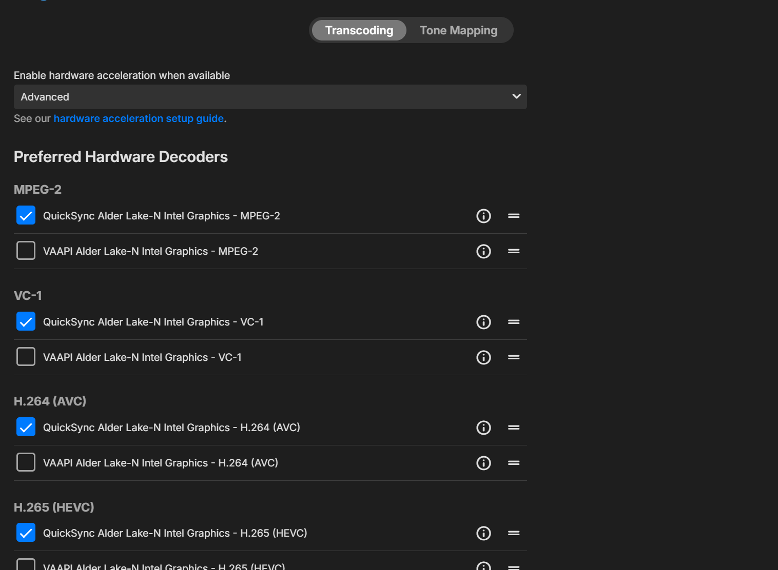

Solution mr_man_029 3 Posted November 29, 2025 Author Solution Posted November 29, 2025 I was looking around the forums and it appears the latest Emby beta has updated Intel drivers (Emby version 4.9.2.6 beta at the time of writing). I changed the image to the beta version within my docker compose (image: emby/embyserver:beta) and that did the trick. I can confirm hardware transcoding is now working Thanks all for the troubleshooting help! 2 1
