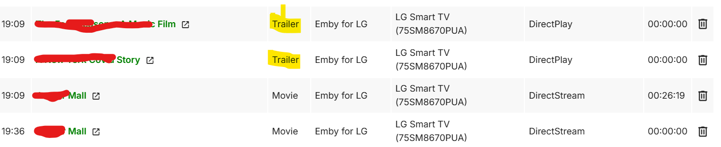

UltimateOne 1 Posted November 29, 2025 Author Posted November 29, 2025 I will add though that, yes, it looks like Emby was trying to play the trailer when I was really trying to play a completely different movie...

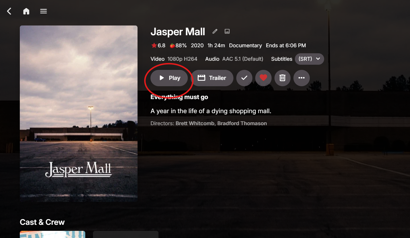

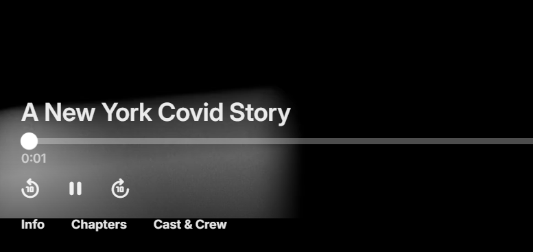

UltimateOne 1 Posted December 2, 2025 Author Posted December 2, 2025 I tried to get Emby to do it again. No luck yet. In this this movie marked as a "Favorite". I selected "Favorites" from the main menu. From there, I opened clicked the poster to open the movie options (shown below). I just played it from here. The screen goes to black before the name of the another movie (It tried playing "A New York Covid Story") appears above the controls (replicated for the explanation below). The log says it was playing the trailer, but I was unable to confirm. It didn't show the "hourglass" like Emby was fetching the stream from YouTube, so I wonder if it really was the trailer. Should I delete the Top Picks plugin? I don't use it much anyway.

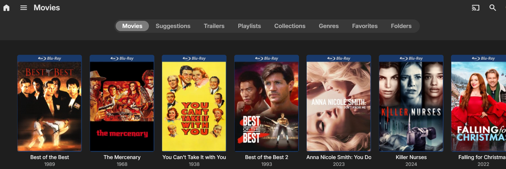

UltimateOne 1 Posted December 3, 2025 Author Posted December 3, 2025 Weird...I uninstalled 'Top Picks' and restarted the Emby server (not a cold boot on Windows, just Emby). All the movies now have the BluRay frame. No biggie, just weird.
Luke 42288 Posted December 3, 2025 Posted December 3, 2025 That is possibly the top picks content left behind in the database. Hopefully the next run of the refresh channels scheduled task will clean things up. I am going to pull this plugin from the catalog as it just creates more trouble than it's' worth.
UltimateOne 1 Posted December 3, 2025 Author Posted December 3, 2025 Good call. It would be an unforgettable holiday if someone goes to play "A Christmas Story" and "The Bonnie Blue Story" comes on.

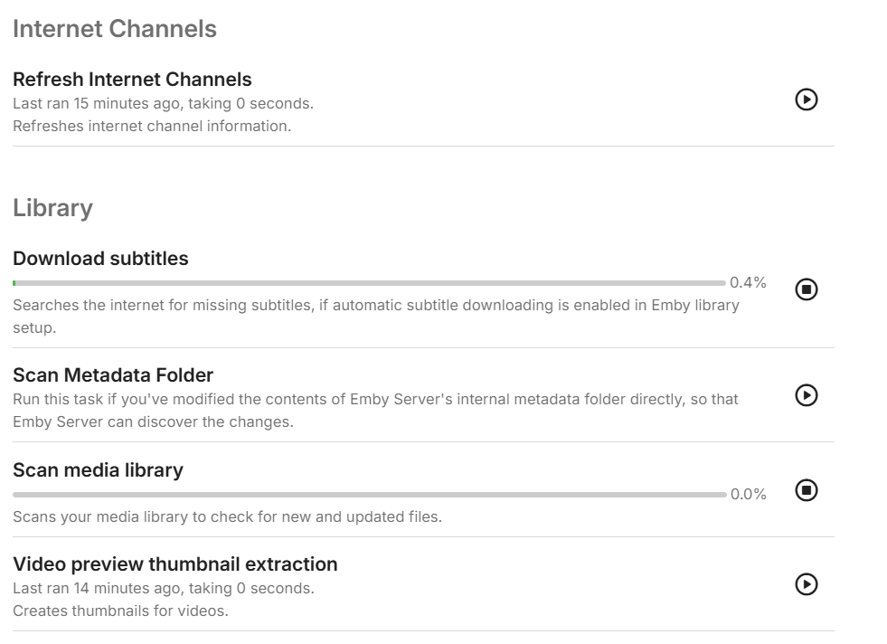

UltimateOne 1 Posted December 3, 2025 Author Posted December 3, 2025 If there is a way to get rid of the frames, it would be nice. I started the "refresh channels" to no avail. I'm Scanning Library Files now, but I don't think that will work.
Luke 42288 Posted December 3, 2025 Posted December 3, 2025 I think that's normal for the cover art plugin. How have you configured cover art?

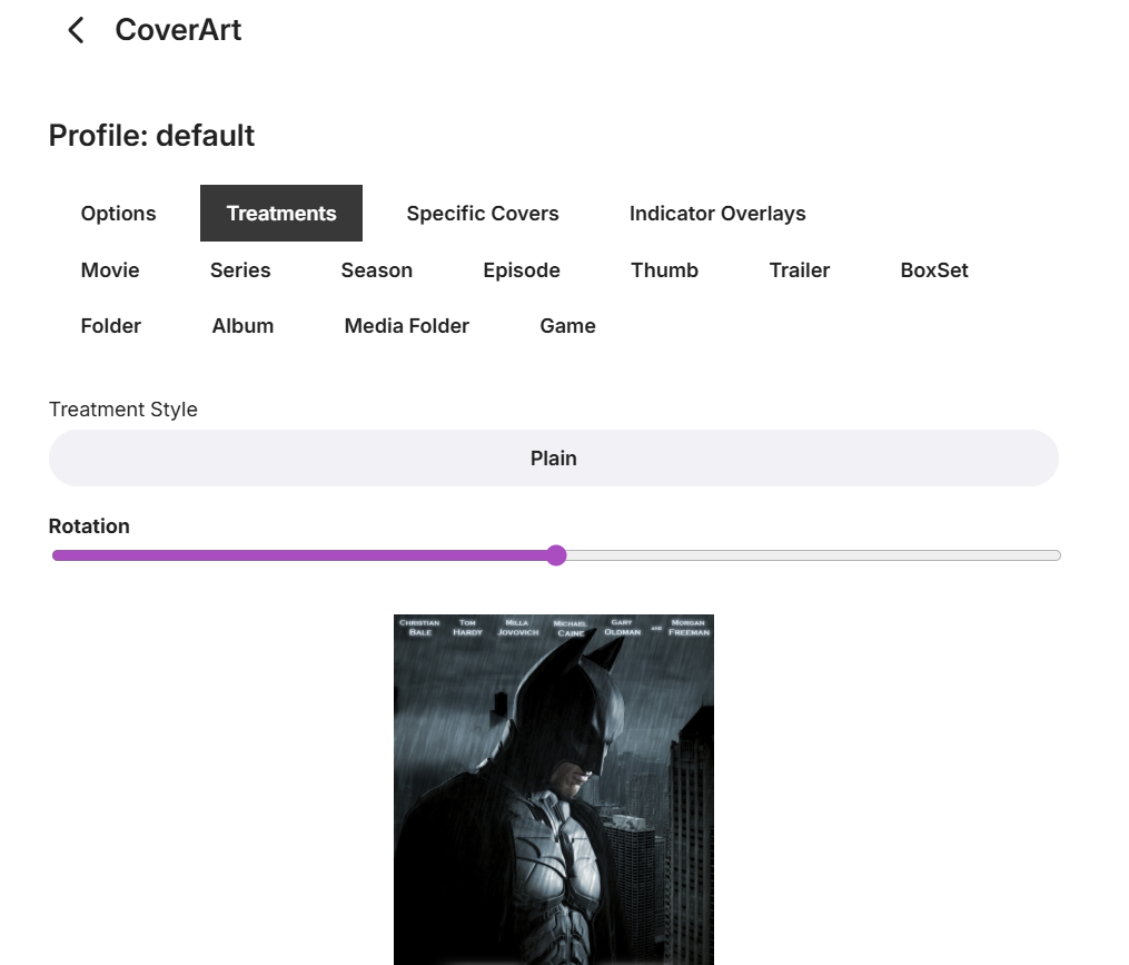

UltimateOne 1 Posted December 3, 2025 Author Posted December 3, 2025 I don't think I ever have configured the cover art. I just let Emby run the "Movie Image Fetchers". I first installed Emby on a test-bed laptop about 1.5 years ago and installed a handful of plugins; I imagine it's like you said...the 'Top Picks' plugin did an override on the cover art. I just recently migrated to a new server so it can handle my library and transcode properly. Anyway, I didn't notice there were settings for the cover art plugin. I'll get in there and take a look. It definiitely looks better without the blue border (IMO).
UltimateOne 1 Posted December 3, 2025 Author Posted December 3, 2025 Yes! That's it! Treatment > Treatment Style. Thanks again for all your help with this one. I'll keep you apprised.
ebr 16354 Posted December 3, 2025 Posted December 3, 2025 1 hour ago, UltimateOne said: Yes! That's it! Treatment > Treatment Style. Hi. If you don't want any treatments on your covers, I would just uninstall CoverArt.
UltimateOne 1 Posted December 3, 2025 Author Posted December 3, 2025 Cool. Yes, I should uninstall all the unused plugins anyway. I'll go through them and start removing. Thanks!
