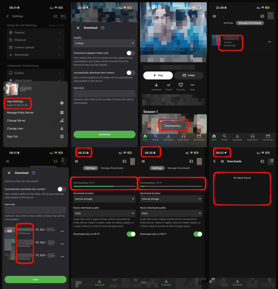

curb_enhusiasm 2 Posted November 28, 2025 Posted November 28, 2025 I'm desperately trying to download about 3 episodes of a series for offline usage on my iPhone. Going to App Settings -> Downloads I can see showing Downloading ..., but then, after it finishes, it just starts again and again and no files are to be found in the Downloads section. I run version 4.9.1.90 of the server. If I go to Manage Downloads, all 3 episodes are listed as "Transferring". Thoughts?

curb_enhusiasm 2 Posted November 30, 2025 Author Posted November 30, 2025 I've tried reinstalling the app, no success. Here is the process with pictures. Not sure how better I can explain it. 1

curb_enhusiasm 2 Posted December 2, 2025 Author Posted December 2, 2025 Is my sequence clear enough, @Luke?
pigpog8 8 Posted December 3, 2025 Posted December 3, 2025 (edited) On 11/30/2025 at 1:06 AM, curb_enhusiasm said: I've tried reinstalling the app, no success. Here is the process with pictures. Not sure how better I can explain it. This is exactly my issue as well. I queued up several shows last night to download, and noticed the "Downloading x of x" kept restarting, with different numbers (sometimes it would be 1..2..3...etc of 25, then it would restart and go through 1...2...3... etc of 24, and so on). I thought it was a weird way to display it, but noticed the maximum was decreasing, and thought that once the maximum hits 0, it should work. Well, it eventually disappeared, and I check my downloads area, and there are no shows. Not sure what happened. I also deleted all of the downloads, deleted the app and reinstalled, restarted the server and my phone, to no avail. Now, I'm running a test to see if removing admin privileges from my user profile (as suggested here as a fix https://emby.media/community/index.php?/topic/103327-ready-to-transfer-but-never-starts-downloading/page/4/#findComment-1418403) will fix it. edit - also, sequence looks great, @curb_enhusiasm Edited December 3, 2025 by pigpog8 1
