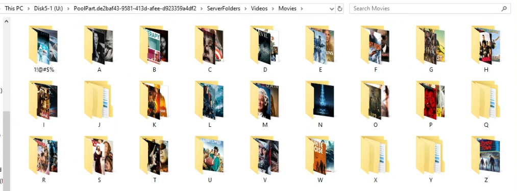

Happy2Play 9814 Posted November 30, 2025 Posted November 30, 2025 3 hours ago, qazwsx10 said: Thanks for the explanation! So in this hypothetical (internal drives of D, E, and F, but pooled to Z), if I have a movie in 'D', it is possible that Emby will save the NFO in a different drive? And in your opinion would you recommend migrating first or pooling the drives first? The odds are your metadata/images will be scattered across as many drives as you have in your pool as Emby has no way to control where your Pooling software places content. So every drive will have your Pool folder hierarchy. Pool Random drive So depending on how you have Pooling software configured ie to fill one drive at a time or balance across all your drive is really up to you as your content in the end could be scattered across all drives in the pool.
qazwsx10 7 Posted November 30, 2025 Posted November 30, 2025 2 minutes ago, Happy2Play said: The odds are your metadata/images will be scattered across as many drives as you have in your pool as Emby has no way to control where your Pooling software places content. So every drive will have your Pool folder hierarchy. So depending on how you have Pooling software configured ie to fill one drive at a time or balance across all your drive is really up to you as your content in the end could be scattered across all drives in the pool. This is great to know! So from your experience do you have any recommendations on best practices on organization in a pool setting? It's looking like you opted for separate alphabetical folders.

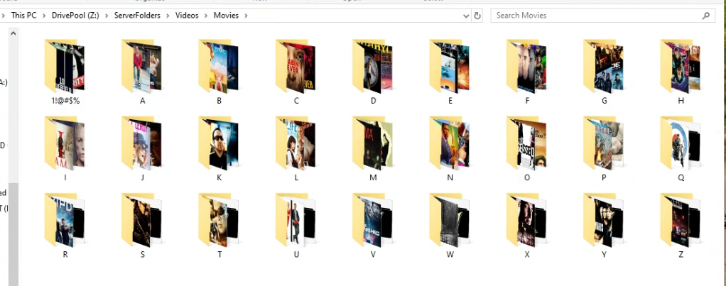

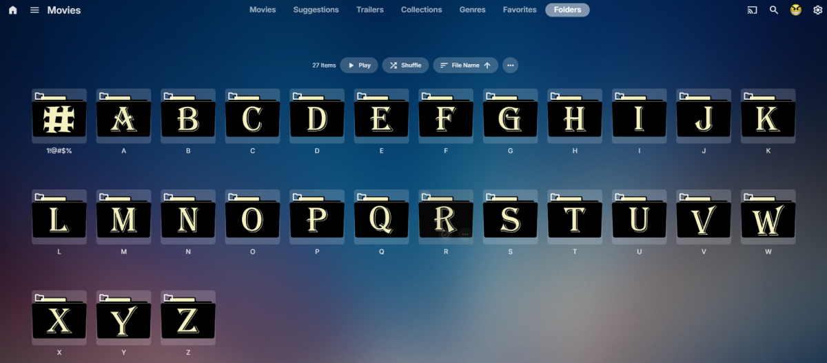

Happy2Play 9814 Posted November 30, 2025 Posted November 30, 2025 3 minutes ago, qazwsx10 said: This is great to know! So from your experience do you have any recommendations on best practices on organization in a pool setting? It's looking like you opted for separate alphabetical folders. In the end it is user preference, but I didn't like having so many items in one parent folder. But you will want to have that hierarchy before creating Emby library. In my case And only see the hierarchy in folder view as other views already flatten/collapse the view.
