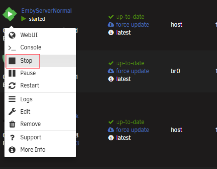

Neminem 1623 Posted November 27, 2025 Posted November 27, 2025 (edited) 1 hour ago, Przemek said: Hi, I cannot, stop or remove EmbyServer. When I uncheck autostart and then stop/start docker it also starts. Try this from your docker tap, don't restart the whole server. Run Docker containers | Unraid Docs Edited November 27, 2025 by Neminem 1

Neminem 1623 Posted November 28, 2025 Posted November 28, 2025 If you can't stop a docker then there is something wrong with your unRaid server. Or you have a custom script that auto starts it.
