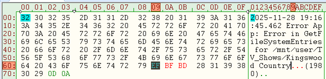

sa2000 697 Posted November 28, 2025 Posted November 28, 2025 (edited) for your TV Shows library that you have just created, are you creating folders with names pasted from text you copy from browser screen? There are some invalid characters in the folder name you created for "Kingswood Country (1980)" - there is a 0xEF 0xBF 0xBD between the "Country" and "(1980)" 2025-11-28 19:16:45.462 Error App: Error in GetFileSystemEntries for /mnt/user/TV_Shows/Kingswood Country�(1980) System.IO.DirectoryNotFoundException: System.IO.DirectoryNotFoundException: Could not find a part of the path '/mnt/user/TV_Shows/Kingswood Country�(1980)'. 2025-11-28 19:16:45.973 Error App: Error in validateChildren for 4 /mnt/user/TV_Shows System.IO.DirectoryNotFoundException: System.IO.DirectoryNotFoundException: Could not find a part of the path '/mnt/user/TV_Shows/Kingswood Country�(1980)'. Edited November 28, 2025 by sa2000

sa2000 697 Posted November 28, 2025 Posted November 28, 2025 select the text for the name of the "Kingswood Country (1980)" folder under "/mnt/user/TV_Shows" and copy to a text file, save and then view the text file using a hex file viewer - the non standard characters between "y" and "(" may not visible when you look at the folder name

Macca500 6 Posted November 28, 2025 Author Posted November 28, 2025 10 hours ago, sa2000 said: select the text for the name of the "Kingswood Country (1980)" folder under "/mnt/user/TV_Shows" and copy to a text file, save and then view the text file using a hex file viewer - the non standard characters between "y" and "(" may not visible when you look at the folder name Ok. I did this and it only showed a space between them. Do I delete the space? How do I then fix it?
