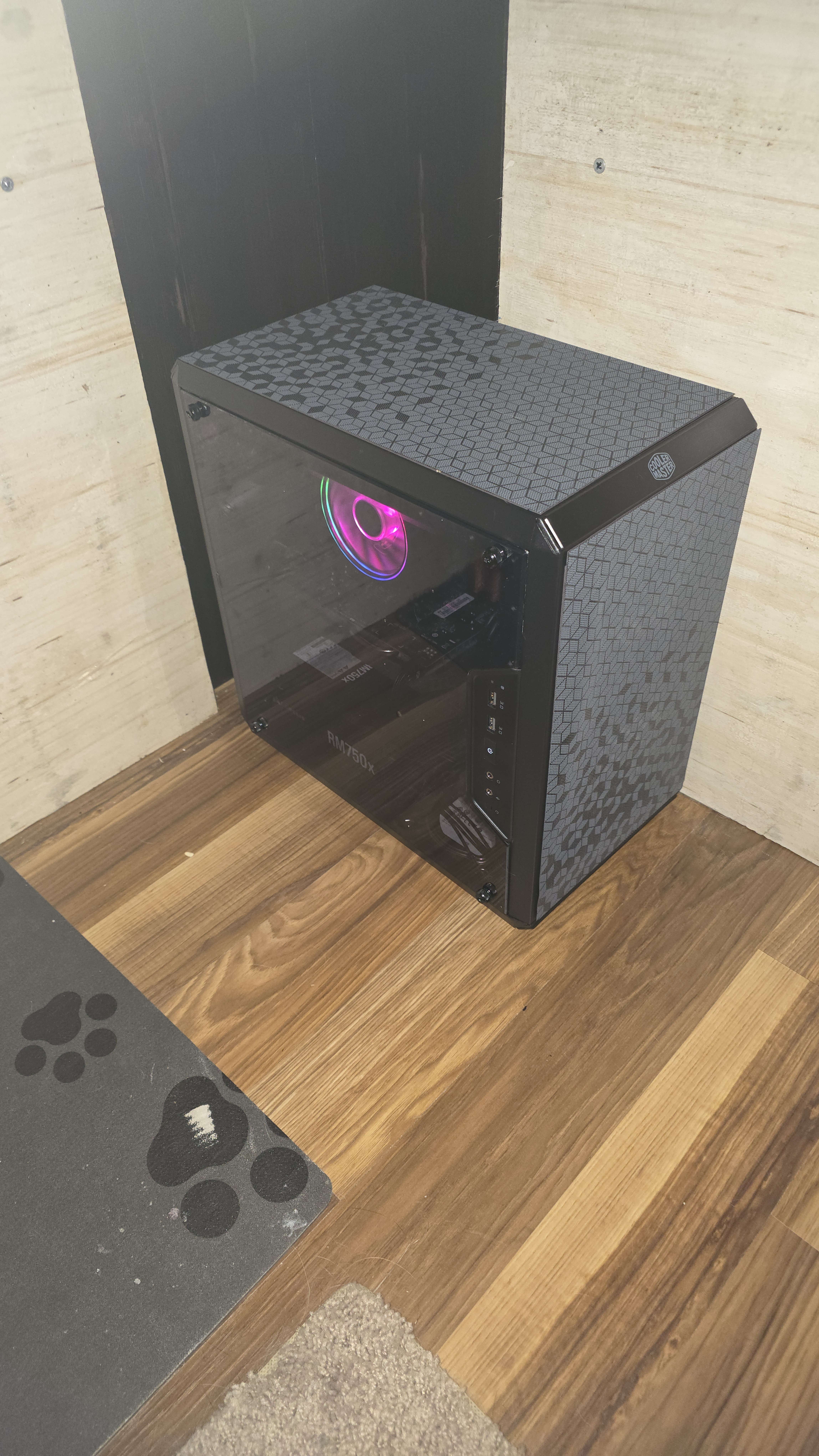

XAFAfterShock 0 Posted November 26, 2025 Posted November 26, 2025 Alright, I had a whole entire page typed up of my previous scenario but the forum keeps spitting out the 500 error page so The TLDR is don't waste your time or money on an off the shelf nas for media. I build a dirt cheap pc with a b550 moboe, ryzen 8 core cpu, 16GB of ddr4, ryzen 3700x cpu and a cheap 1060 GPU. I have a 4 bay synology nas that I WAS running emby on and for playing it was fine for 6 movies streams UNLESS any movie had to be transcoded then it was game over for the rest of the streams including even accessing the web interface. So I guess it depends on your use case, do any of your movies require transcoding for playback? If not then I could say a nas would probably be ok but if your have to transcode movies then I would consider building a cheap pc. you could build far cheaper than mine and outperform any off the shelf nas and the other good part is emby performs very well on windows, linux and truenas. I do still use my nas for backups and file sharing though so it's not totally useless.
