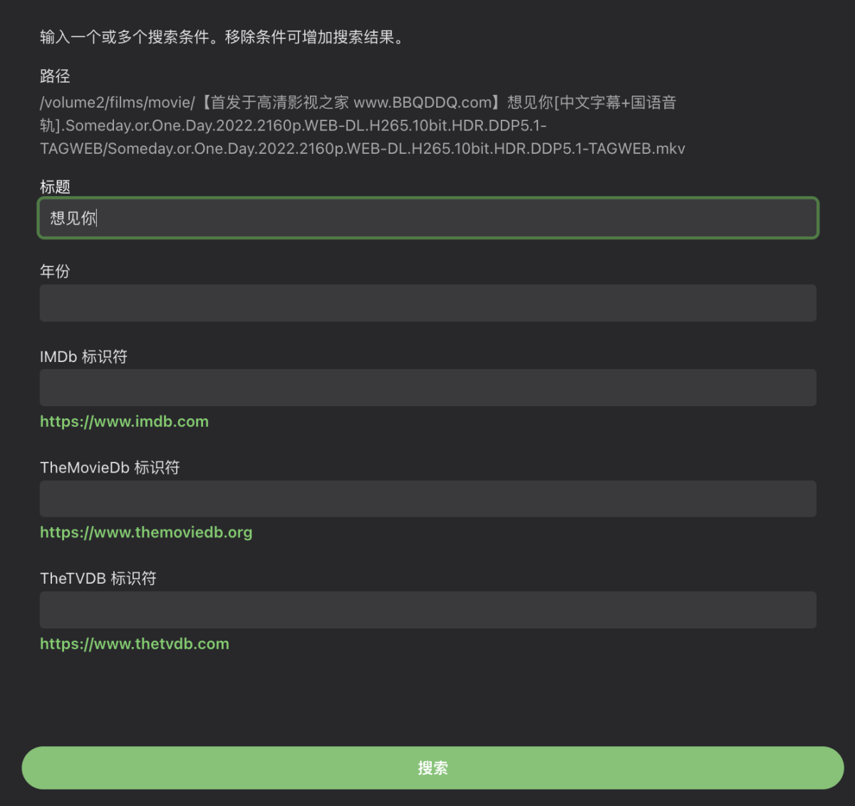

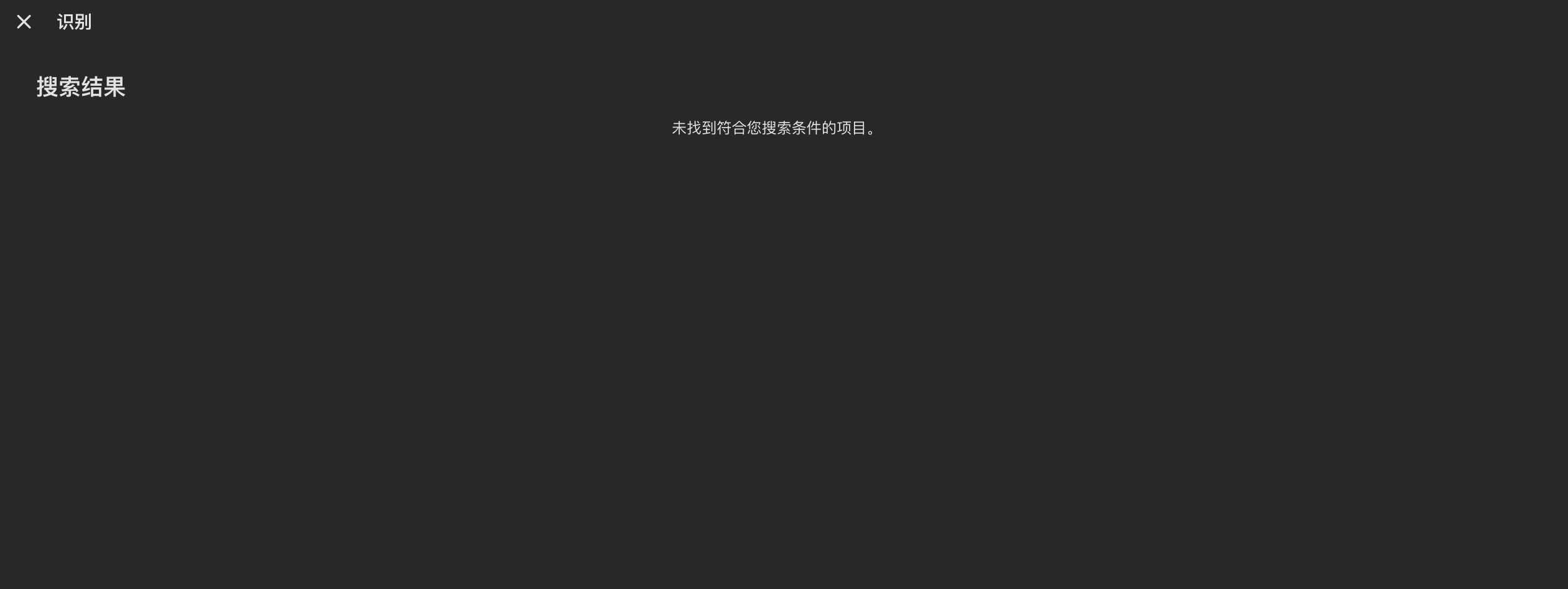

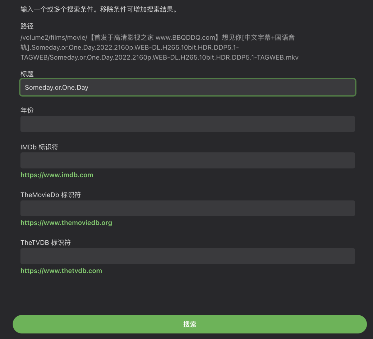

RadarZ 1 Posted November 23, 2025 Posted November 23, 2025 识别电影的时候只有用英文名字才能识别,用中文名字确什么都搜不到,应该怎么设置? 4.9.1.90 和 4.9.2.6 都试过了,情况都一样 embyserver.txt

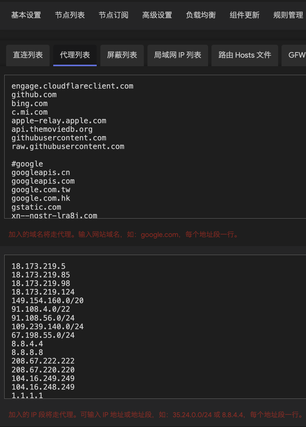

RadarZ 1 Posted November 24, 2025 Author Posted November 24, 2025 5 minutes ago, Luke said: Hi, is moviedb blocked in your location? i'm not quite sure,but it's still working last week,and I just set that themoviedb.org to proxy , and i can get to youtube and github very well but moviedb and douban still not working, only omdb is work

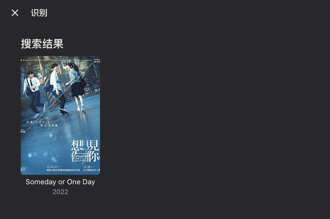

RadarZ 1 Posted November 25, 2025 Author Posted November 25, 2025 17 hours ago, Luke said: Please keep us posted. Thanks. it suddenly works well tonight...dunno y and dunno how... embyserver.txt 1
