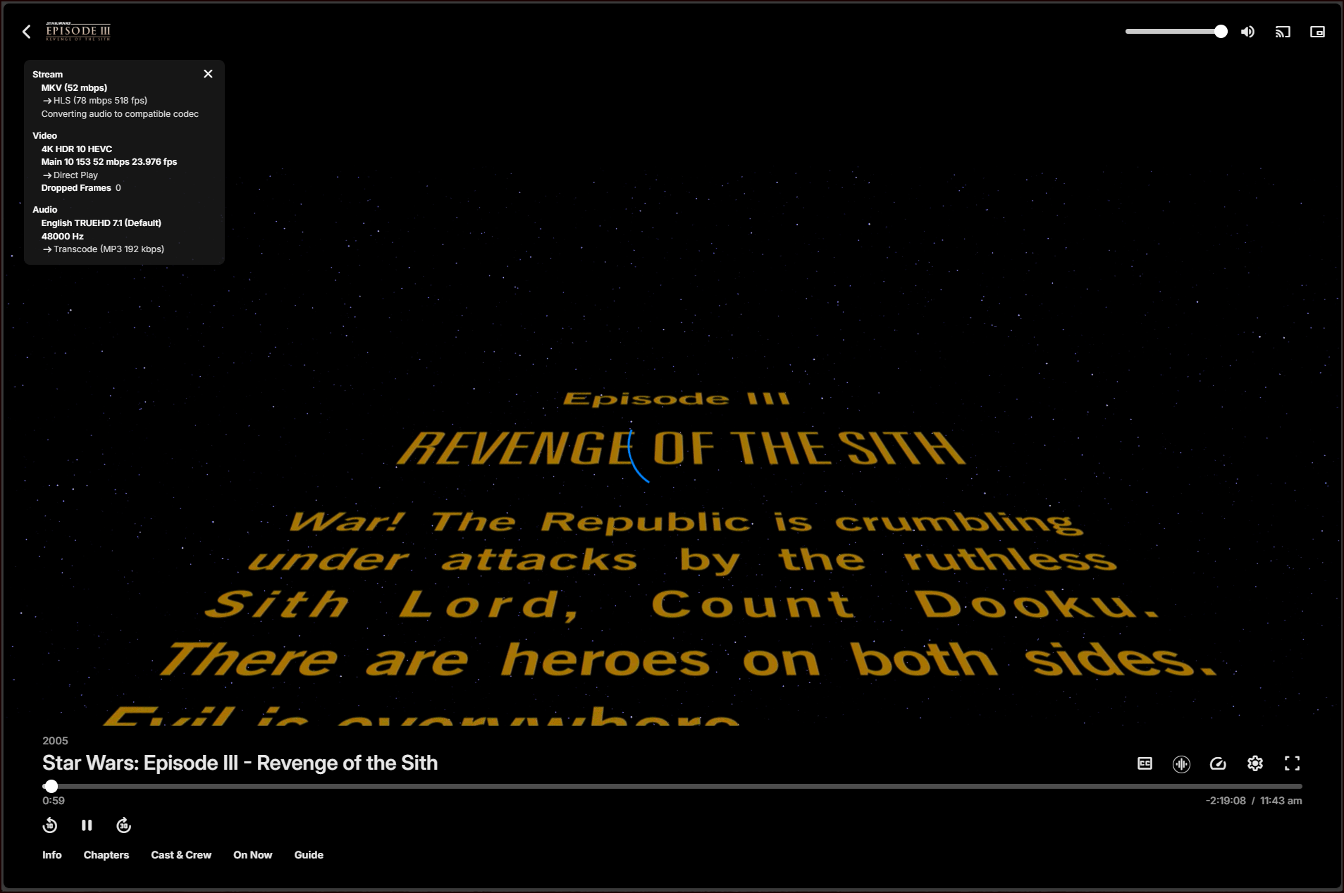

Vidmo232 2 Posted November 23, 2025 Posted November 23, 2025 Emby Server Version 4.9.1.90 Emby Server platform: Windows Server 2025 Client: Edge Version 142.0.3595.94 (Official build) (64-bit) Issue: when playing HEVC content with Edge the playback stalls at the same exact location in each film when DirectPlay is being used. The content is using DirectPlay but transcoding the audio as you can see in the screenshot. This is occurring with any HEVC content where DirectPlay in Edge is being used, if the HEVC content does not use DirectPlay and is transcoded no issues are observed. This issue is not present with Firefox HEVC content using DirectPlay. ffmpeg-remux-9daa87b9-aae1-4693-821a-7631bc4d9b11_1.txtembyserver.txthardware_detection-63899486566.txt

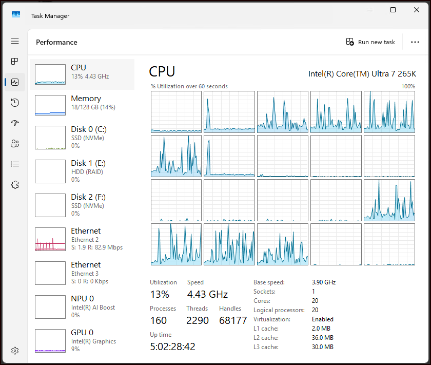

Vidmo232 2 Posted November 23, 2025 Author Posted November 23, 2025 (edited) Possibly, but the server is just barely hitting 13% utilization during the playback. Hardly stressed at all. Note: Emby is using software transcoding and not hardware as I'm also using the Intel GPU for Blue Iris. Edited November 23, 2025 by Vidmo232

Vidmo232 2 Posted November 23, 2025 Author Posted November 23, 2025 15 minutes ago, Happy2Play said: Most likely a browser issue itself as the browser player is really out of Emby's control. Is it all content or specific content? Is it only remux content? If video and audio Direct play do you see the same results? I've only got a dozen HEVC movies that I own, so its not a good sample size unfortunately. The issue occurs with every HEVC Star Wars title at the exact same time (0:59) into the movie. Top Gun: Maverick seems to be ok and it uses DirectPlay for video and transcodes the audio to MP3 just like the Star Wars movies. BUT right around the 1 minute mark it does stall for a brief second and drops a frame but then continues on from there. It seems like the titles with TrueHD 7.1 as the audio source are more problematic. Maybe I'll remove that audio channel from a test title and see if that has an effect.

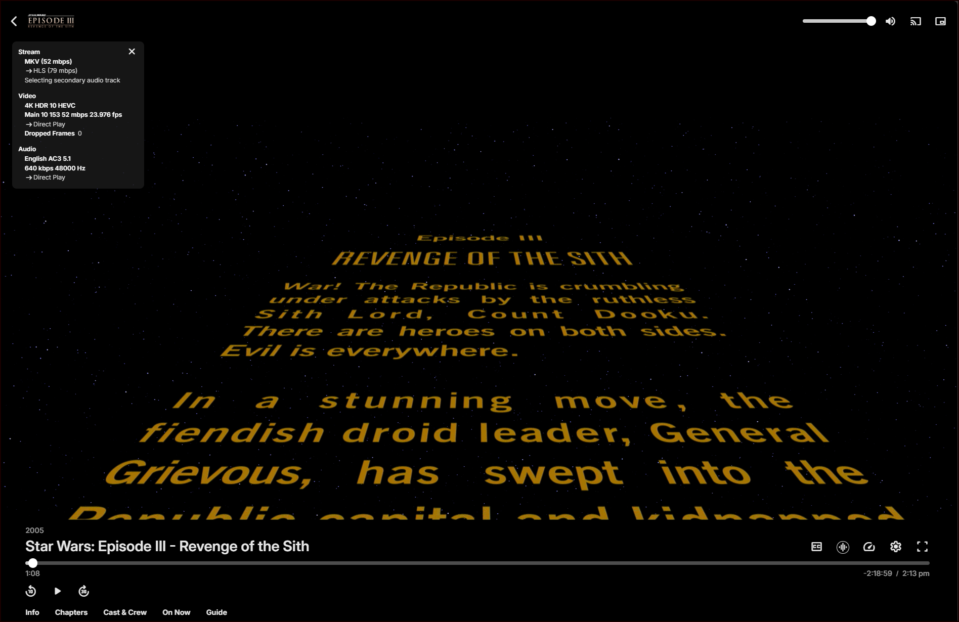

Vidmo232 2 Posted November 23, 2025 Author Posted November 23, 2025 Actually I don't need to do that, I just need to select one of the other audio tracks on the title page in Emby. So, I selected the AC3 5.1 audio track which ends up being DirectPlay in Edge and the issue disappears. No more stall. 1
