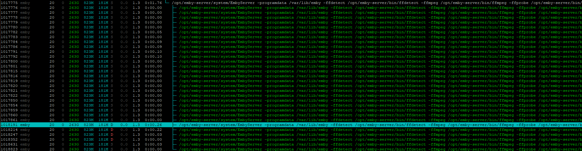

DarinM 11 Posted November 22, 2025 Posted November 22, 2025 top - 09:49:11 up 11 days, 6 min, 4 users, load average: 4.06, 3.35, 1.81 Tasks: 354 total, 1 running, 353 sleeping, 0 stopped, 0 zombie %Cpu(s): 0.1 us, 0.1 sy, 0.0 ni, 99.9 id, 0.0 wa, 0.0 hi, 0.0 si, 0.0 st MiB Mem : 63431.6 total, 8439.2 free, 2356.9 used, 53461.9 buff/cache MiB Swap: 5120.0 total, 5118.7 free, 1.2 used. 61074.7 avail Mem System is running RockyLinux 10.1. This also happened on RockyLinux 8.10. I had hoped that updating to the newer OS would resolve the issue. If someone starts playing a video and it uses DirectPlay, everything is fine. If not, the person trying to watch gets a spinner for a long time until it errors and tries a different method of playback. When that happens it appears that threads are left hanging. The extra threads stay there and the more this happens the more threads are left hanging. I've seen 30 or more threads hanging on my system. virtual logs]# ps -T -p 1001073 PID SPID TTY TIME CMD 1001073 1001073 ? 00:00:01 EmbyServer 1001073 1001074 ? 00:00:00 .NET SynchManag 1001073 1001075 ? 00:00:00 .NET EventPipe 1001073 1001076 ? 00:00:00 .NET DebugPipe 1001073 1001077 ? 00:00:00 .NET Debugger 1001073 1001078 ? 00:00:00 .NET Finalizer 1001073 1001080 ? 00:00:00 .NET Long Runni 1001073 1001081 ? 00:00:00 .NET SigHandler 1001073 1001082 ? 00:00:00 .NET Sockets 1001073 1001084 ? 00:00:00 .NET TP Gate 1001073 1001086 ? 00:00:00 Kestrel Timer 1001073 1001090 ? 00:00:00 .NET Timer 1001073 1001096 ? 00:00:00 .NET TP Worker 1001073 1001098 ? 00:00:00 .NET File Watch 1001073 1001099 ? 00:00:00 .NET File Watch 1001073 1001110 ? 00:00:00 .NET File Watch 1001073 1001116 ? 00:00:00 .NET File Watch 1001073 1001119 ? 00:00:00 .NET File Watch 1001073 1001120 ? 00:00:00 .NET File Watch 1001073 1001121 ? 00:00:00 .NET File Watch 1001073 1001122 ? 00:00:00 .NET File Watch 1001073 1001150 ? 00:00:00 .NET File Watch 1001073 1001154 ? 00:00:00 .NET File Watch 1001073 1001159 ? 00:00:00 .NET File Watch 1001073 1001160 ? 00:00:00 .NET File Watch 1001073 1001161 ? 00:00:00 .NET File Watch 1001073 1001299 ? 00:00:00 .NET TP Worker 1001073 1001375 ? 00:00:00 .NET TP Worker 1001073 1001387 ? 00:00:00 .NET TP Worker 1001073 1002226 ? 00:00:00 .NET TP Worker 1001073 1002303 ? 00:00:00 .NET TP Worker 1001073 1002480 ? 00:00:00 .NET TP Worker If you need any other data let me know. I have been trying to keep ahead of this by having cron restart Emby-server a couple of times per day. embyserver.txt ffmpeg-transcode-8ccf517a-c34b-4d83-a4e7-74a11af969ca_1.txt

DarinM 11 Posted November 22, 2025 Author Posted November 22, 2025 Hello, I disabled subtitles in the Transcode settings and made sure they were off before starting the video.. I also switched to the Android version instead of the AndroidTV version. I still get the spinner that runs forever before it finally starts. It did use DirectPlay but I still have 4 threads hanging after playing the video. According to htop those 4 threads are in uninterruptable sleep and cannot be woken up by signals. embyserver.txt ffmpeg-remux-e5fbce46-9504-4870-bf94-61d905ab9378_1.txt
Q-Droid 1011 Posted November 22, 2025 Posted November 22, 2025 What kind of storage are you using? A status of D means the process is in a blocked state waiting for an I/O operation to complete. It could be disk or network and could also explain the delays/hangs you've noticed. Nothing that you've posted so far points a server workload problem, CPU time on everything is pretty low.
DarinM 11 Posted November 22, 2025 Author Posted November 22, 2025 The storage is shared via NFS. It is on a FreeBSD 14.3 server on a gigabit network and is a RaidZ2 ZFS array. The NFS server is similar in that it has very low load. Every TV in the house is tied into the NFS server. Kodi loads videos just fine with no delay or slowness.
Q-Droid 1011 Posted November 22, 2025 Posted November 22, 2025 Processes holding a prolonged D state are a sign of a system level problem, not application level. It's a system/kernel level operation that isn't completing fast enough. And since you're using NFS then client mount and server options along with the network would be good places to start looking into why they're hanging. Are the media files the only stuff on NFS and the rest of the config and data for Emby are local?
