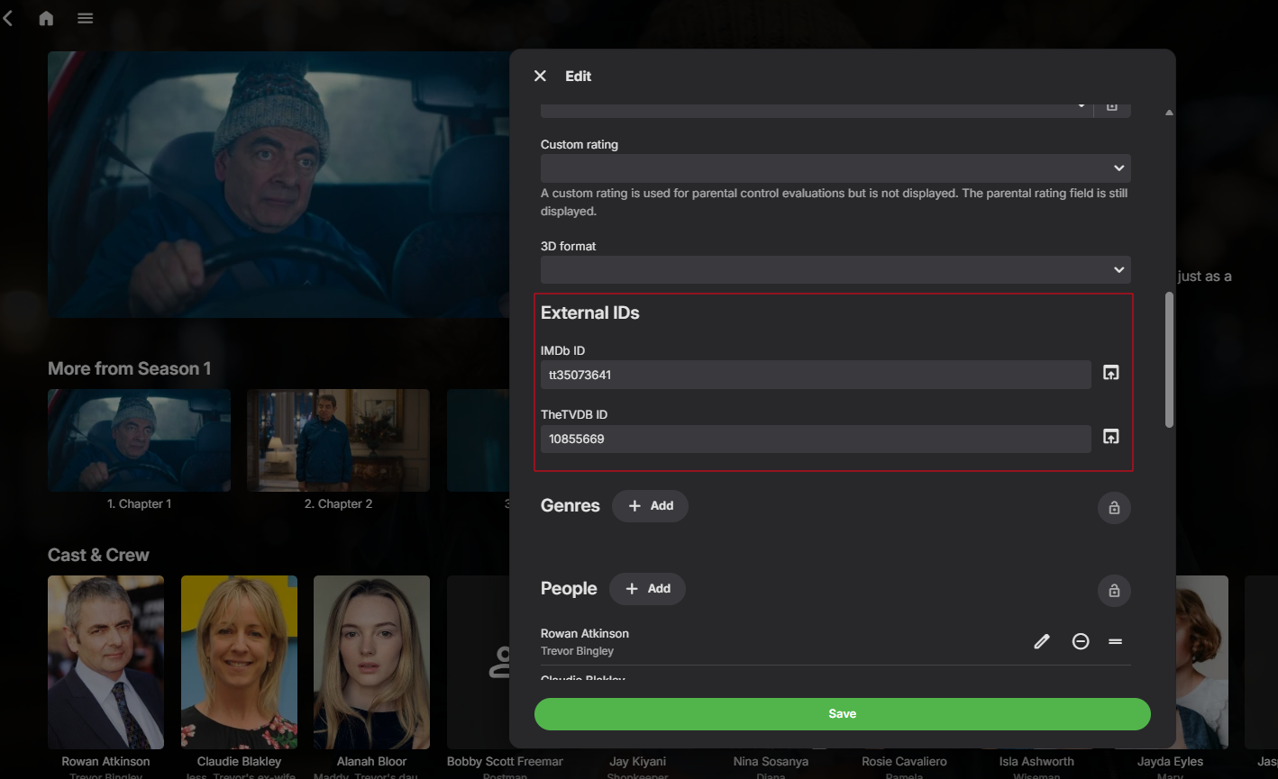

Neminem 1625 Posted December 18, 2025 Posted December 18, 2025 Hmm just wondering if tmdb id is the right one to use. Looking at episode level metadata I don't see tmdb id. It might be me misunderstanding this 2
yocker 1423 Posted December 18, 2025 Author Posted December 18, 2025 (edited) 2 hours ago, Neminem said: Hmm just wondering if tmdb id is the right one to use. Looking at episode level metadata I don't see tmdb id. It might be me misunderstanding this No, but the TVDB is there which is what i absolutely, 100% sure and of cause meant. Good catch! Edited December 18, 2025 by yocker 1
rbjtech 5345 Posted December 18, 2025 Posted December 18, 2025 5 hours ago, Neminem said: Hmm just wondering if tmdb id is the right one to use. Looking at episode level metadata I don't see tmdb id. It might be me misunderstanding this Yep sorry you are right - tvdb or imdb have episode id's, tmdb doesn't have episode level. 1

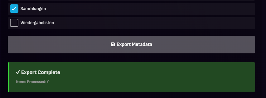

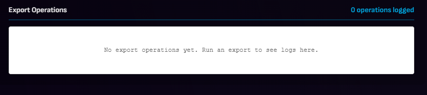

sh0rty 728 Posted December 18, 2025 Posted December 18, 2025 @yockerAs always: Very handy and useful plugin! Exported my whole library to another folder sucessfully, but it seems the does not backup my collections. There is no hint inside Emby logs and the Export log is always empty, even after I exported the whole library. Using 1.0.4.0 with Emby 4.9.1.90 on Windows 11.
yocker 1423 Posted December 18, 2025 Author Posted December 18, 2025 (edited) 24 minutes ago, sh0rty said: @yockerAs always: Very handy and useful plugin! Exported my whole library to another folder sucessfully, but it seems the does not backup my collections. There is no hint inside Emby logs and the Export log is always empty, even after I exported the whole library. Using 1.0.4.0 with Emby 4.9.1.90 on Windows 11. Collections are not a real libraries as it's Emby that have made collections from the files already there. So in effect the NFO files should correctly be there for the collections already after a backup. Unless of cause i have misunderstood you. Never the less i can try and look into maybe making some kind of collection backup if you want. Edit: And i should maybe remove the collections library from the list also. Edited December 18, 2025 by yocker
sh0rty 728 Posted December 18, 2025 Posted December 18, 2025 1 minute ago, yocker said: Collections are not a real libraries as it's Emby that have made collections from the files already there. So in effect the NFO files should correctly be there for the collections already after a backup. Unless of cause i have misunderstood you. Never the less i can try and look into maybe making some kind of collection backup if you want. For me the plugin does backup nothing from the collection, not even NFOs. TV and Movies work perfectly though. If I backup collections to folder, nothing is exported. If the plugin could backup collections images also in the future, that would be really nice, but no rush on that one....
yocker 1423 Posted December 18, 2025 Author Posted December 18, 2025 Just now, sh0rty said: For me the plugin does backup nothing from the collection, not even NFOs. TV and Movies work perfectly though. If I backup collections to folder, nothing is exported. If the plugin could backup collections images also in the future, that would be really nice, but no rush on that one.... Really sorry if i'm thick and misunderstand you. The reason is that there are no physical files in the collections library for the plugin to work with, collections are a "made up" library made by Emby to make boxsets. The option to choose the collections library is an oversight on my part and should really be removed. I could make it so that the plugin scans collections and checks the physical location of the files but it would just overwrite what is already there. It's a bit redundant though. If you have any suggestions for collections please share them so we can get something worked out!

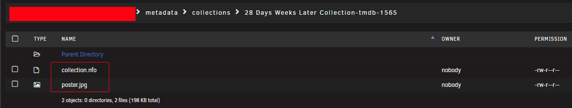

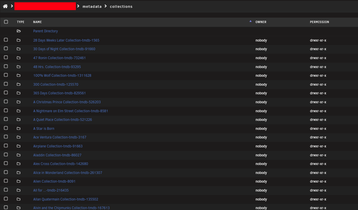

Neminem 1625 Posted December 18, 2025 Posted December 18, 2025 Hmm wondering if it's this path @sh0rtyis looking at. 1
sh0rty 728 Posted December 18, 2025 Posted December 18, 2025 (edited) 16 minutes ago, yocker said: Really sorry if i'm thick and misunderstand you. The reason is that there are no physical files in the collections library for the plugin to work with, collections are a "made up" library made by Emby to make boxsets. The option to choose the collections library is an oversight on my part and should really be removed. I could make it so that the plugin scans collections and checks the physical location of the files but it would just overwrite what is already there. It's a bit redundant though. If you have any suggestions for collections please share them so we can get something worked out! Ah ok, now I understand. I did use the plugin to extract the files to a custom folder solely. It would be nice if the plugin could export the collection folders from /metadata/collections to the custom folder as a backup for the collection poster.jpg and collection.nfo, but just for collections still in Emby because it seems old collections not present in Emby anymore are still in that folder. That's what I mean. Is this possible at all? Also, a scheduled task would be nice to backup everything to an external export folder regularly for the cases when e.g. the Arrs upgrade an item and delete the artwork (sic!) or if Emby loses a collection image, which is not uncommon atm... @NeminemYes Sir! I hope this is the actual one that's used by Emby Edited December 18, 2025 by sh0rty 1 1

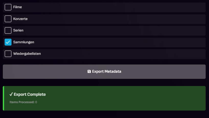

sh0rty 728 Posted December 26, 2025 Posted December 26, 2025 @yockerYes exporting individual items works, did not try that. But the "Export entire libraries" option seems not to work with collections, is this a technical limitation?
yocker 1423 Posted December 26, 2025 Author Posted December 26, 2025 1 hour ago, sh0rty said: @yockerYes exporting individual items works, did not try that. But the "Export entire libraries" option seems not to work with collections, is this a technical limitation? Will be honest i never thought of actually testing that as i was just focused on the collections plus i have been busy, sorry about that. Looking into it now with top priority!
