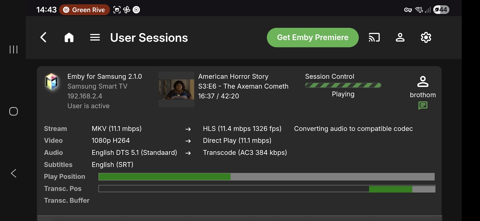

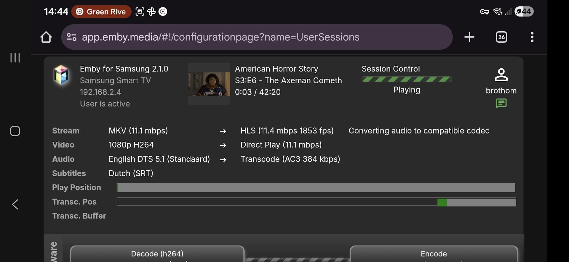

brothom 210 Posted November 22, 2025 Author Posted November 22, 2025 19 hours ago, Luke said: Okay, sure. That would make sense if the file also didn't work with English subs, but it does. Only when "switching" the subtitles to anything other than English causes this issue. For reference, enabling transcoding does nothing to resolve this issue. Playing the file with DTS 5.1 + en.srt works Playing the file with DTS 5.1 + nl.srt does not work These should be logs for all sessions. Following @pwhodgesadvice I also installed the Diagnostics Plugin and both sessions don't seem weird: Any other clues? ffmpeg-remux-d197f564-81f3-448b-a56c-bac955ca3495_1.txt ffmpeg-remux-77ba0995-cabd-4956-b302-07f7f1483627_1.txtffmpeg-remux-9eac3180-22f5-4e54-a41e-77d40c144fc0_1.txtffmpeg-remux-2a4cb7d0-b9f3-45b1-b34b-deb318ba7b4c_1.txt
brothom 210 Posted November 24, 2025 Author Posted November 24, 2025 I've tested this same episode on Google Chrome and eventhough switching to "other" subtitles also takes a little while, at least the browser manages to be able to play the episode eventually. So far this issue seems to be local to the Samsung app. Will test on Chromecast to see if that also crashes later.
