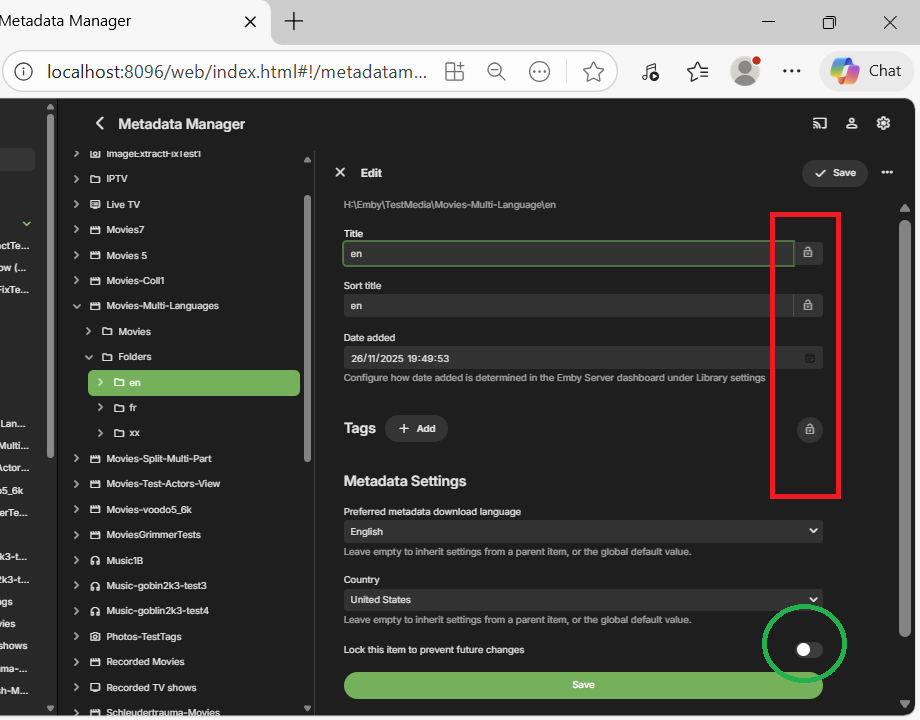

HediSIX 51 Posted November 26, 2025 Author Posted November 26, 2025 In the metadata manager, it's the screenshots I have put with the black background

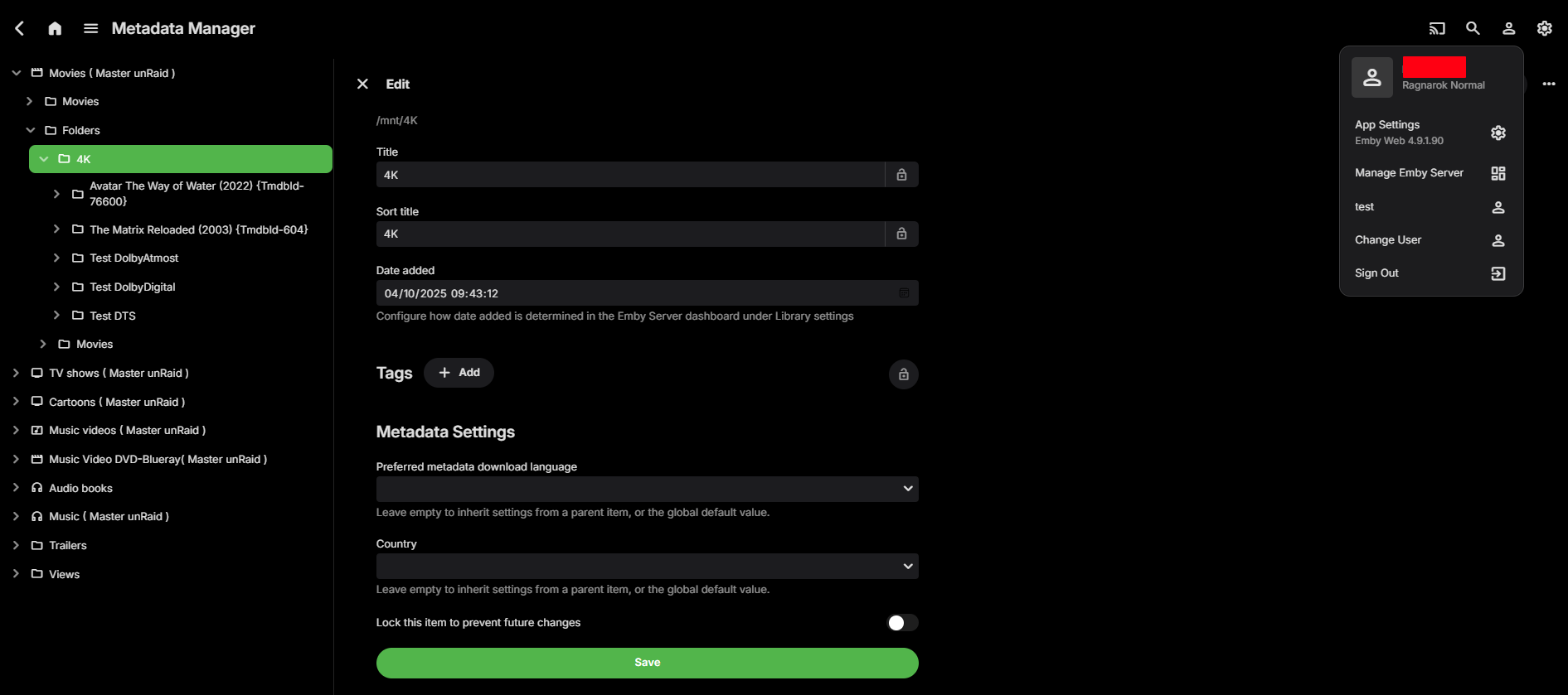

Neminem 1623 Posted November 26, 2025 Posted November 26, 2025 @sa2000we can do that via metadata manager in the Android App. When you have more than 1 folder. I also see this in Beta release. I see this in stabel also. Not sure if this is intended as it's different from Library setup Where we have settings for all folders. 1
Solution sa2000 697 Posted November 26, 2025 Solution Posted November 26, 2025 5 hours ago, HediSIX said: In the metadata manager, it's the screenshots I have put with the black background Can you try again but first using Metadata Manager to edit the folder setting for en or fr to remove the lock and see if that resolves the issue. In my tests replicating your library setup, I had fr and en locked like you did and xx not locked as in your example.I put a movie in each and the one in the xx folder fetched metadata and the ones in the locked folders did not

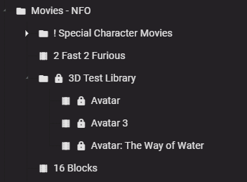

Happy2Play 9811 Posted November 26, 2025 Posted November 26, 2025 (edited) 36 minutes ago, sa2000 said: i was not aware that we had metadata options at folder level - let alone if it can be locked or not ! Yes, it is one of those options that makes troubleshooting a nightmare sometimes as everything within the folder inherits the LOCK. It was nice back when Metadata Manager showed the lock per folder/item. Now you have to navigate the levels to see if locked or not. There are a couple topics on Tagging folder level to make access restriction a little easier also ie tagging one folder to block all the items instead of every item. Edited November 26, 2025 by Happy2Play 1

Happy2Play 9811 Posted November 27, 2025 Posted November 27, 2025 11 minutes ago, sa2000 said: if that is the case, then we cannot just remove the items locks when the parent lock is removed. Toggling lock on and off inherits to all children, but you can toggle children off per item if needed. Note adding any new items to a locked parent folder will automatically lock the child on import so no metadata is gotten.
sa2000 697 Posted November 27, 2025 Posted November 27, 2025 (edited) 10 minutes ago, Happy2Play said: Toggling lock on and off inherits to all children, but you can toggle children off per item if needed. I had lock on folder "en" in the movie library. The movie below the folder showed locks present on fields when editing metadata I then edited metadata for the folder to remove the lock on folder "en" and saved. The movie below the folder remains showing the locks on the fields when editing metadata - so it did not inherit the unlocking of the parent. Edited November 27, 2025 by sa2000
Happy2Play 9811 Posted November 27, 2025 Posted November 27, 2025 1 minute ago, sa2000 said: I had lock on folder "en" in the movie library. The movie below the folder showed locks present on fields when editing metadata I then edited metadata for the folder to remove the lock on folder "en" and saved. The movie below the folder remains showing the locks on the fields when editing metadata - so it did not inherit the unlocking of the parent. No idea why you would see different as I tested on release and beta and don't see that behavior, as toggling parent folder on and off applies to all children in my tests.

Happy2Play 9811 Posted November 27, 2025 Posted November 27, 2025 (edited) 3 minutes ago, sa2000 said: I see that the parent folder still has locks showing for fields even though i toggled the locked option at the bottom and saved the change No those are individual field locks and they are unlocked per no color and lock is open but hard to see. Locked field Independent of full metadata lock at bottom. Edited November 27, 2025 by Happy2Play 1
Happy2Play 9811 Posted November 27, 2025 Posted November 27, 2025 You have to remember lockdata is all data while lockedfields are only specific fields. <lockdata>true</lockdata> <lockedfields>Name</lockedfields> lockedfields are not inherited.
