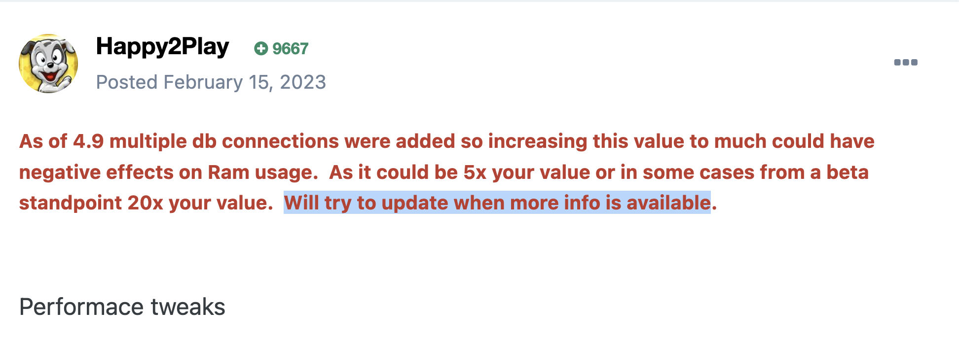

Happy2Play 9811 Posted November 20, 2025 Posted November 20, 2025 1 hour ago, blackcatTN said: I can make the server stay up longer if I disable and avoid emby's library updates and let the "darrs" update emby on new media. I suspect running update libraries might be causing memory leak. embyserver-63899193600.txt 15.7 MB · 0 downloads ffmpeg-transcode-09e675b7-0e88-4cc4-b5f0-3575523aadb9_1.txt 1.56 MB · 0 downloads ffmpeg-transcode-c988a4a3-97bf-48a8-b7e4-92866f84c8f4_1.txt 216.15 kB · 0 downloads ffmpeg-transcode-a13bb67e-54ab-49d5-9511-84061c14129d_1.txt 433.51 kB · 0 downloads embyserver-63899202587.txt 4.39 MB · 0 downloads ffmpeg-transcode-9e67fadf-d40f-48a2-a1e0-8f25fa22cc99_1.txt 84.99 kB · 0 downloads ffmpeg-transcode-3a7d66e5-9e7b-47cf-a87e-70abee1b6bfa_1.txt 15.51 kB · 0 downloads ffmpeg-transcode-080e4ec5-436a-4009-889d-eabcde64f486_1.txt 11.88 kB · 0 downloads embyserver2.txt 80.52 kB · 0 downloads I would first test reseting cache size as Emby changed to a multiconnection model. So the previous method of 1.5 to 2 times db size is obsolete. 2025-11-20 02:29:51.449 Info SqliteItemRepository: Initializing PooledDatabaseConnectionManager with pool size: 5 So it could be 5 x your cache size (cache_size=-3121152) Default is currently 128.
blackcatTN 3 Posted November 21, 2025 Posted November 21, 2025 Thank you. I set it to 256 but can't restart until off peak. Will monitor for the next couple of days and report back. Looking forward to seeing what the dev team officially endorses for optimal settings. Does it ever need to be changed now or not so much? That would be useful info to share.

Dan_86 5 Posted November 21, 2025 Posted November 21, 2025 (edited) I've noticed the same thing but I've gotten around it by scanning at 3am and 3pm. I have my config to automatically reboot the instance at 6 am and then I hit a manual reboot before peak hours start around 4:30 pm daily (after the 3 pm scan) This has kept things stable for myself and my users. Currently running 128mb cache, 800 row. Real time monitoring off for all libraries. I vacuum database once a week and do not scan intros. I only do Emby backups manually. Edited November 21, 2025 by Dan_86
