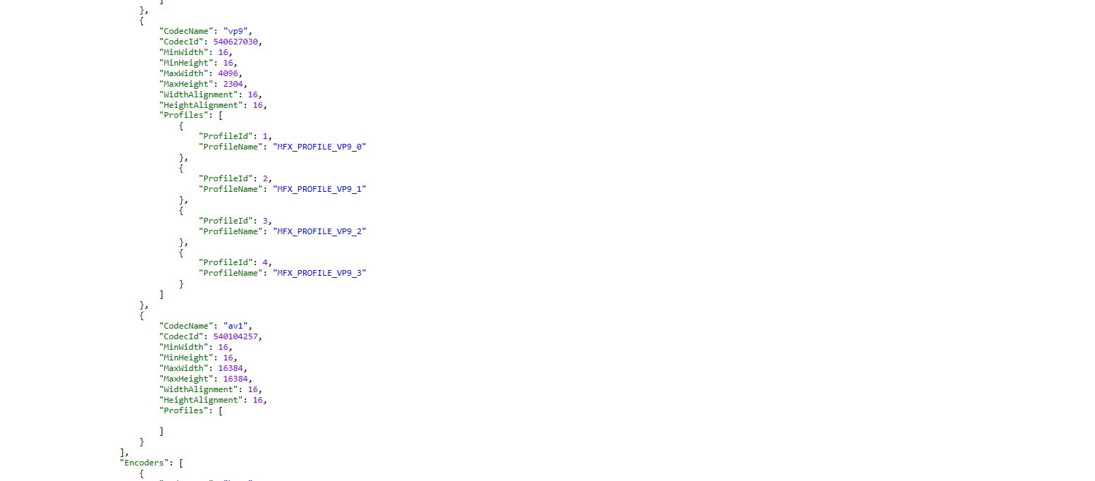

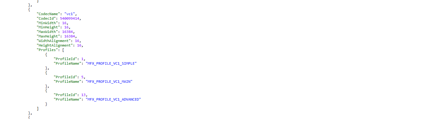

softworkz 5135 Posted December 1, 2025 Posted December 1, 2025 Thanks for the log! The detection is actually getting correct results. In your case, it doesn't show any profiles for VC-1: This is from another user (Alder Lake) which shows it's supported: So, it's not that it has been dropped in the drivers, it's just not implemented for your GPU. Still, the fault is on our side: Will need to investigate why its still being shown as supported in your case.

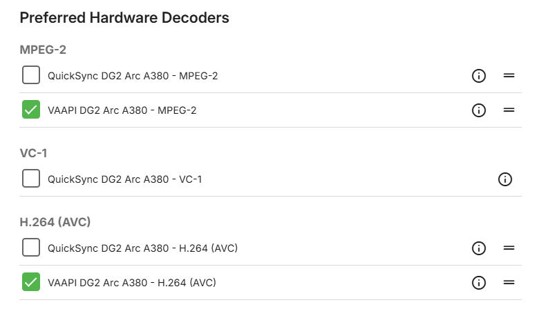

Brian_Oblivion 4 Posted December 1, 2025 Author Posted December 1, 2025 (edited) Hmmm... If it matters, this is running in a docker container with a Intel CPU - thus there's an onboard GPU in the CPU in addition to the A380 card I have in it. This is what my config screen looks like, all of them are the same except the odd duck of the VC-1. Not entirely sure why they are "duplicated" other than the VAAPI driver is excluding VC-1 (as it should since it's no longer supported). Edited December 1, 2025 by Brian_Oblivion

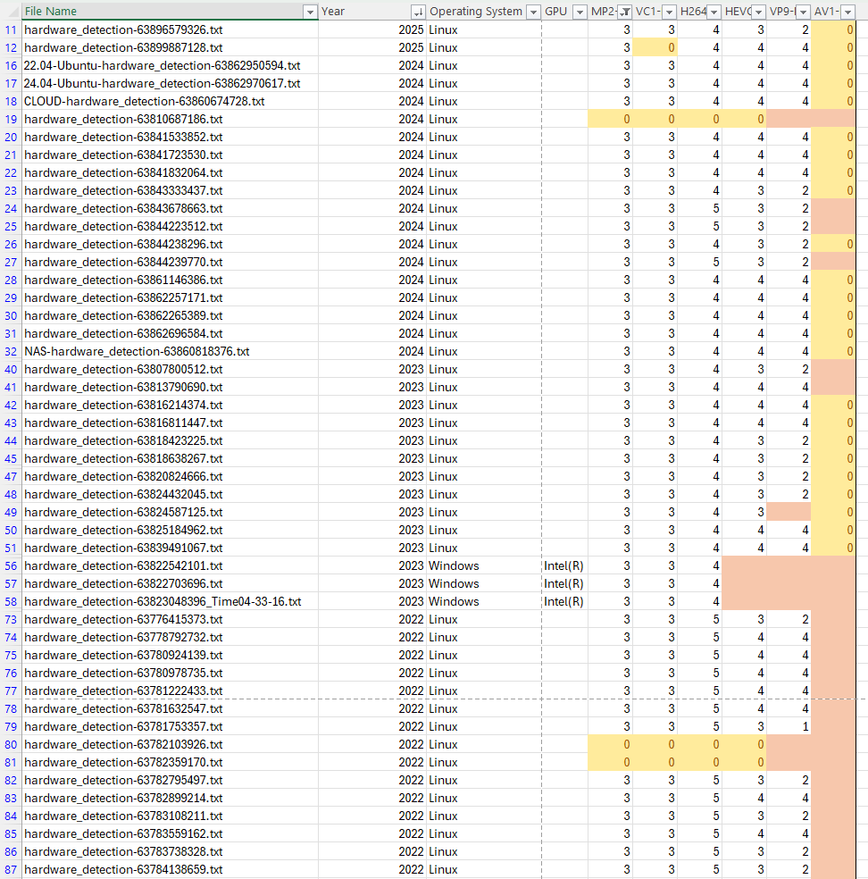

softworkz 5135 Posted December 2, 2025 Posted December 2, 2025 Sorry, I've been mistaken - it's been a few years since it was implemented. So, no profiles being shown does NOT mean that the codec is unsupported. When a codec is unsupported then it isn't shown at all. An analysis of detection logs which were sent by users during the past few years, shown that it happens quite often that the profiles are not present, even though the codec is supported: This aligns with the implementation we have in the server: it doesn't sort out based on missing profiles, just on whether an entry exists or not. Over all the years, I don't remember a single case where the hardware detection was wrong - this would be the very first case. It's possible for sure, because it's a combination of "rarely use GPU" and "rarely used codec" - which multiplies down to "extremely rare". But I'm curious how it fails exactly. Can you post an ffmpeg log from a failed transcoding with VC-1? Thanks
