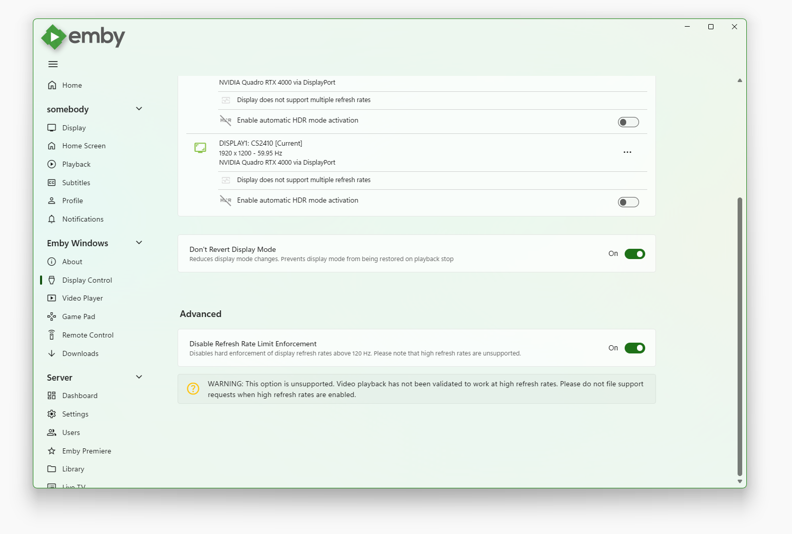

Hi,
When opening my windows app my refresh rates gets change to 60Hz on the screen it is on, and changes the secondary screen to 120 hz. I would like it to just keep the same hz settings on both monitors when the app is opened.
Thanks!
  • Solution
When you see a refresh rate change on app startup, then it's not the Emby app doing it and it must be some other tool or setting.
If you mean that it happens when a video playback is started, then yes, the app is doing that because high refresh rates (above 120 Hz) are not supported.
If you still believe that it's a good idea to play video at high refresh rates, you can disable this behavior here:
You were right, it was when I played video. But that setting did the trick. Thanks for the reply!
