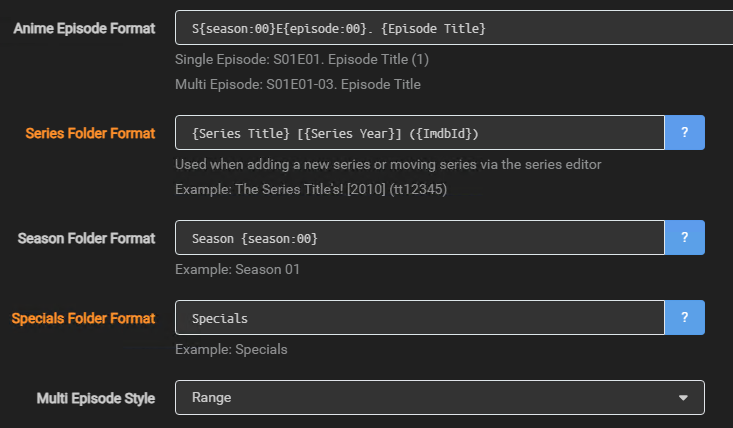

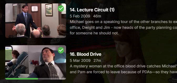

Jippett0 2 Posted November 18, 2025 Posted November 18, 2025 Morning! Apologies for the (probably) duplicate post, but I can't seem to find the exact same issue (although admittedly, there are similar). I have a few instances of single files, containing multiple episodes, seemingly not showing correctly in Emby? I have shown an example below. Multi Episode Naming Convention File Shown In Folder Episode 15 Missing What Emby Sees This isn't the only example of this, and I'm obviously doing something wrong, but can't figure it out. Appreciate any assistance. Thank you

Solution GrimReaper 4926 Posted November 18, 2025 Solution Posted November 18, 2025 8 minutes ago, Jippett0 said: Morning! Apologies for the (probably) duplicate post, but I can't seem to find the exact same issue (although admittedly, there are similar). I have a few instances of single files, containing multiple episodes, seemingly not showing correctly in Emby? I have shown an example below. Multi Episode Naming Convention File Shown In Folder Episode 15 Missing What Emby Sees This isn't the only example of this, and I'm obviously doing something wrong, but can't figure it out. Appreciate any assistance. Thank you You actually shouldn't be seeing E15 as a separate entry anyway - but what you should be seeing is E14 as "14-15. Lecture Circuit (1), Lecture Circuit (2)". Your naming scheme doesn't appear to be one of the supported naming conventions for multi-episode files, try renaming that file (and *arr pattern) to: S01E14-E15, scan media library. 1
Jippett0 2 Posted November 18, 2025 Author Posted November 18, 2025 4 minutes ago, GrimReaper said: You actually shouldn't be seeing E15 as a separate entry anyway - but what you should be seeing is E14 as "14-15. Lecture Circuit (1), Lecture Circuit (2)". Your naming scheme doesn't appear to be one of the supported naming conventions for multi-episode files, try renaming that file (and *arr pattern) to: S01E14-E15, scan media library. Yes, that's exactly what the issue was. Couldn't see the wood for the trees. Appreciate the assist. 1 1
