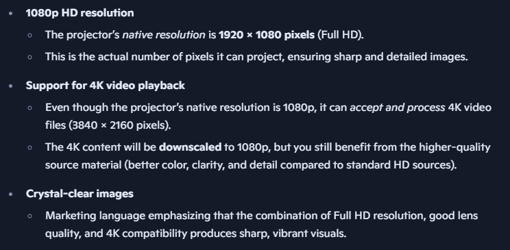

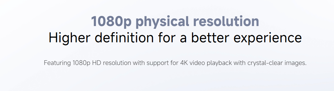

Happy2Play 9812 Posted November 18, 2025 Posted November 18, 2025 (edited) 3 hours ago, ebr said: Hi. That appears to be the case from my reading of this as well. Where does it say it supports 4K? Not sure what this is suppose to mean show on the overview of device link in post 1 as that is the only mention of 4K I see in the entire overview/specs. But would appear Emby is doing the right thing transcoding/trying. Can only guess this may be a what the others are doing as Grim mentioned. As blocking transcoding shows the device itself does not support the media. So AI told me this. So it can downscale but at the same time you still have a HDR/DV issue. Edited November 18, 2025 by Happy2Play
Luke 42243 Posted November 18, 2025 Posted November 18, 2025 22 hours ago, izzy198888 said: The projector is 1080p, but it supports playing 4k videos. Right but that doesn't mean all 4K, right? There's going to be limits of what it can handle, e.g. hevc profiles, DV profiles, etc.
